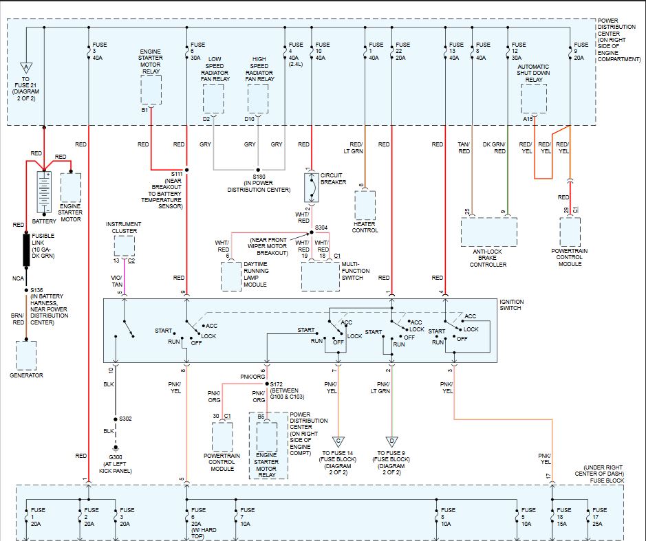

DTC P0688 & transmission control shut down occurred while driving jeep, no crank in neutral while coasting, parked,no crank in neutral or park. Ignition switch shows hot at wire from start position, starter can be cranked by jumping solenoid, asd relay, starter relay fuel relay and all fuses good, continuity from ECM harness to asd relay good. Recently transmission temperature light had come on,then check engine light,but both had gone off shortly after. Vehicle had a rough kick shift from first to second gear.what do you think ? Computer ?

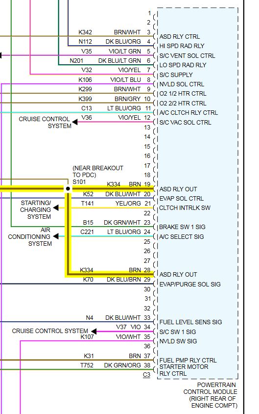

Check for power at Pins 19 and 28 (connector 3) while the ASD relay is energized.
SYMPTOM
P0688-ASD RELAY SENSE CIRCUIT LOW
WHEN MONITORED
With ignition key on. Battery voltage greater than 10 volts.
SET CONDITION
No voltage sensed at the PCM when the ASD relay is energized for 3.075 seconds. Three good trips to clear the MIL.
POSSIBLE CAUSES
- Verify ASD DTC
- ASD relay
- (A209) Fused B+ circuits
- (K334) ASD relay output circuit open (NO START)
- (K334) ASD relay output circuit shorted to ground
- (K334) ASD relay output circuit open (START)
- PCM

C3 (black natural) pin 19 is empty, no pin. 28 has connection pin

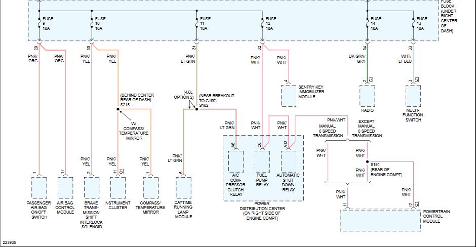

7 years 7 months ago - 7 years 7 months ago #28236 by Chad
If the engine does not start, the ASD relay will deactivate in 1.8 seconds. So, make sure to do the test while cranking, or within that amount of time after turning the key on.
Verify Fuse 9 is good and that the relay is activating. Do you have power at the injectors and coil? A test light, connected to Battery Positive can be used to check for ASD Relay Control from the PCM.
Copy and paste:
AUTO SHUT DOWN RELAY
DESCRIPTION - PCM OUTPUT
The 5 pin, 12-volt, Automatic Shutdown (ASD). relay is located in the Power Distribution Center(PDC).
OPERATION
ASD SENSE - PCM INPUT
A 12 volt signal at this input indicates to the PCM that the ASD has been activated. The relay is used to connect the oxygen sensor heater element, ignition coil and fuel injectors to 12 volt + power supply.
This input is used only to sense that the ASD relay is energized. If the Powertrain Control Module (PCM.) does not see 12 volts at this input when the ASD should be activated, it will set a Diagnostic Trouble Code (DTC).
PCM OUTPUT
The ASD relay supplies battery voltage (12+ volts.) to the fuel injectors and ignition coil(s). With certain emissions packages it also supplies 12-volts to the oxygen sensor heating elements.
The ground circuit for the coil within the ASD relay is controlled by the Powertrain Control Module (PCM). The PCM operates the ASD relay by switching its ground circuit on and off.
The ASD relay will be shut down, meaning the 12 volt power supply to the ASD relay will be de-activated by the PCM if:
- the ignition key is left in the ON position. This is if the engine has not been running for approximately 1.8 seconds.
- there is a crankshaft position sensor signal to the PCM that is lower than pre-determined values.
Last edit: 7 years 7 months ago by Chad.

No ground in asd relay ( terminal 85 coil grnd in PDC), test light connect to positive terminal. ) with key in crank and run position, no signal to starter relay, fuel pump relay.

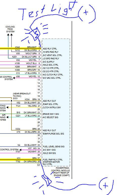

7 years 7 months ago #28242 by Chad
It's not looking good for the PCM.
Next, I would verify the lack of ASD and Fuel pump control at the PCM connector 3, by back-probing Pins 3 and 37, when the key is turned on. (Using a test light connected to Battery +)
After that, the only thing left to check is PCM Powers and Grounds.

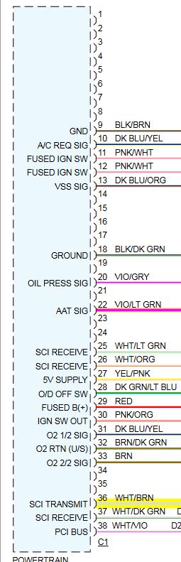

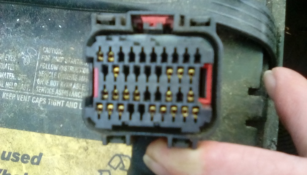

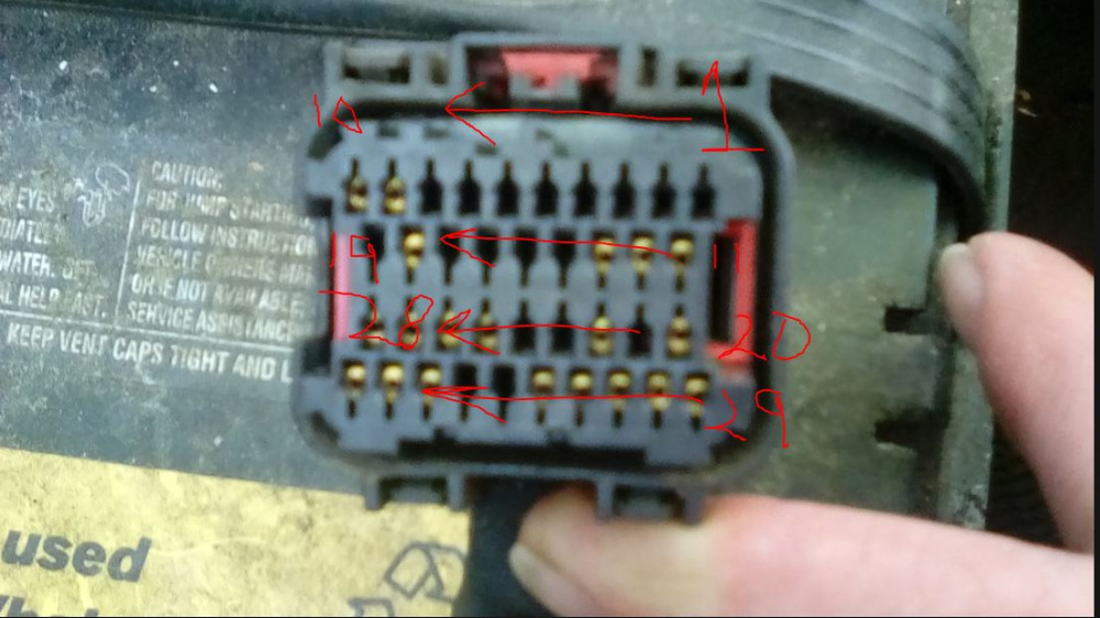

I have a problem as the C3 harness does not match the one posted here,neither does it match the harness in the 2006 jeep wrangler work shop manual. Vehicle is original condition
7 years 7 months ago #28251 by Chad
Is this the 4.0L? Or, the 2.4L?
  • Paulpurdue
  • Paulpurdue's Avatar Topic Author
7 years 7 months ago #28252 by Paulpurdue
7 years 7 months ago #28254 by Chad
I think your picture is of Connector 1.
  • Paulpurdue
7 years 7 months ago #28266 by Paulpurdue
Yup Thad be rite ! Was on phone with brother in law, said that harness was black/ natural, since when is white called natural, i wasted a lot of time, but i learned how's to test electrical problems , still have a lot to learn. Will test the real C3 thanks.

Repeated testing on pin 19 & 28 ( test light B neg.) No light signal. Test ( test light B pos.) on pin 3 & 37 back probe, no light signal. Starter relay has light signal in crank position on terminal 85, and asd relay no light signal in crank position ( test light connected to B-).
7 years 7 months ago #28320 by Chad
Just to be clear, you did the testing by back-probing the connector while it was CONNECTED to the PCM, correct?
If so, verify that you have good powers and grounds to the PCM. Then, I would feel comfortable calling it a bad PCM.

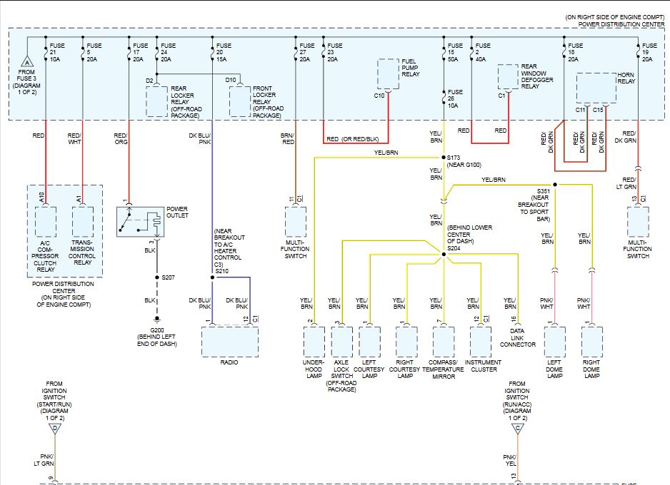

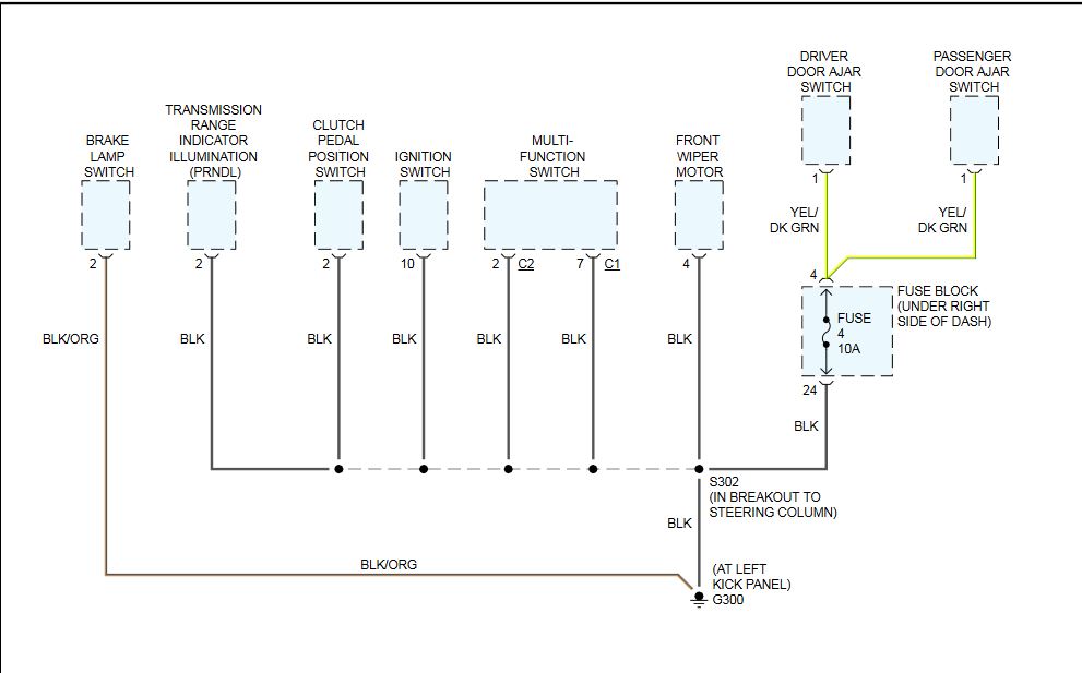

Thank you for all your help you have given me, I hope to be able to help others just as you have helped me in the future. I installed a computer and the jeep started up and seems to run good ( no crank situation solved )but none of the gauges are working ? No power to fuses 4 (10amp ground) and15 (10amp) these fuses and all other fuses are good.
Last edit: 7 years 7 months ago by Paulpurdue.
7 years 7 months ago #28334 by Chad
You're welcome. I'm happy to help. :)
7 years 7 months ago - 7 years 7 months ago #28335 by Chad
As you stated, Fuse 4 is on a ground. There should be no power there.
