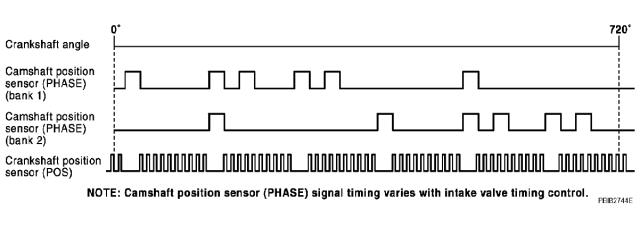

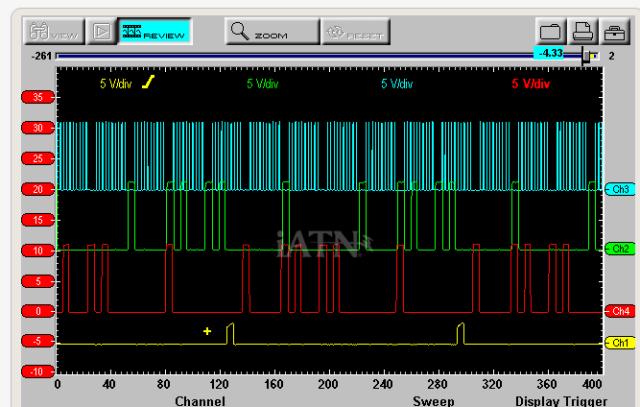

The scope pattern picture with both cmp signals and ck p signal shows some irregularities, same goes for the video:
blue cmp trace goes from negative 4 volts to negative 9 volts, green cmp goes from pos 4 volts to neg 4volts and ckp trace shows pos 4 volt transitions.
They all should show 0 to pos 12 volt transitions. Make sure you are connected to the correct wires and that the signals get to the ecm.
A mayor clue seems to be that when the crank signal is present -as well in the picture as in the video - this actually does not look like the legit crank signal. It is a miiror image of a cam signal, the correct crank signal is quiet different!
I'll attach the signal examples from the SFM and a known good pattern.
Once again, have a close look at the involved wires, their continuities from sensors to the ecm, check for shorts between signals wires themselfes, shorts between signal wires and 12 volt power feeds and so on.
