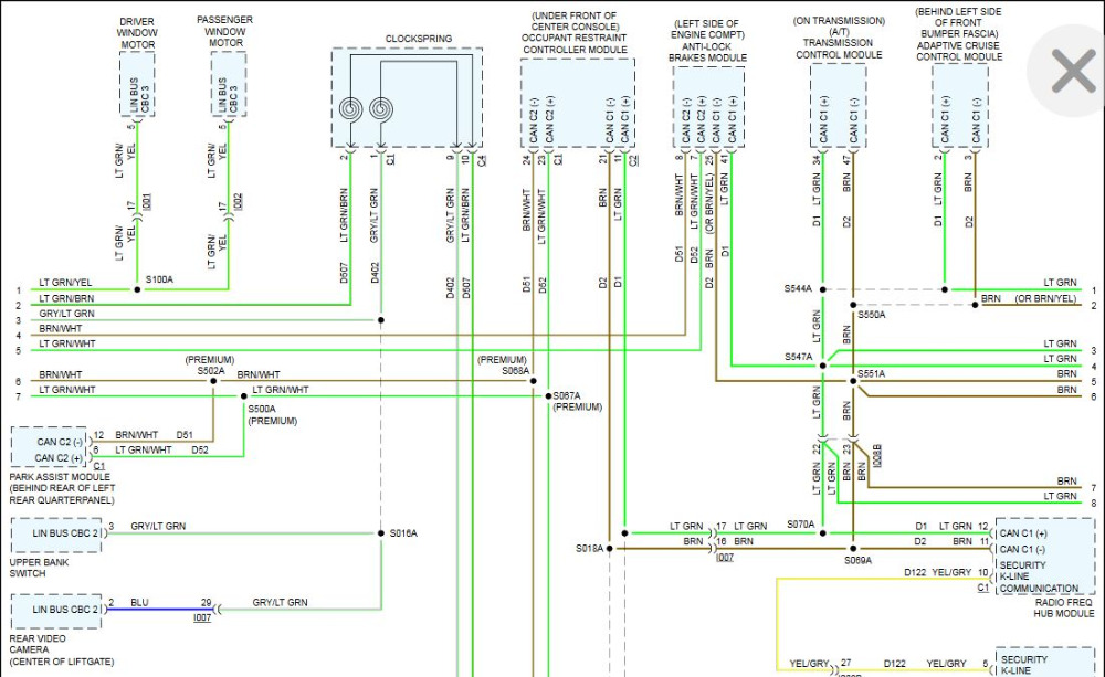

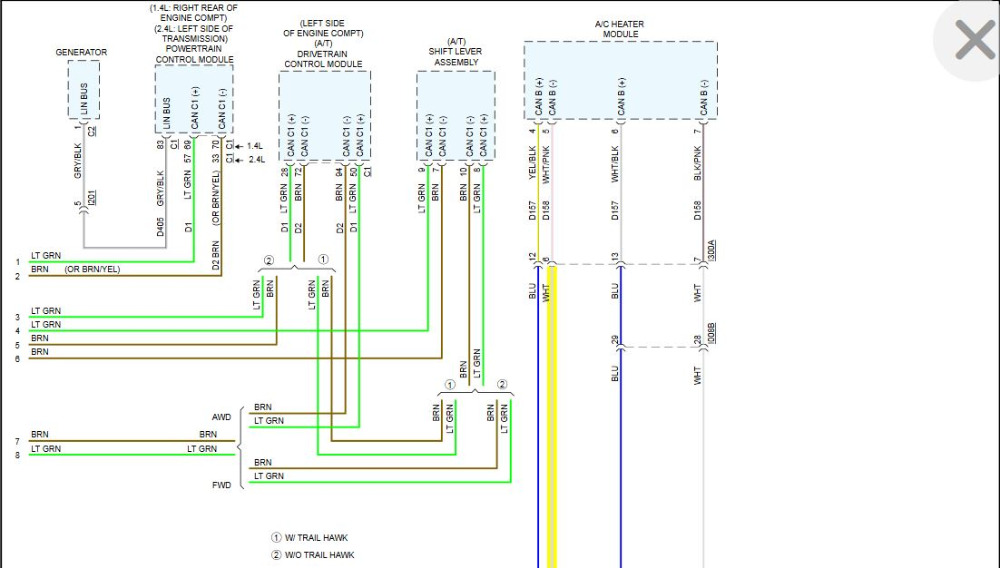

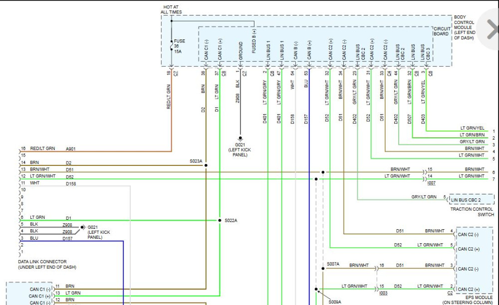

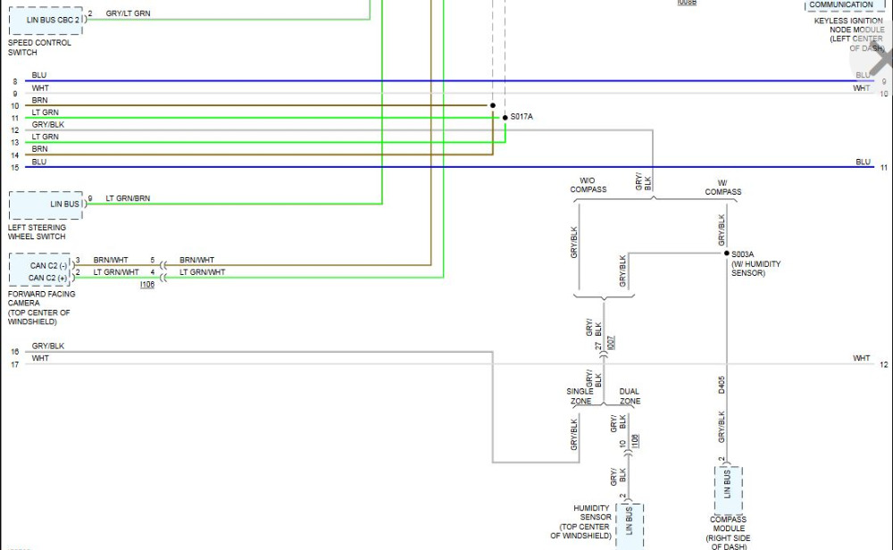

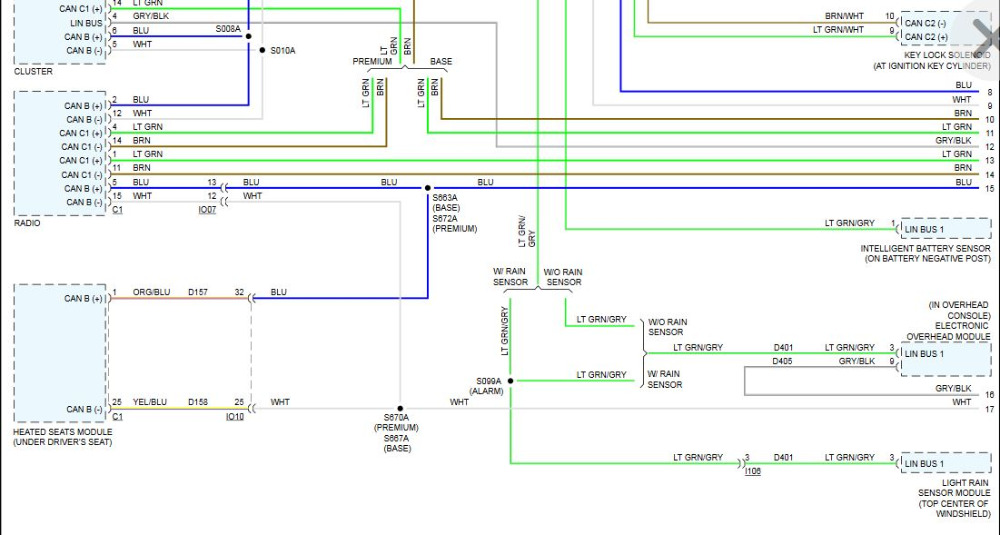

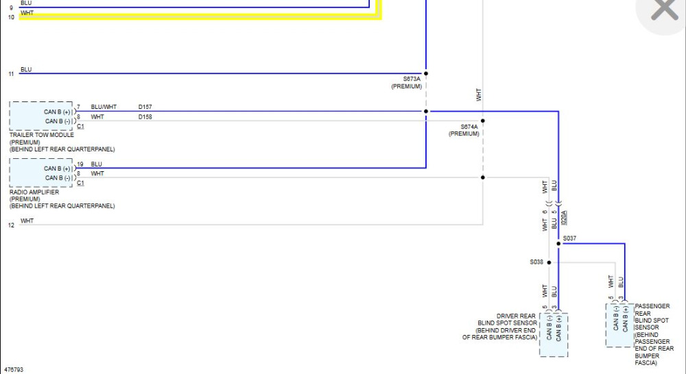

I am trying to find info on the bus systems and or modules present in a '16 Jeep Renegade trailhawk with the 2.4 engine.
I would like to see if my Ethos Tech can access all modules, and I'm also just wanting to learn about the car's tech. (yep, I'm a nerd)
I can find this info for our other car, but not the newer Renegade. (found a full workshop manual for free for a Nissan!) What I'm looking for is a diagram that shows the modules, and what bus they are on, as well as how it all connects. or if that's not available, a list of the modules would work.
Really surprised that after posting this on 4 Jeep forums I get no replies. This car is supposedly similar to the Fiat 500X, its also the first Jeep made in Italy, so a diagram for a 500X might be similar?
Someone surely has access to this info, I would be grateful for any help.

Thank you! That's what I needed! Surprised how the architecture differs from the pre FCA cars the diagrams I was finding were for. Looks like my tool does access all modules.
