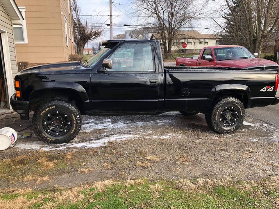

Picture of said truck causing all the heartache
