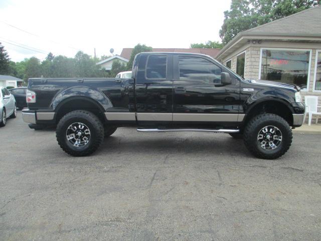

9 years 11 months ago - 9 years 11 months ago #3668 by garypuppet1
I have a 2006 Ford F-150 XLT 4X4 5.4L 3V TRITON with 128152 miles. It had a misfire under sever load. I ran an Actron diagnostic tool on it and it diagnosed cylinder 8 misfire P0308. I decided because of its miles it was time for a tune up. I replaced all 8 spark plugs with motorcraft plugs and all 8 coils with some cheap amazon coils. Afterwards I started the engine and had multiple missfires P0303, P0304, P0305, P0307, P0308. I assumed after testing the voltage going to each coil and to each injector that maybe I purchased bad coils and plugs, so I replaced all 8 coils this time Accell coils and Motorcraft platnum plugs. still had a multiple misfires at an idles and when driven it seemed as if it was only firing on four cylinders. My freind connected his Verus up to the truck and told me that No. 8 and 4 was misfiring. I replaced No.4 and No. 8 connectors and injectors and swapped the coils around to coils I knew was firing correctly, Still No. 8 misfire. I replaced both VCT "Variable Cam Timing" Solenoids both CPS "Cam Positioning Sensors", fuel filter added Seafoam to the fuel. I flushed the motor which the oil was not gunked up. The valves on top of the head looked clean when i removed the grommets that go around the VCT's. I ran Seafoam direct spray injector cleaner for five plus minutes and shut the vehicle off to let it bake. Drove it down the road and still no change in No. 8. When the key is on the on position my amp meter shows 12.4 amps on both wires of the coil on plug on cylinder 8 when running it shows 14.4 amps. what are your suggestions? I replaced the PCM with a new one with all the updates, and the problem still exists. I did however have other codes for primary and secondary circuits A-H throughout this whole process. I have not tried a back pressure test on my catalytic converters yet but my temperatures on the pair of them driver side and passenger side cats are running at the same temps at an idle around 867-870f, as I increase throttle the temperatures of each one increase within a degree or two of each other. Any ideas or pointers of what i can trouble shoot next?

9 years 11 months ago #3684 by Tyler
Hey sir, Happy Thanksgiving!
I'm curious about the readings you took at the #8 coil connector:
Are you sure you meant amps, and not volts? 'Cause those readings suggest a dead short in the circuit. A voltage reading of the same value would make sense with the engine stopped and running. Not trying to nitpick, just want to be clear ;)
So, this thing had the typical 'fishbite' ignition misfire before, and definitely runs worse now? Pretty sure the coil connectors aren't long enough to mix up between cylinders... You've moved coils and plugs... Noid light says control is there... Power balance test backs up the code... Love the testing you've done so far! All stuff I'd do in the same situation.
I see that you have an Actron scanner, does it have access to scan data? Even good ol' Global data will work. Mostly I'm interested in the fuel trims. This can give us an insight into how the engine is breathing. Speaking of, you could remove the upstream O2 sensors to check for a plugged cat. BUT, that's a huge pain on these trucks, so I don't want to suggest that yet :cheer:
A quick relative compression check would be easy to do. No scope required, just floor the gas pedal, crank the engine, and listen to the cranking cadence. If there's an low compression problem, then you'll hear the engine 'skip' the low cylinder as it cranks. FYI, this test doesn't completely rule out mechanical problems, but it's a good direction test. Here's an example:

9 years 11 months ago #3732 by Tyler
Man, it's cold up there in Ohio, huh? :lol:
Fuel pressure looks good, and the trims are surprisingly reasonable for having two misfires. I was honestly hoping to see higher trims on bank two, suggesting a lack of spark or fuel :( A restricted injector is still on the table, but you'd have to move it to another cylinder to confirm.
Any luck with the relative compression test? I also like Noah's idea of the vacuum gauge. I saw that you listened to the valve covers, but I know that broken valve springs are common-ish on this engine, so it's still on my mind. We can also go further into mechanical stuff once you get the compression gauge, of course.
