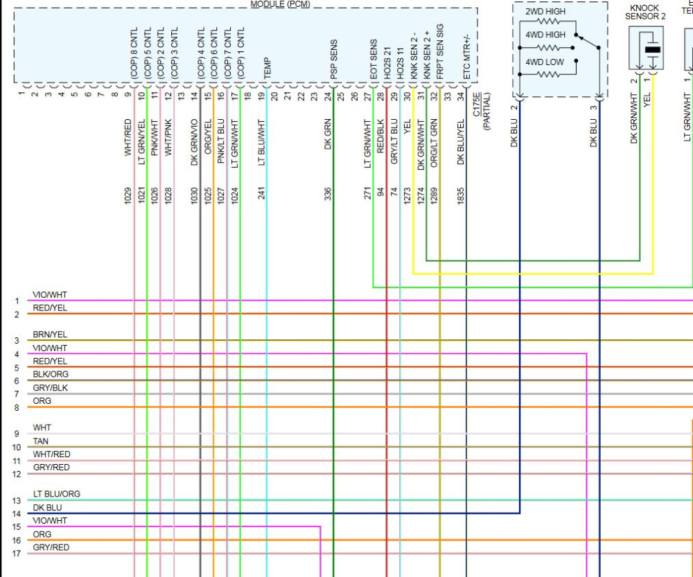

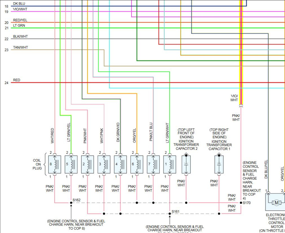

garypuppet1 wrote: Next does anyone have the diagram of the coil wires to the PCM so i can test it at the PCM, also what should the voltahe be at the PCM for each control wire to the coils running or not running? Thanks I really appreciate it.
KOEO, the control wires should have 12 volts, with the COP connectors CONNECTED. They should have 0 volts with the COP connector DIS-CONNECTED.
