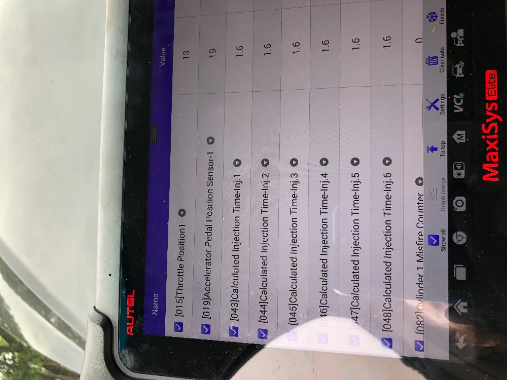

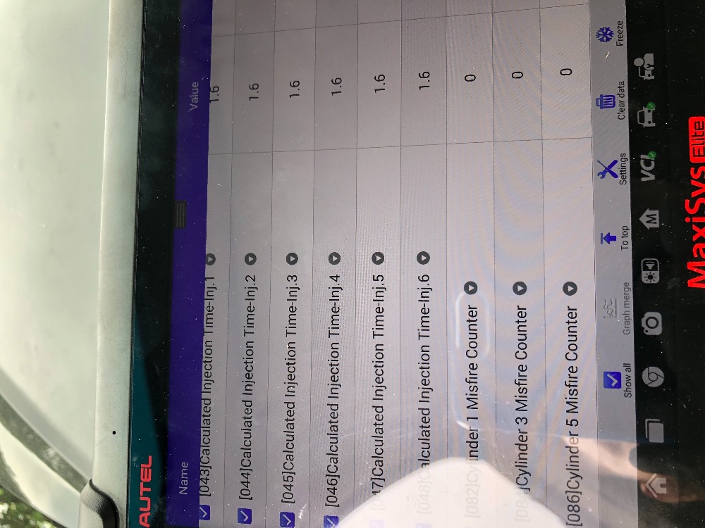

7 years 6 months ago - 7 years 6 months ago #28758 by gerber
Replied by gerber on topic 2008 hyundai santa fe P0301 p0305 p0420
Check this pictures no misfires.

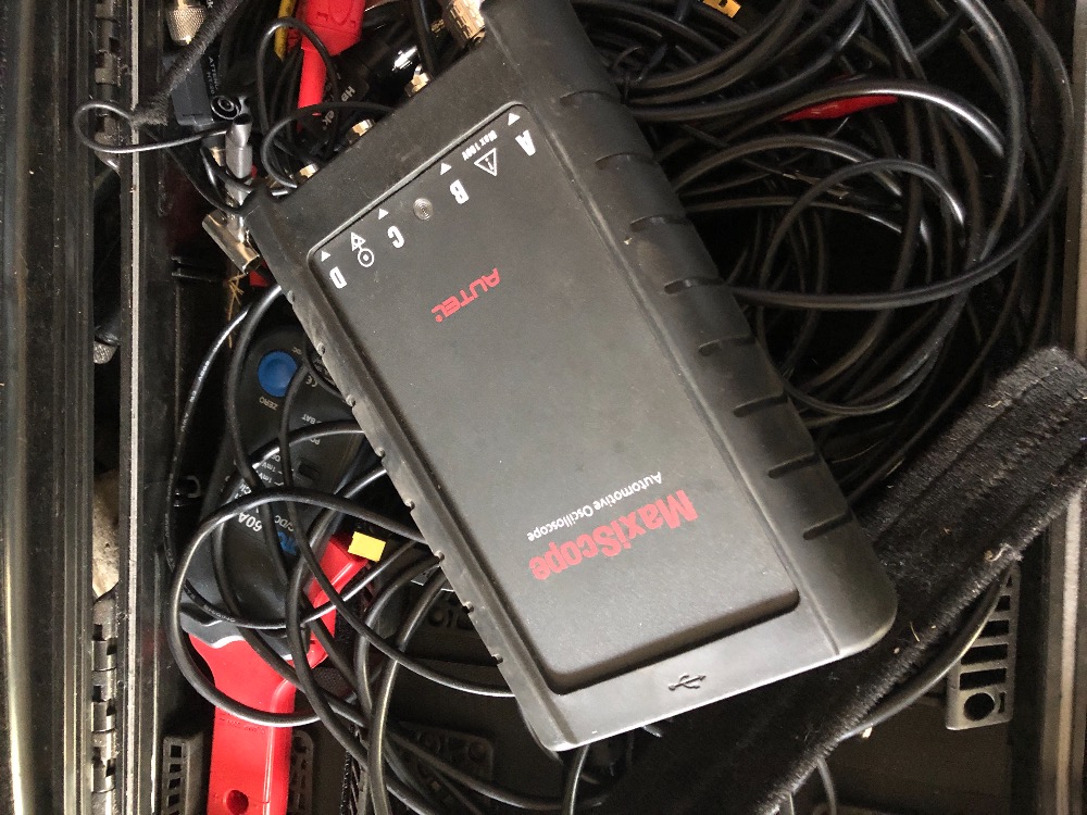

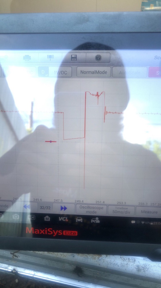

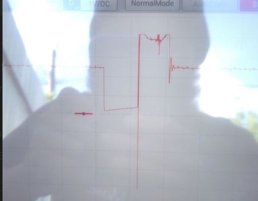

Well guys. Im still dealing with this suv
This is some of the pictures that i got
They probably not the best ones. I just star using scope. So give me advice and ideas Thank you
The picturesis bank 2 and the video is bank 1 im still confused with the video and picture Im going to try again. And upload more pictures

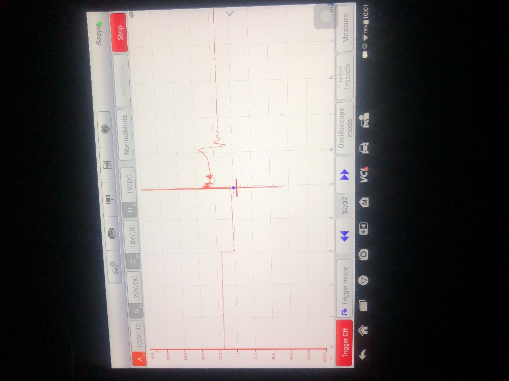

This is when is misfiring
It shut off for 1 second. Why?
7 years 6 months ago - 7 years 6 months ago #29003 by Chad
Replied by Chad on topic 2008 hyundai santa fe P0301 p0305 p0420
Is this Primary Coil Control voltage?
Do you have an Amp Clamp?
Last edit: 7 years 6 months ago by Chad.
