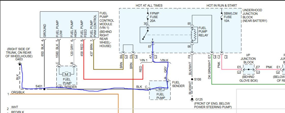

I can't get power from the grey wire at the fuel pump. I can power the grey wire at the fuel pump with a power probe and it will start and run. I take the power away it dies. I've tested at the relay. I have load power and control power. I have a ground and the one going to fuel pump shows as ground too. I think this is my problem, but cant figure out why
Last edit: 7 years 6 months ago by Mparmer84.
- Posts: 2223
7 years 6 months ago - 7 years 6 months ago #28825
Replied by Chad on topic 1999 buick park avenue ultra no power to fuel pump
Is the 8th digit of the VIN a K, or a 1?
Likely, the reason you are seeing a ground on the wire going to the fuel pump is because you are detecting the fuel pump ground THROUGH the fuel pump. This is normal and what you want to see, if the relay is OPEN. I have traced the rout of the ground (for VIN K), through the fuel pump, to the relay in BLUE

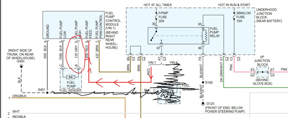

- Posts: 2223
7 years 6 months ago - 7 years 6 months ago #28829
Since you have the VIN 1, power for the fuel pump does not come from the fuse box. It comes from the FPCM (Fuel Pump Control Module). The relay supply's power to the FPCM (PIN 8, RED wire), the FPCM supplies power to the fuel pump (PIN 6, GRY wire). The PCM controls fuel pump speed by supplying a pulse-width modulated (PWM) signal to the FPCM (PIN 7, BRN wire)
Mparmer84 wrote: My vin is a 1..... Do you know the color of wire coming out of the fuse box to the fuel pump?

- Posts: 2223
7 years 6 months ago #28832
Most likely, the module IS bad. However, be sure to check for power, ground, and PWM at the FPCM. The FPCM COULD be bypassed, simply, by supplying power and ground , directly, to the fuel pump, as you have, already, done. I would not recommend this, though, for safety reasons. I'm not sure how the PCM would react, either.

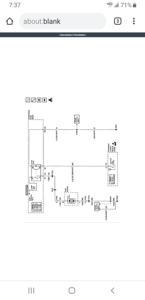

You have no fpcm for this older vehicle. Pcm controls power side switched to fp relay. Grey wire underhood fuse block A7 C3 circuit 120 Grey wire. You have control at pf relay in crank position power?
- autojoe
- Posts: 241
- Thank you received: 7
7 years 6 months ago #28840
by autojoe
Replied by autojoe on topic 1999 buick park avenue ultra no power to fuel pump
Fp diagram

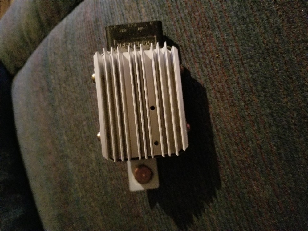

- Mparmer84
- Posts: 4
7 years 6 months ago #28841
by Mparmer84
Replied by Mparmer84 on topic 1999 buick park avenue ultra no power to fuel pump
You are incorrect autojoe. There is one and it was in the trunk above the wheel well as pole71 diagram showed. Have tested it yet as i havent found anyone to crank the engine while i check for voltage, but i got it pulled out!!
- autojoe
- Posts: 241
7 years 6 months ago #28842
by autojoe
I'm sorry was unaware had one on this year car. Only has two speeds based on map input to pcm.
