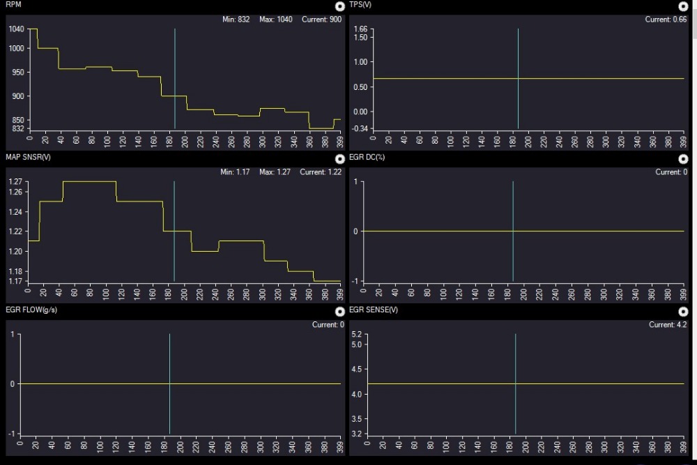

1. signal wire
plugged = 3.98v
unplugged= 4.94v
This value stuck out to me. Does it change with the engine running? I ask because I was recently working on an '06 Caravan 3.8L for various issues, and happened to have a new EGR valve from another shop. The closed valve position voltage was closer to 4.2V.
I don't think that accounts for your code, but it might point towards a faulty potentiometer in the valve.

7 years 6 months ago #28904 by Mechanic 350
  • Mechanic 350
  • Mechanic 350's Avatar Topic Author
7 years 6 months ago #28908 by Mechanic 350
Connector plugged or unplugged?
