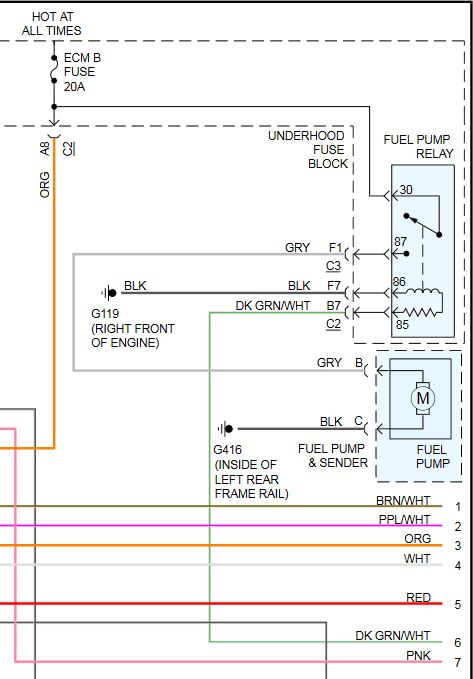

Let's start at the RELAY.
Pull the Relay. With an incandescent test light connected to Battery (+), touch terminal 86 . It should shine, brightly. Now, connect the test light to Battery (-) and touch terminal 30. It should shine, brightly. Touching terminal 85, the light should shine, brightly, when the key is first turned on, and while cranking.
Touching terminal 87, the light should shine. The ground is coming from G416 THROUGH the fuel pump. If you replace the test light with a power-probe, or a fused jumper lead, connected to Battery (+) (or terminal 30) and touch terminal 87, the fuel pump should run.

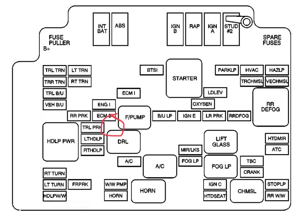

Thanks for replying. Relay clicks when you turn the key to the on position but you will no hear the pump prime. Also, the only light you will see in the dash as soon as you turn the key to the on position is the "Service Engine Soon" only and nothing else. No odometer, seat belt warning light, ABS light, or security light, etc. won't come on. On another forum, they said that the ignition switch might be bad so I replaced that too but unfortunately didn't rectify the problem. Going back to the fuel pump, there is a primer port next to the ECM-B fuse (circled in red) that when energized, you hear the fuel pump prime and the truck will start right up. Is it possible that the wires leading to the fuel pump bad?

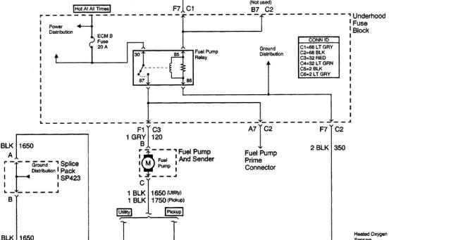

I added the diagram that shows the feed wire forthe prime.....
The prime wire is simply tied into the relay's feed wire to the pump. Physically this takes place within the fuse/ relay box. You state that you can hear the relay clicking.....so most probably the load side of the relay is bad. You may just pull another relay for testing purposes out of its place and put it in the fuel pump relay's place.
Or you put a fused direct voltage feed to pin 87 in the relay socket.
