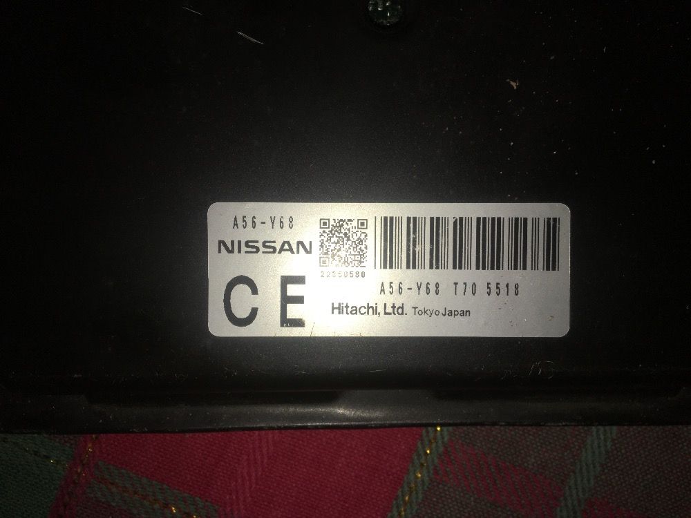

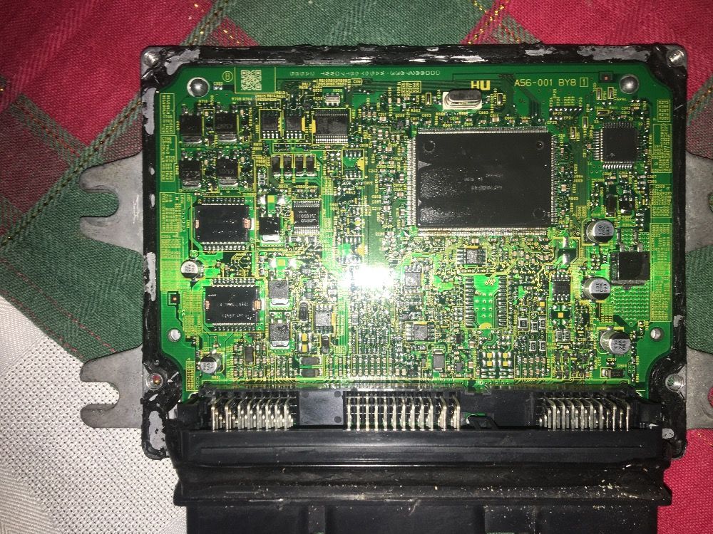

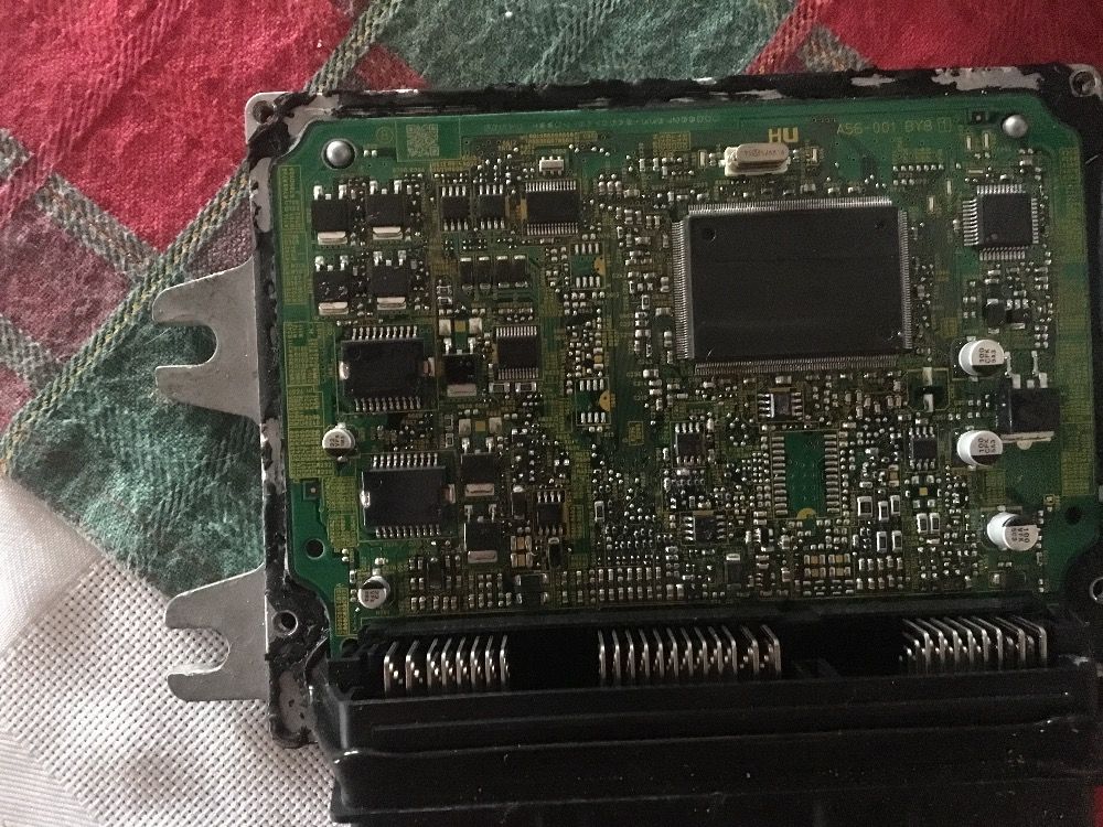

7 years 6 months ago - 7 years 6 months ago #28958
by juergen.scholl
Replied by juergen.scholl on topic Nissan Versa
A picture of the ecu's internals would be helpful as well as a picture of the sticker or theecu identifier data...
You can track the terminal pins back - where the trigger signal leaves the ecu -on the pcb and you'll get to the component that's at charge. Probably it will be an IC and not distinct transistors.

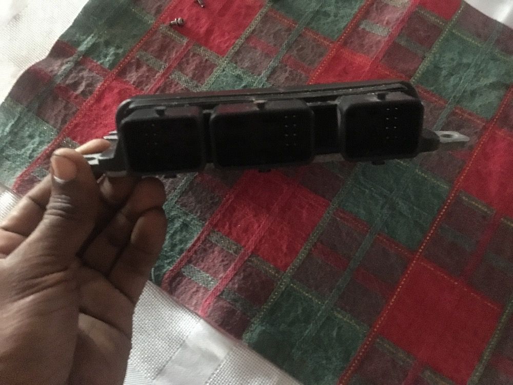

- Kendy
- Posts: 9
7 years 6 months ago #28961
by Kendy
Replied by Kendy on topic Nissan Versa
- Kendy
- Posts: 9
7 years 6 months ago #29088
by Kendy
Can you please point out to me which components might be at fault for not firing coils 1 and 3.
