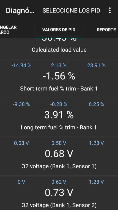

i was thinking same thing, i spent 5 hours back there replacing exhaust manifold gasket after i couldnt find a crack in manifold. the 02 sensors are reading as they should with the upstream oscillating back and forth and the downstream staying steady above .50.
ive had a manifold leak before and the downstream would ready similar to upstream

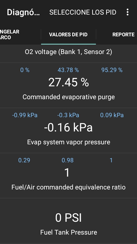

was it your purge valve or the valve on the evap canister?

It was the purge valve. I was not clear. Not for this particular car, but for others.
You can discard evap system, by "canceling" the hose which is connected to manifold

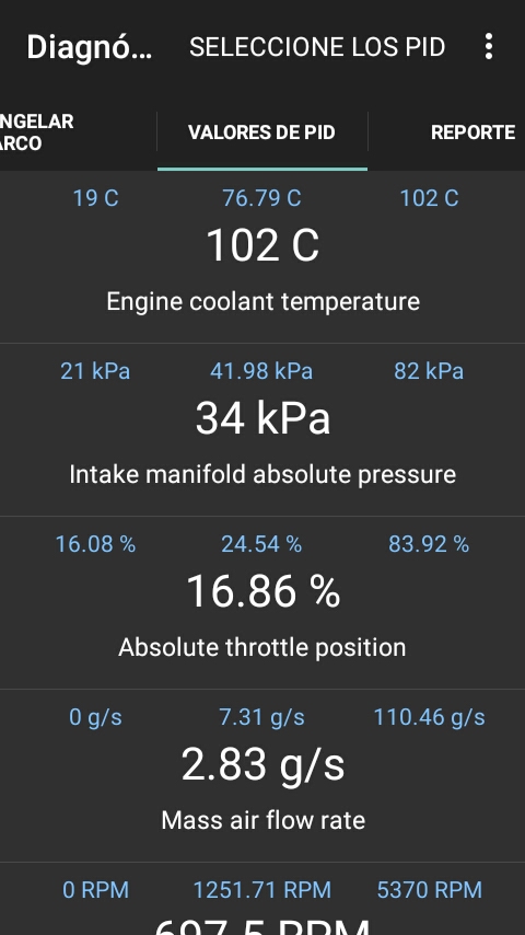

I have some known good values for that ecotec 2.4L taken two days ago. Maybe not only watching trim numbers, but more values, we can discover something else.
