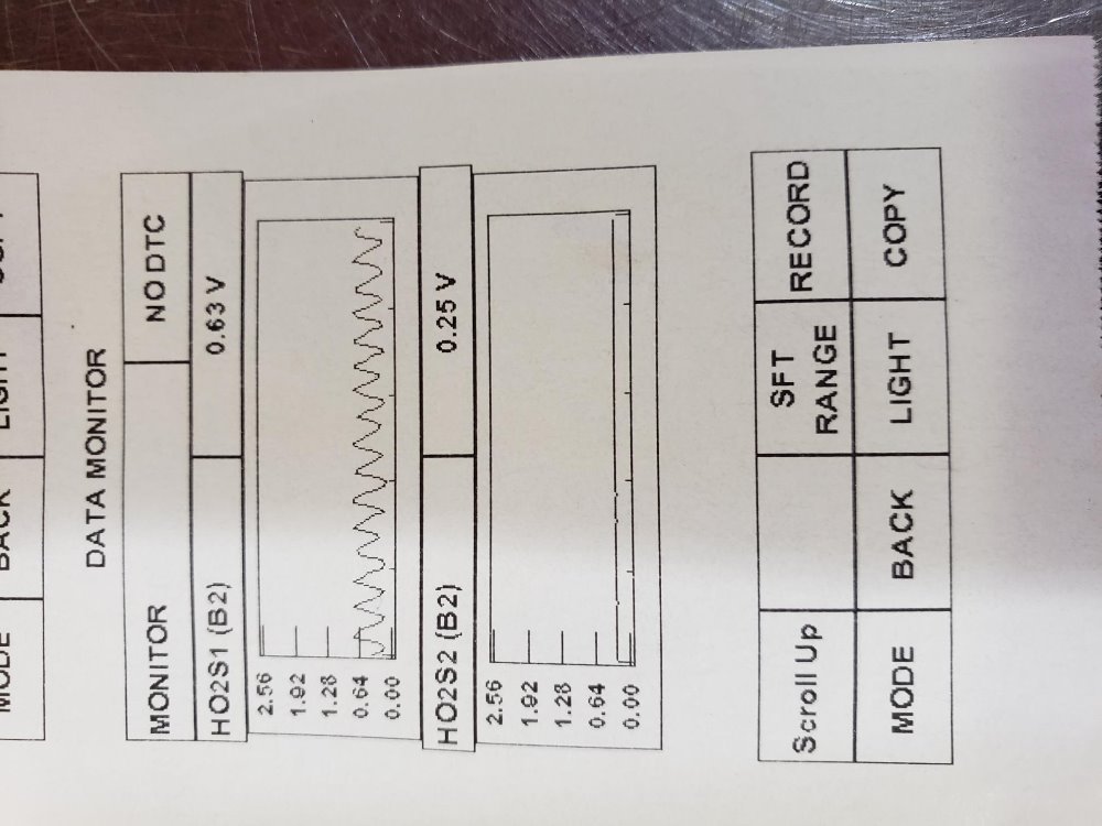

7 years 5 months ago #29360 by SHIMHEAD
Nope, Bank 2 rear pretty much sitting at .28 volts ALL the time, barely a ripple in Line Graph mode. Using Fuel Injection active test to richen/lean mixture +/- 25% does not phase it. It may very well be the original 242,000 mile sensor. For as old as my Consult II is, it still is a very competent tool, compact and quite powerful. Might see if I can post some line graphed O2's after I install the new sensor. Any suggestions for verifying the secondary Cats functionality? Thermal imaging?
"Common sense ain't so common is it?"
7 years 5 months ago #29362 by Tyler
Without a five gas analyzer, that's about the best option you have. Or just a infrared thermometer. If the outlet is hotter than the inlet (after a test drive), I'd call it good. B)
Are you in an area that still does tailpipe emissions testing?
Ah yeah, it's probably dead. :silly: I gotta say, I really wish other manufacturers had that Fuel Injection Active Test available. Toyota has a similar test, but that's about it. It's a very powerful test in the right hands.

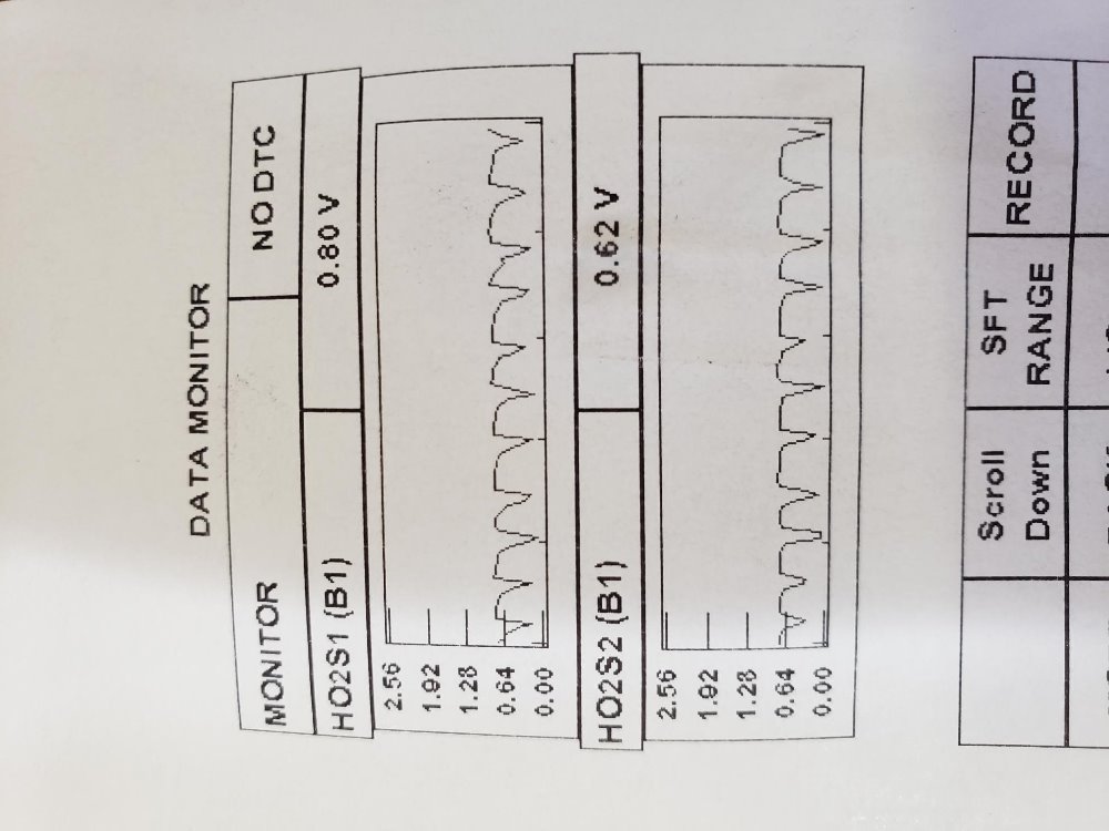

7 years 5 months ago #29398 by SHIMHEAD
Codes P0158/159 set last night and here are a couple of line graphed O2 prints for your perusal....
