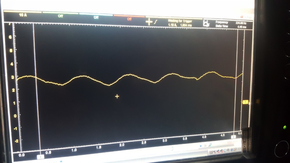

Good day team
Dear all
I have ford explorer 2002 v6 no fuelflex
It is crank no start i have spark and i didnt check for injector control i check injector have (+)
I spray break cleaner it start
I have no fuel pruesser but i think thy replace fuel pump and make this mistake
Plz find attach and advice it fuel is ok

hi sir I believe that is a bypass ignition some more info would be helpful what is the actual fuel pressure and are there any codes in any of the modules thanks

Fuel prusser is 10 psi
No code
No code

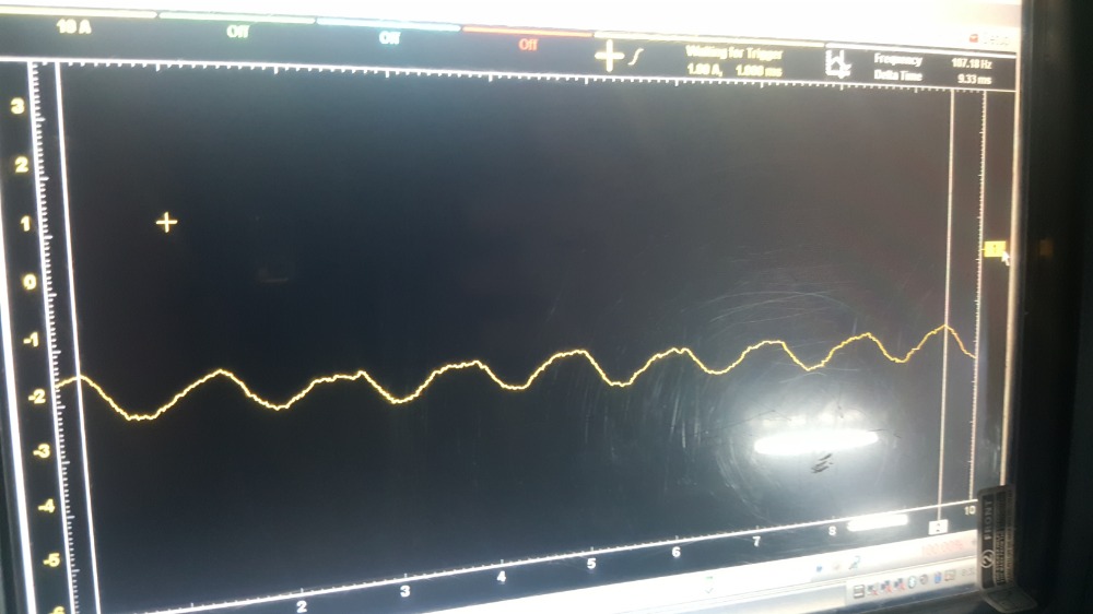

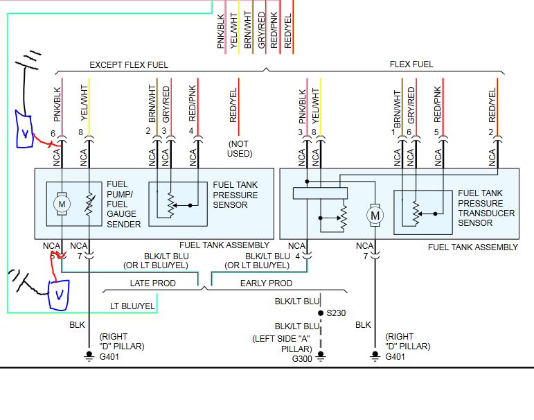

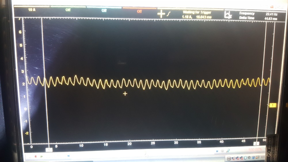

Amperage is way too low. I suspect you have a voltage drop. Check your fuel pump GROUND and make sure there is less than 100-200 mv. You can, also, check voltage going INTO the pump, while it is running. It should be very close to Battery voltage.
EDIT:
Also, verify that there is fuel in the take. (Don't laugh, I have seen it MANY times.) I calculate the speed to be 6431 RPMs. Low current + High RPM's = no/low fuel.
EDIT:
