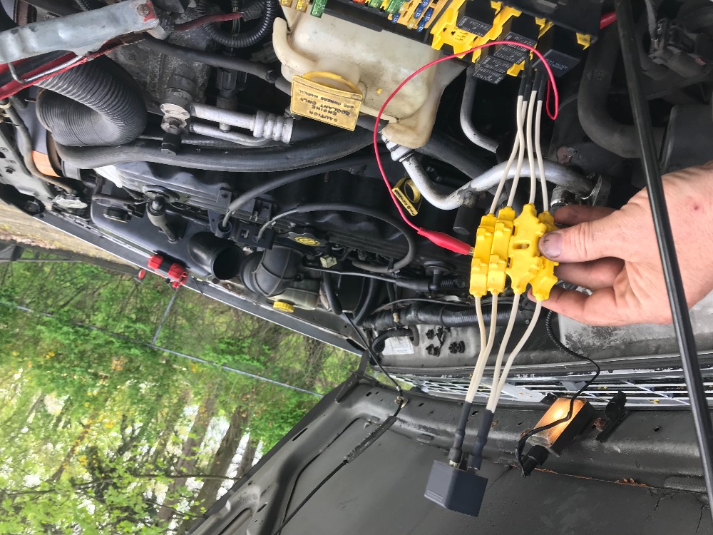

hopfully I can get some suggestions. 2000 Cherokee cranks but wont start. replaced cps even though I new it wasn't the problem. guess I have an extra now. I have been through almost everything. I get power to asd relay fuel pump, but they do not click on. no 5v ref. no 5v from pcm. I can how ever unplug top o2 jump asd relay and get a 5v ref. still wont start. code that came up is p1694 and the no bus on dash I think its the pcm but don't want to throw parts at it like the cps. thanks for any help

hi im checking things now. I do have power going in the c1 pcm no 5volts coming out. I have checked ccd between dsl and tcm all good. on pcm c3 I have power coming in and out going to asd relay I can jump the relay with jumper wires hooke to relay and get 5volt but still will not start not sure why the relay wont swithch without me jumping it

I can jump relay with key off I can not jump it with key on

Is the 5V ref .7V because a sensor or wire problem or is it low coming out of the PCM?
One easy test is to cut the wire coming out of the PCM and test there (leave enough wires hanging out of PCM to reattach later). If you don't have 5V coming out of the PCM, then it's a PCM problem. Check power and grounds at the PCM.
Cut those two wires out one at a time and check if 5V comes back.
imgur.com/a/tQBiLwq
7 years 6 months ago #29221 by jreardon
Replied by jreardon on topic 2000 cherokee classic crank no start
Key off, snip snip, key on, check for 5V and don't let those wires coming out of PCM short to ground.

I back probed the pcm . Witch leads me to a bad pcm it’s a Motorola has a Chrysler vin looks to be aftermarket not sure. Pulled it apart circuit board like brand new checked all soder

cut the wires no 5v
