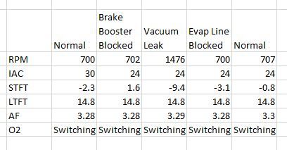

9 years 11 months ago - 9 years 11 months ago #3853 by Gary B
Replied by Gary B on topic 2001 Toyota 2.2 MAP engine high LTFT @ idle
I made a table of the results and attached it as a jpg (I can't find a way to insert the picture itself):
1) I first ran for several minutes with everything normal
2) Then with the brake booster line off and the vacuum line capped
3) Then with that cap removed so I had a big vacuum leak
4) Then with the booster hooked up again and the evap purge line pinched off
5) Finally a few more minutes with everything back to normal
I was letting it run for about 90 seconds or so at each step, something seems wrong with that LTFT stuck at 14.8. I went out of Enhance Data and looked at the Generic OBD2 and saw that same number though, so it seems real, not a substituted value. The STFT went negative with a vacuum leak, not what I expected to see... unless it is interpreting this as a demand for power? But after a few seconds it seems like it should've corrected the LTFT. I should've had the Injector pulse width up too, I just looked again at Section 1, page 5 and see that is one of the ones that is shown there. and it gives and idea of what the computer is "thinking".
Also, it sure seemed odd that the idle was way above normal during the vacuum leak part of the test and yet the IAC% was still 24, it didn't seem like it was even trying to bring it down.
Last edit: 9 years 11 months ago by Gary B. Reason: I forgot something

9 years 11 months ago #3855 by ScannerDanner
Replied by ScannerDanner on topic 2001 Toyota 2.2 MAP engine high LTFT @ idle
rn8849 wrote: The STFT went negative with a vacuum leak, not what I expected to see... unless it is interpreting this as a demand for power? But after a few seconds it seems like it should've corrected the LTFT. I should've had the Injector pulse width up too, I just looked again at Section 1, page 5 and see that is one of the ones that is shown there. and it gives and idea of what the computer is "thinking".
Two things:
1. Welcome to Speed Density engines with vacuum leaks! It does not cause a lean condition in most circumstances due to MAP sensor signal changes.
2. Idle will be high with a vacuum leak on a MAP (speed density) engine. MAP sensor "sees" the psi change in the manifold, signals the ECM that there is an additional load, ECM then commands more fuel. So you have more air and more fuel = high idle.
The IAC duty cycle at 24% is most likely a fully closed command, so the reason it didn't drop the percentage any lower, is because it is already closed all the way. Spring pressure is higher than magnetic field strength at this point.
To compare, fully open (mechanically) may only be 65%. Make sense?

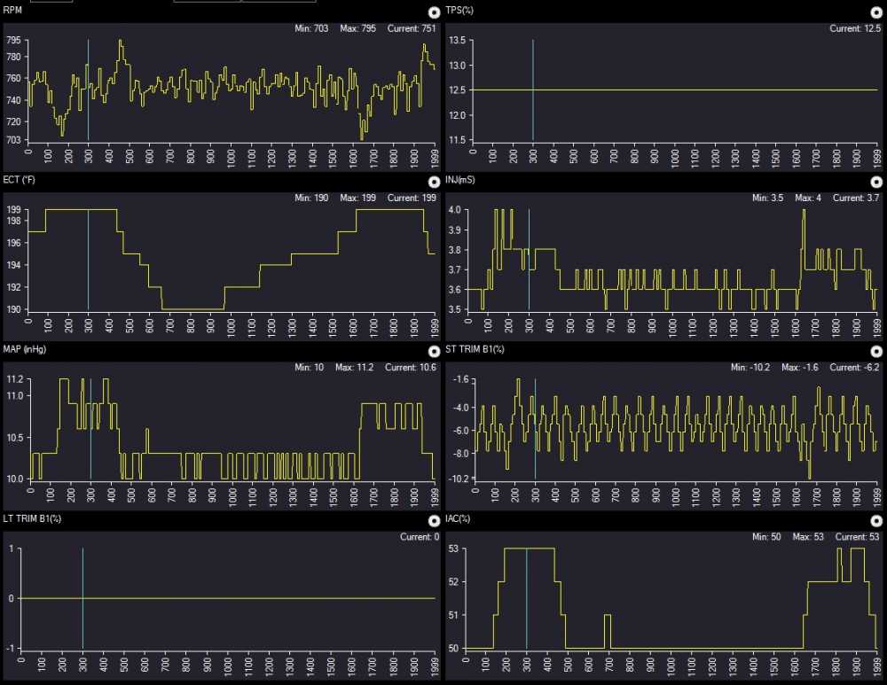

9 years 11 months ago #3860 by Tyler
So I went looking for some known good data to see what a typical IAC runs on this engine. Closest I could come was a '97, but I really don't think they changed all that much between years.
Known good vehicle, in for an oil leak fix.
www.scanshare.io/share/EIUJhCDPLkeFnTvpICYn5w#0,1,3,7,9,10,18
The changes in idle speed are from the cooling fan cycling. That 24% IAC number sure does seem low in comparison :unsure:

9 years 11 months ago #3868 by ScannerDanner
I think he made a vacuum leak when he saw that number and was questioning why the % wouldn't drop any lower with the idle still being high.

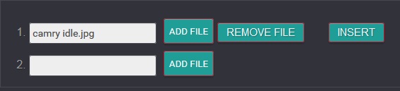

9 years 11 months ago - 9 years 11 months ago #3886 by Tyler
rn8849 wrote: Tyler,
How did you insert the jpg? I couldn't figure out how to do anything other than just attach it.
Gary
No problem! It's actually just a couple more steps past uploading the attachment. Once you've attached the file you want, you hit "INSERT", and it produces some boardcode wherever the cursor is.
The boardcode produced looks something like this:
Code:
[attachment]camry idle.jpg[/attachment]
After that, just move the boardcode wherever you want the photo to show up!
About your Camry... This is a long shot, but maybe try blocking off the PCV hose? I've seen it a couple times on MAP engines where a stuck open PCV valve will suck air through valve cover gaskets/crank seals/anything it can, and result in strange IAC behavior.
I'm not saying it'll account for the fuel trims, but it might account for the low IAC % at idle.
