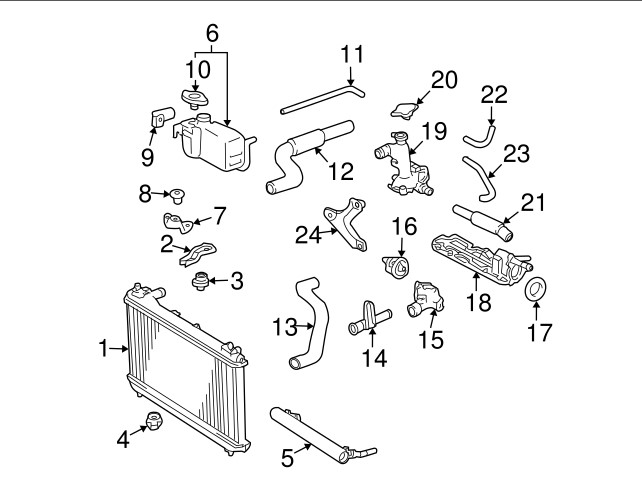

The best idea I have is a leak in the hose between the water outlet and the thermostat housing. Parts diagram for reference, part #21:
I've seen the water outlet gaskets seep, but never gush the way you're describing. The mirror may be your best bet - or a cheap borescope! Never seen that hose fail, but there's a first time for everything. :silly:

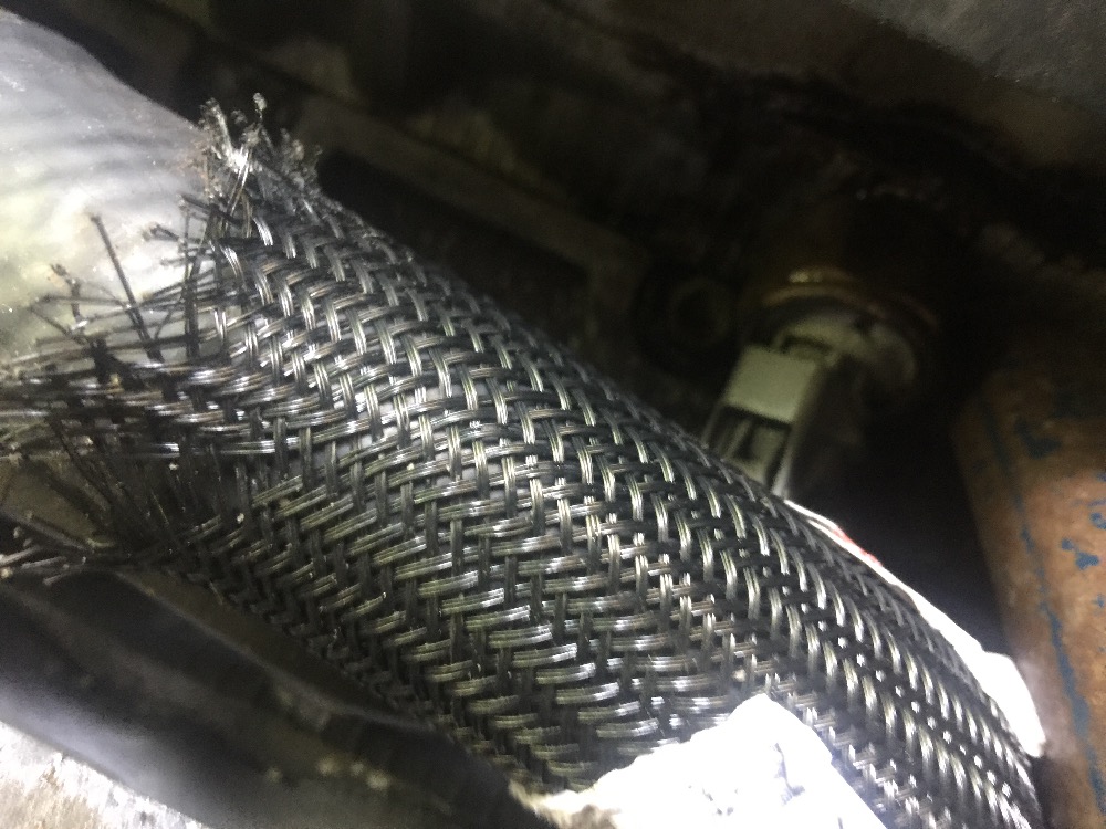

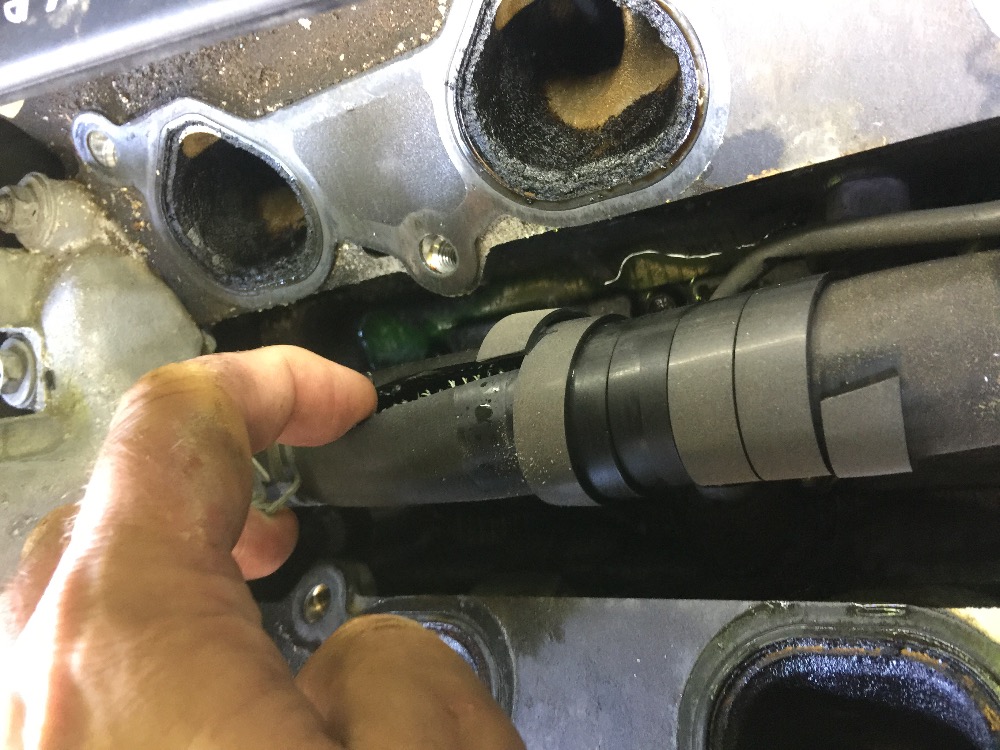

Well I finally had a chance to get back to this project and the hose underneath the lower intake manifold was indeed ruptured see picture below. I’ve got another question while I have this engine opened up:

7 years 5 months ago #29810 by guafa
You can hit it gently with a screw driver and see the noise produced. But you need a scope to do so.
7 years 5 months ago #29811 by guafa
About the hose. That kind of ruptured (longitudinal) is due to over pressure. I does not seem fatigue, neither aging.
I'm afraid you have not found root cause yet.
