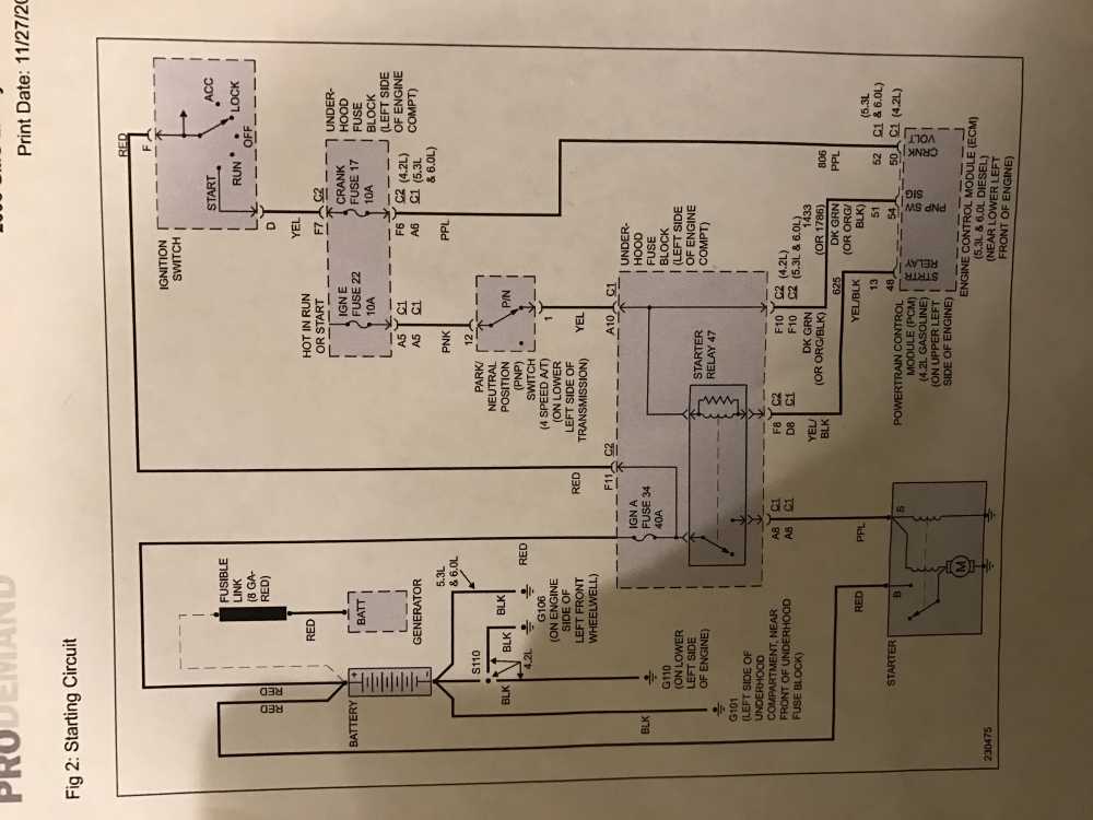

06 envoy with 4.2 engine. Has an intermittent no crank. Noticed that when you bang on the fuse box it comes back to life. Already replaced crank relay but still does it. I noticed the ground Signal at the relay is missing with the no crank condition is there but I do have the crank power supply voltage from the ignition switch.on the crank fuse 17 I wanted to test at the ECM to see if it was a computer problem or Fusebox problem but the diagram throws me off a little bit seems to be a simple circuit but never have had training on this besides scannerdanner Premium videos. Other thing I noticed is that you have to really turn key over hard to get voltage at crank sensor 17. Simple turn the key normally will do it. Don't know where to start. Frustrated because it's in intermittent
Ok where did you measure that ground. At the relay or PCM? Just think about it if the PCM receives no input it won't ground the control side of the relay.
Where does it throw you off Chris.
So you mean between ignition switch and crank fuse 17?

I had my son turn the key while I was checking the signal at the relay but nothing was there till after you hit it lol. The part that troubles me on the diagram is The yellow black wire from the ECM to the starter relay is supposed to ground the circuit But I back probed the yellow black wire on connector 1 pin 48 of the ECM to check my signal there and nothing as well. After I hit it pin 48 goes to ground all the time with key on then it starts fine. I was under the impression that pin 48 was only supposed to ground when ignition was on start position. I think I'm looking at it wrong

It looks like that pin 48 is only grounded while in start position or it will be cranking all the time. To check if it is a good ground you need to load a circuit with something like 5 watt bulb. Looks like there is an input problem from the Park-neutral switch which wiring goes through a fuse block (where you hit sometimes))). I would check if you are losing battery voltage on Dark Green wire 54 while in no crank situation.

At the ecm you should have
With the key on
Pin 48 battery voltage
Pin 54 battery voltage
Pin 50 no voltage
Then cranking
Pin 48 Earth
Pin 50 battery voltage

Been here before on a very similar Envoy, ended up finding poorly crimped fuse box terminals. Just like yours, I could wiggle the box and make the problem come and go.
If possible, the next time it happens, try wiggling just the crank relay, see if the problem goes away.

Intermittents are the worst :( If you have a relay of the same type that you could sacrifice, you could test for spread pins at the fuse box. You could also use this to load the box with a small bulb and check for voltage drop. My experience says you'll find a problem at the relay pin itself, and not at the bulk connectors going into the fuse box.
