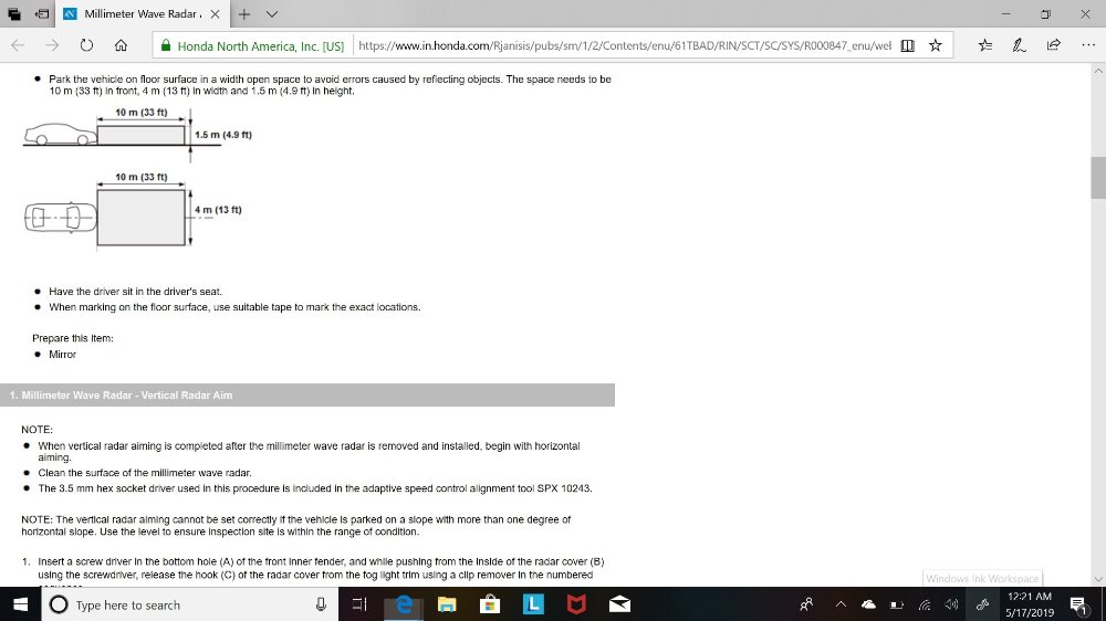

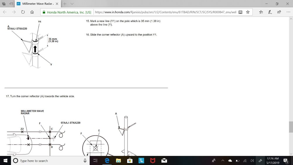

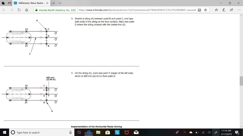

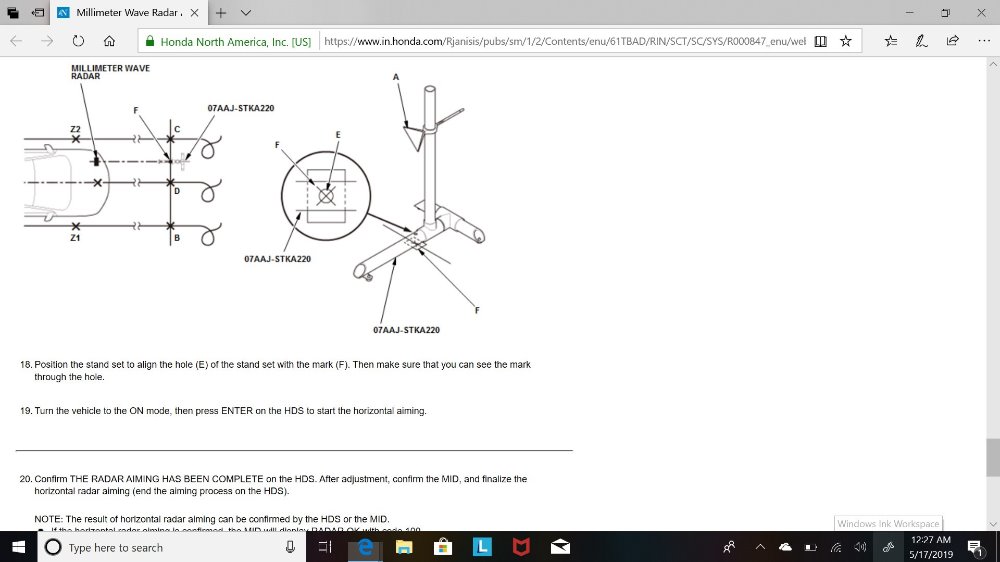

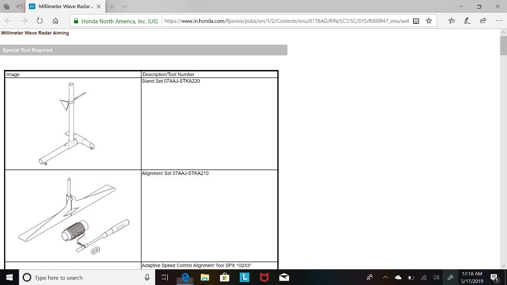

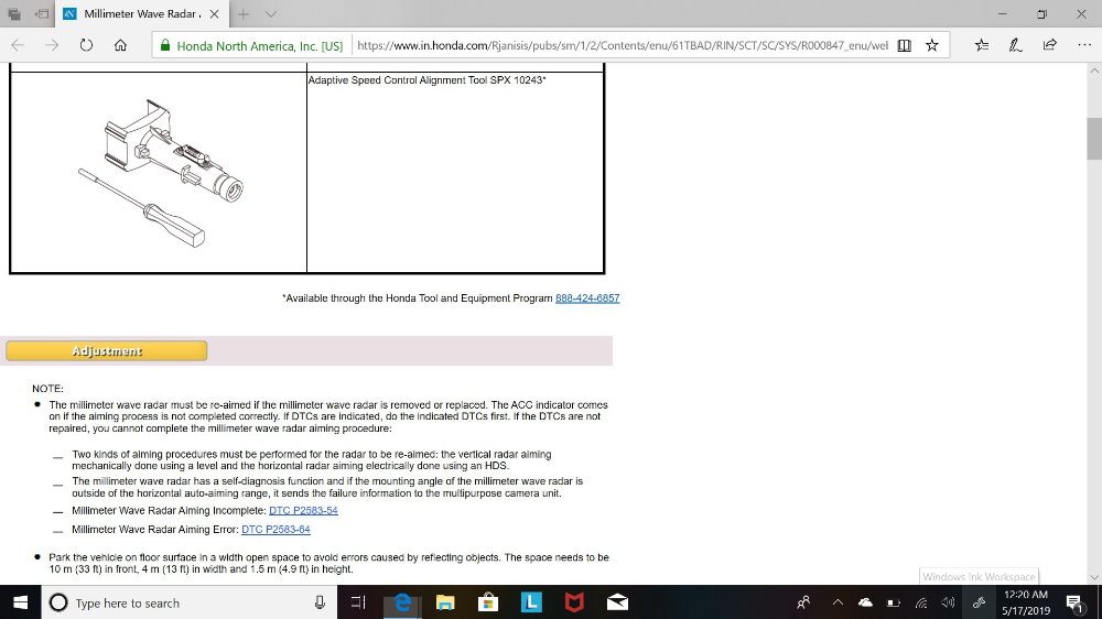

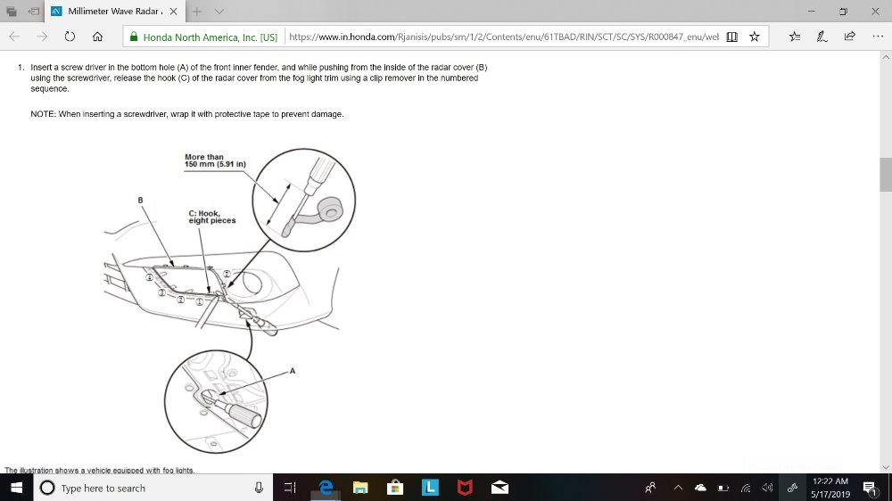

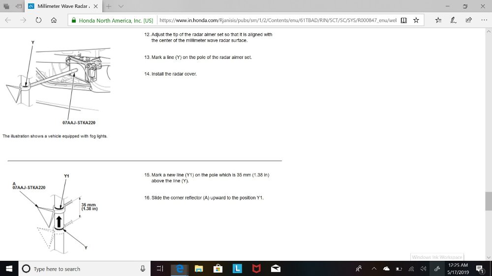

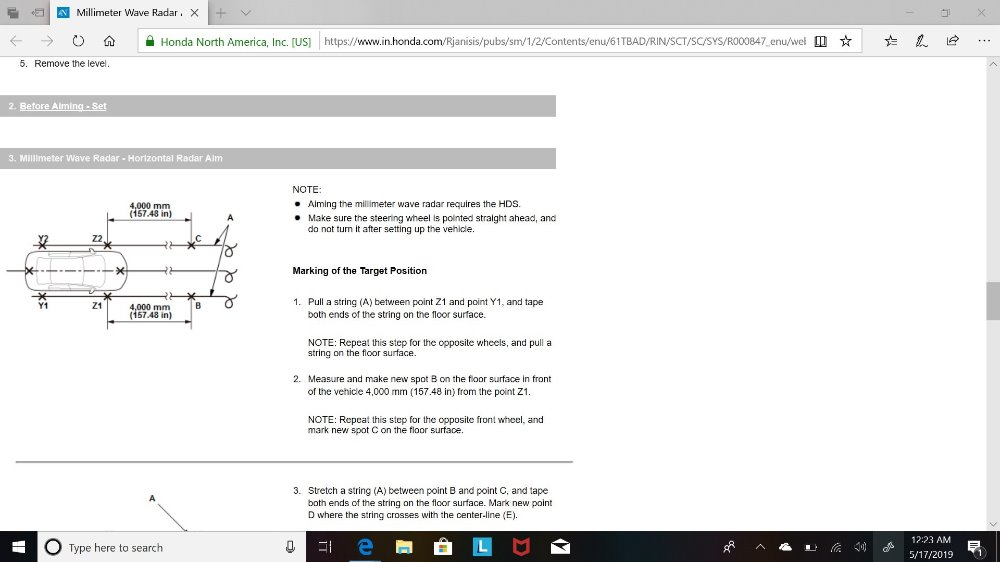

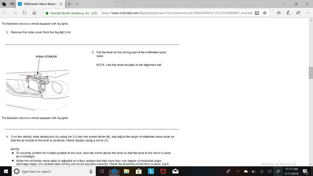

The tools (targets, strings, attachments, stands, HDS) required for this job are very costly but at least Honda/Acura does sell them to the general public. You can buy everything except the HDS from your local Honda parts store. My experience with calibration was at Acura using the factory HDS system. Very time consuming and may require to be done more than once. Once you complete the static radar calibration, some models will also require/prompt you to complete a dynamic radar calibration which will have to be done on the highway. I have attached all the directions and part numbers on your 17 civic.
I know Autel offers the ADAS system which can be had for only $20,700
for the complete calibration package on many makes/models. I have no experience on how well it works.

Thank you very much for the information shared but it is rather unfortunate that they are all screen print capture images therefore difficult to read, why don’t you use the little printer icon at the top right corner and print each screen into xps file format and share or into pdf and share it by zipping the total print save.
I also have the Honda HDS device and the software running on laptop but I just want to know the steps involve in installing the radar via the HDs because I can’t see no speicjal function for it

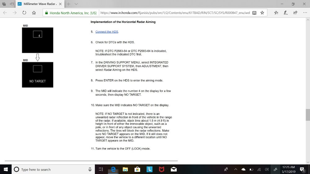

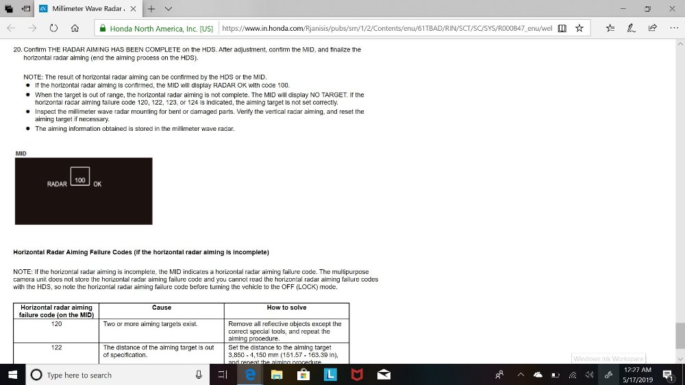

The radar aiming function can be found under DRIVING SUPPORT MENU, then go into ADJUSTMENT.
I tried reloading all the files (Pages 1-13). If you still have a difficult time seeing it, message me and I can email them to you.

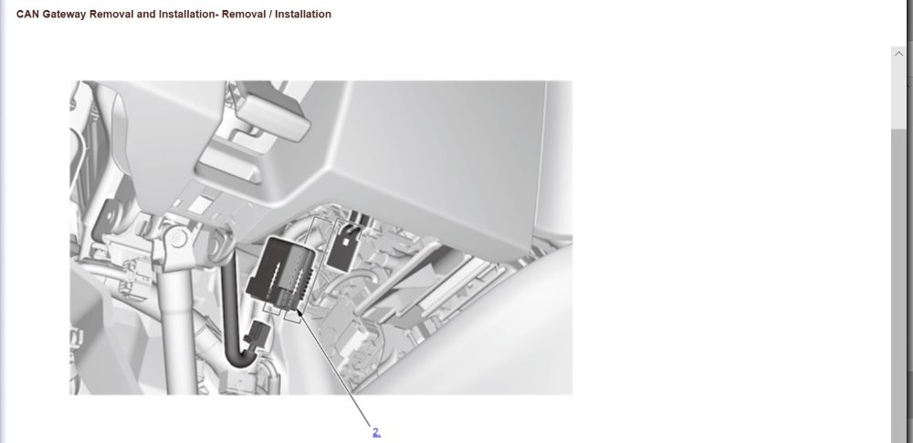

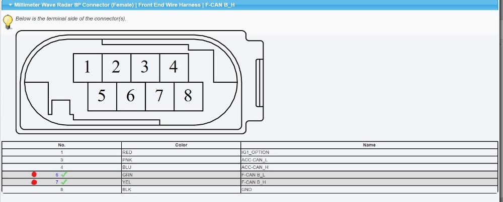

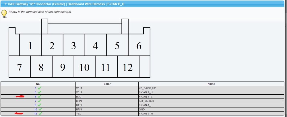

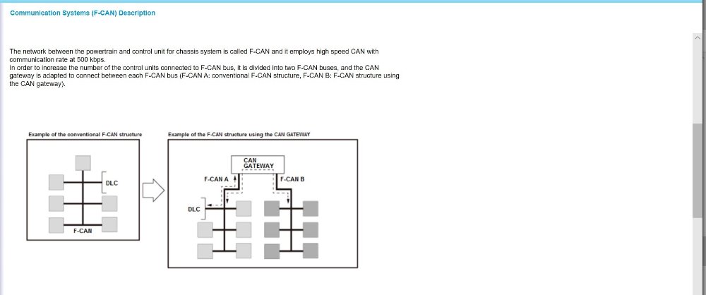

Let's shift our attention to the F-CAN B lines which consists of 2 bus wires (F-can B Low GRN & F-can B High YEL). Check each one for short/open/high resistance. Use 2 jumper wires and run them directly from radar to the CAN gateway, check to see if radar unit is back online.
Note* F-can B Low GRN changes to BLU color at CAN gateway.
Also perform an ALL DTC test on your HDS to test if any of the following F-CAN B bus components are having a no comm issue;
SRS unit
Audio/Navi unit
Multipurpose Camera unit (windshield)
Electric Brake booster unit
SRS unit
Audio/Navi unit
Last edit: 7 years 3 months ago by CurrentDraw.

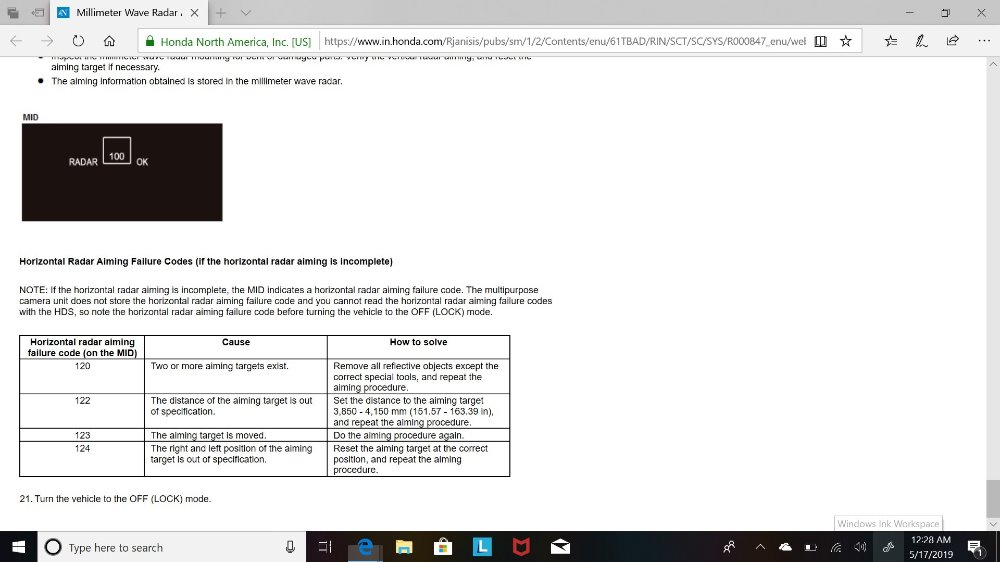

I have installed a new Milliwave Radar now and it is throwing code: P2583-54 - aiming incomplete, now I have my hds , must I follow the steps mentioned , I have the ACC , LKAS light still on, would this light goes on when I am able to complete the Aiming processing?
Christ De Way Maker
