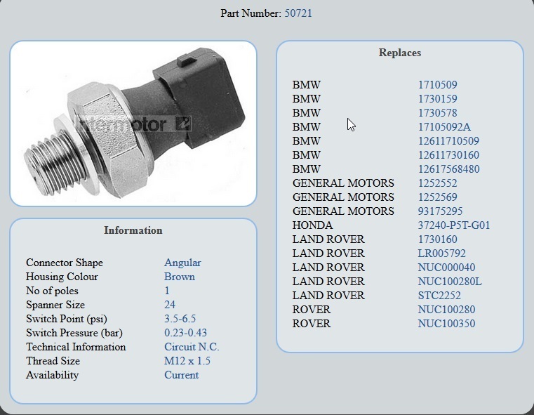

A quick check reveals Rover petrol & diesel Max 5 bar, oil pressure switch 0.5 to 1 bar. The BMW diesel should be similar.
BMW diesel is prone to the light coming on at idle which can be due to a dirty MAF pulling the idle speed down and the oil pressure switch going out of calibration with age.

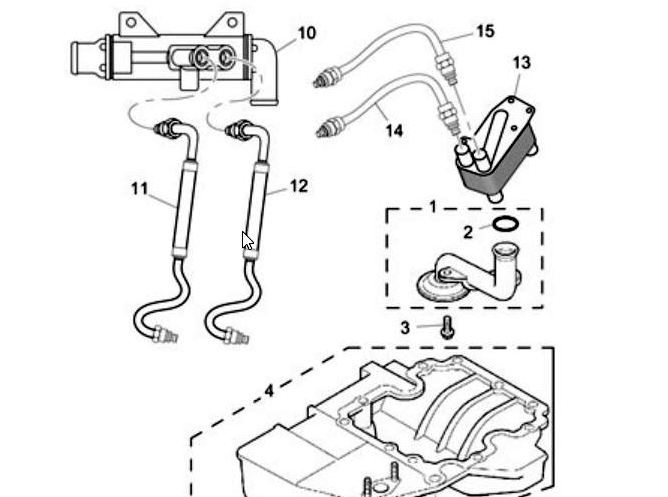

I wouldn't worry to much with that however if the oil light is blinking at idle try a pressure switch. I am not sure if the pressure relief valve can be removed cleaning or replacememt.
These engines aren't prone to bearing problems, one possibility is the oil pick-up tube in the sump is either drawing air at its' o ring seal or its' mesh filter is gummed up.

It looks like the oil pressure switch out of spec

The switch specification is 3.5 to 6.5 PSI ---- new switch required

The light tapping noise is more likely to be from the top end of the a big end bearing problem tens to be a fairly solid knocking sound that appears as you raise the RPM towards 2,000 or so. I have encountered a couple of sticking hydraulic tappets on the 4 cylinder version of the engine.
There is a tendancy to put too much importance on oil pressure, the oil pump pressure dosen't force the bearing shell surface clear of the crank journal the bearing just needs a steady flow of oil as the bearing actually act as pump and draws oil in. The oil pressure that keeps the bearing shell clear of the crank journal surface is generated within the bearing.

10psi is well above the the pressure the oil pressure switch should work.
