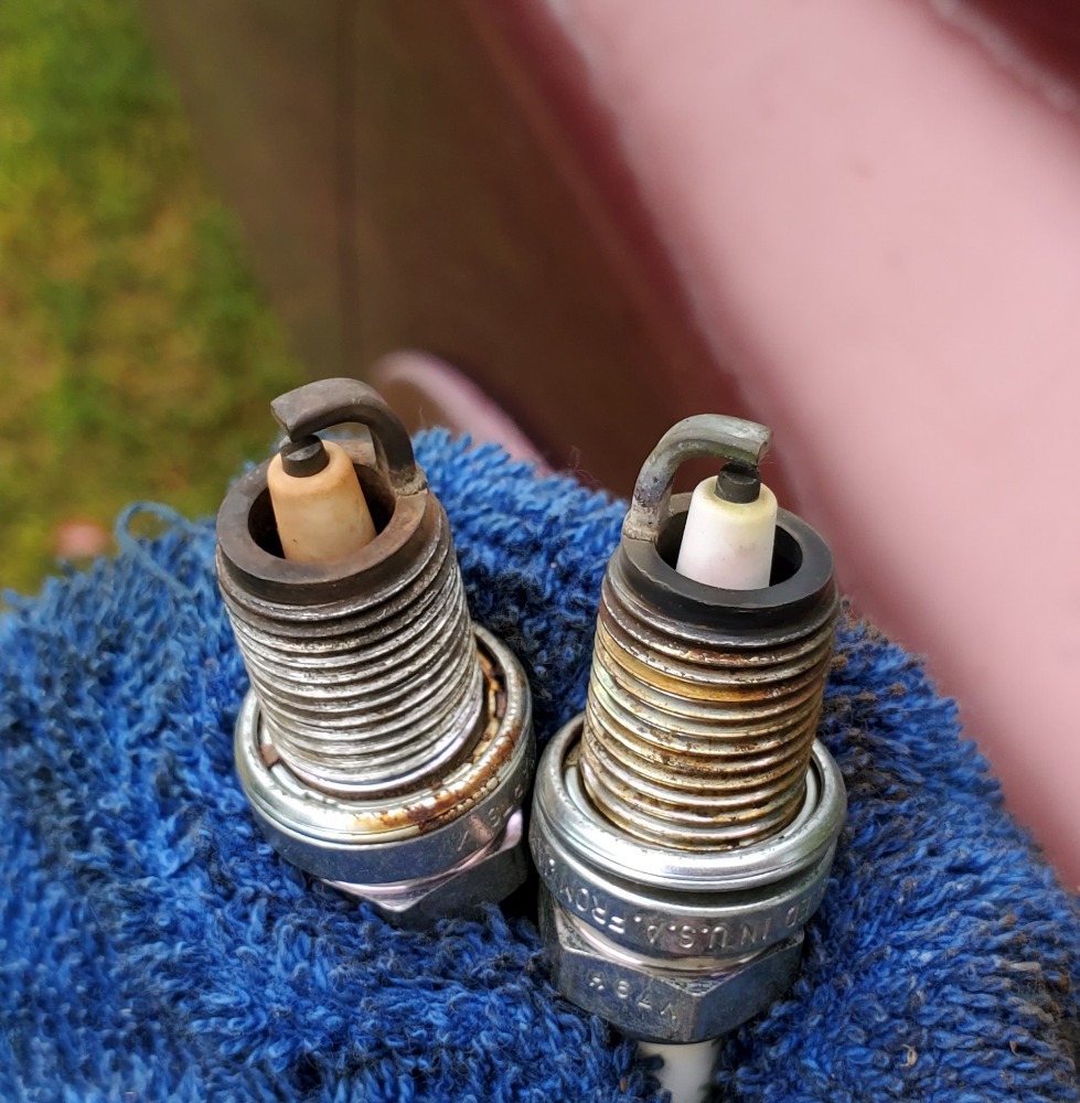

How would you interpret this discoloration of a single spark plug

I have never touched a spark plug before but that looks like rust on the left. Does it feel like rust?

Replied by Cookie21 on topic Spark plug analysis
Yes it was more rusty than this but i kinda wiped it down not planning on posting a picture of it

Replied by jreardon on topic Spark plug analysis
Put one rusty spark plug in, leave rest out, and watch the coolant for bubbling during cranking.

Replied by Andy.MacFadyen on topic Spark plug analysis
Red-Orange OAT coolant leaking into the combustion chamber discolours the spark plug and combustion chamber

Replied by Tyler on topic Spark plug analysis
Agree with the coolant suggestions. Are you chasing some kind of misfire or overheating issue?
I've also seen fuel additives make plugs that color, but they also discolor all the plugs evenly.
