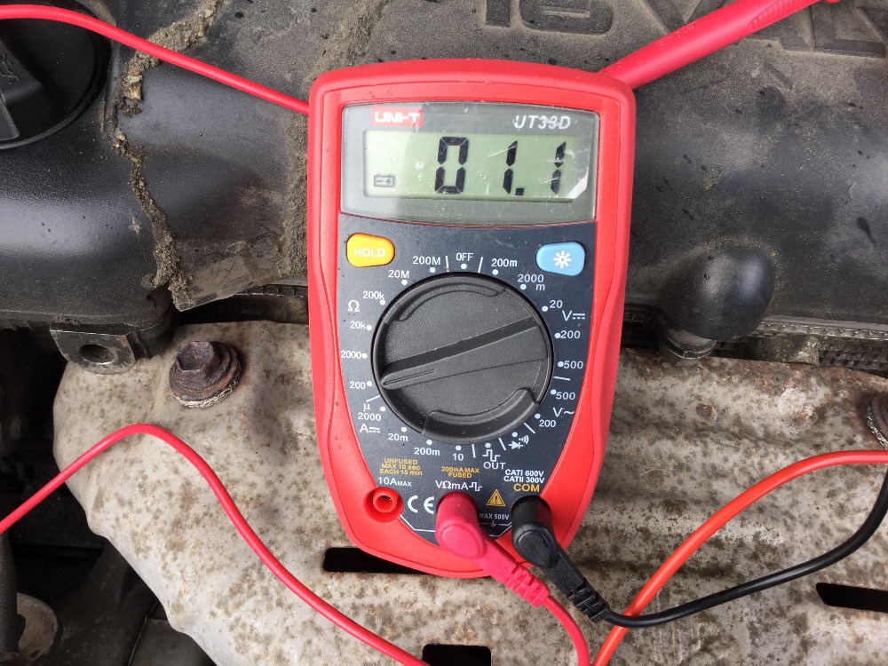

Hello experts in the house.
I would like to know how to specifically check the AF oxygen sensor ohms reading for my car. It thus appear Toyota has one part number for different ohms readings.
My car throws up P0420 and P0430 and I have done and change all parts and now I give up.

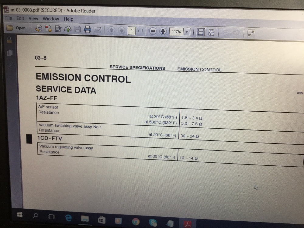

I finally stumbled on the repair manual that states 1.8 - 3.4ohms at 20degrees Celsius for my Toyota Avensis Verso 2002 ACM20L 1AZ-FE engine.
Car registration date: 21st August 2002
TecDoc ID 16026

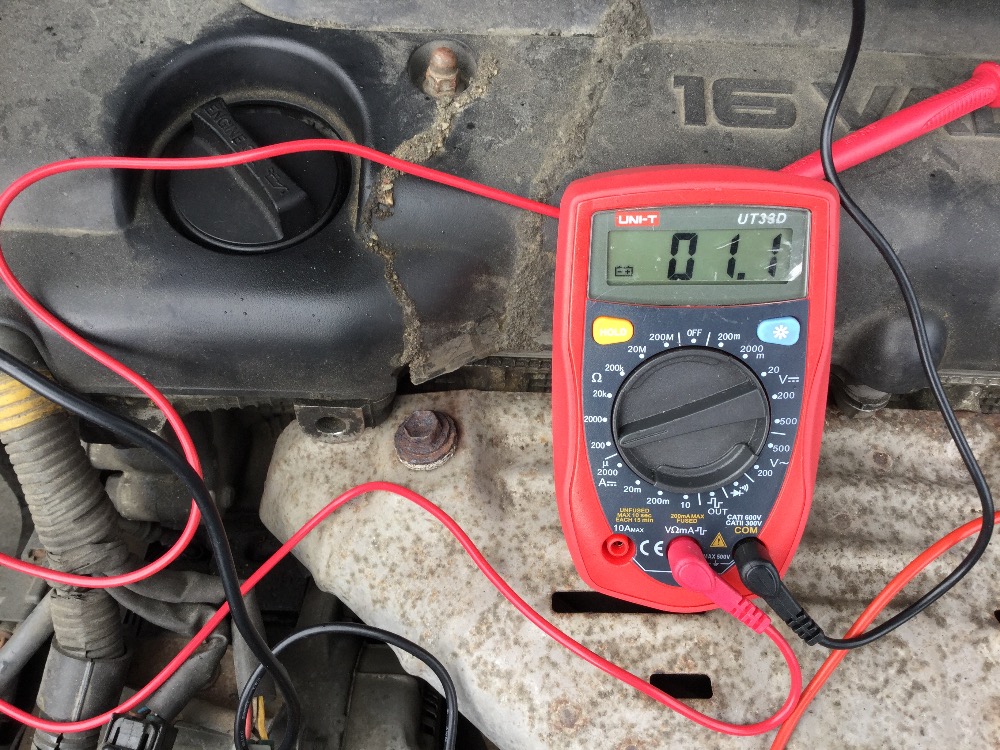

Toyota dealership used my REG NO to order for brand new OEM AF sensors that both read 1.1ohms at 20degrees Celsius.
I am taking this case up with the dealership and I need you guys to point me in the right direction because the sensors don’t come cheap.
It’s such a bad and poor engineering by Toyota for having different ohms readings for one part number, why can’t they just change the part number if they are going to re-engineer the resistance.
I would really appreciate you guys help.
TecDoc ID 16026

7 years 5 months ago #29660
Replied by Tyler on topic Toyota AF oxygen sensor ohms
It looks like you're measuring heater resistance, correct? If so, then I think I'd be OK with the readings you took.
It's not exactly within range, sure, but I think it's close enough.
Is the car showing any heater circuit codes, or just the P0420/P0430? If no heater circuit codes, then I wouldn't dig further. In my experience, Toyota's heater circuit monitors are usually excellent at detecting any issues. Most of the ones I've seen are monitored for current in some way, and will flag codes for over and under a specific current range.
