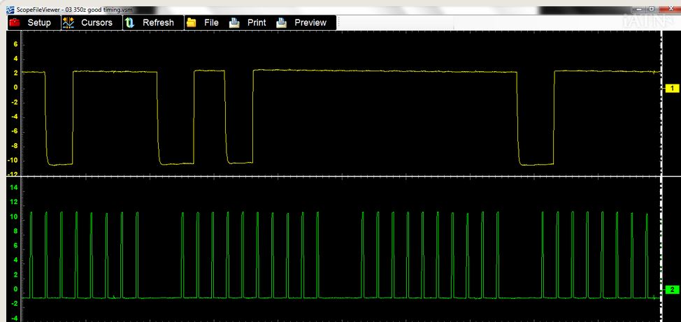

Hi there thank for your help in advance.
As the title says I have a problem at a 2003 Nissan 3.5 p300 code.
By doing a cylinder drop test found
Misfire at 2,4 and 6.
There is good comprehension,
Spark, injectors are opening,
Also check for back pressure at exhaust and it seems fine.
I'm running out of ideas
Next test will be check the timing chain.
but I'm not sure about that because of the good compression.
Does someone have or can hand me a good cam and crank correlation capture for this engine.
Any thoughts will be helpful thanks a lot

Do you have information about O2 voltage activity and fuel trims?
Those could give us a clue.

Guafa. No I don't I will take some shots.
But now I'm suspended on a bad engine because cylinder 2 seems to have combustion but 4 and 6 doesn't
At all,
If I pull spark plugs they are clean as new just little of oil
But all the others I can see combustion on them.
My be oil rings or head gasket

Thanks guys for your help.
And to anyone that ever have this similar problem the solution was
Cylinders 4 and 6 connectors were plug wrong
4 was on 6 and 6 on 4
They were firing nowhere near TDC
I guess whenever they replace the spark plugs they did that
Car was park for 2 years until today

Well CHAD send me the correlation between cam and crank check that it tells me a lot about the good condition of the timing.
Plus I have already checked every single thing as
Compression, spark injection pulse.
I even switch spark plugs, injectors coils from good known cylinders and nothing.
There where no signs of combustion every time I removed the spark plugs from 4 and 6.
And I was also able to look the top of the cylinders they were a little washed out because of the fuel.
Also remembered a video from scannerdane of a Ford scape that had the same problem connectors
were plug incorrectly.
And every thing brought me the solution
Wish I knew this before but it really makes feel good to know I done it I solved the problem.
