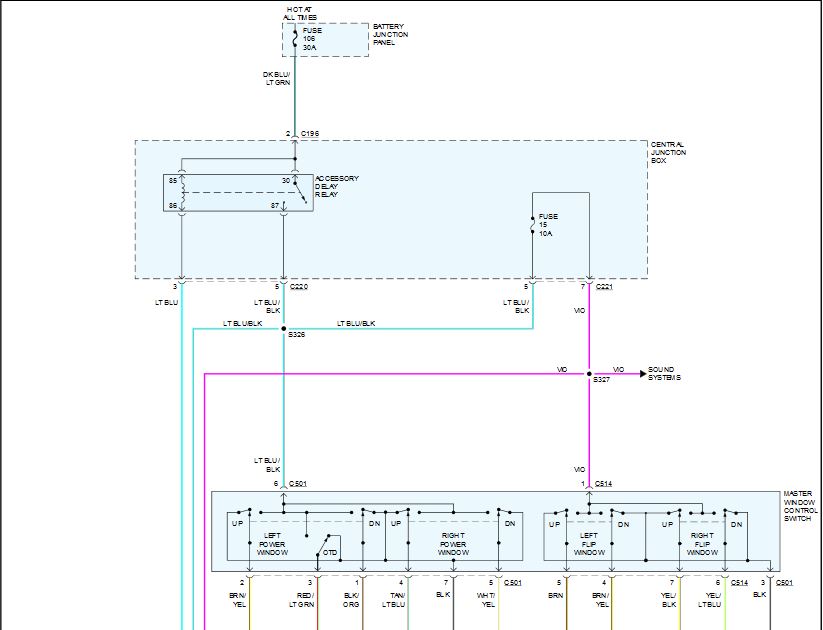

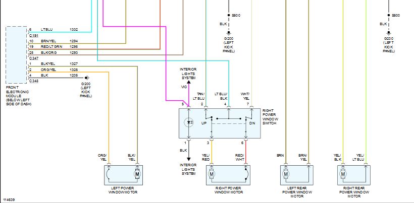

last week I posted a question about replacing a failed window switch on my ford windstar. you folks helpfully pointed me to the correct part. I installed it yesterday and now, neither the driver or passenger windows will roll up. when using the switch, I heard (using new switch) an electric buzz from the driver side of the vehicle. The second time I tried it, my cd player/am/fm radio shut down. HELP

Is the battery charge good? Low system voltage can have all kinds of strange effects.

Yes, battery is good.

the two grounds in left kick panel check those
