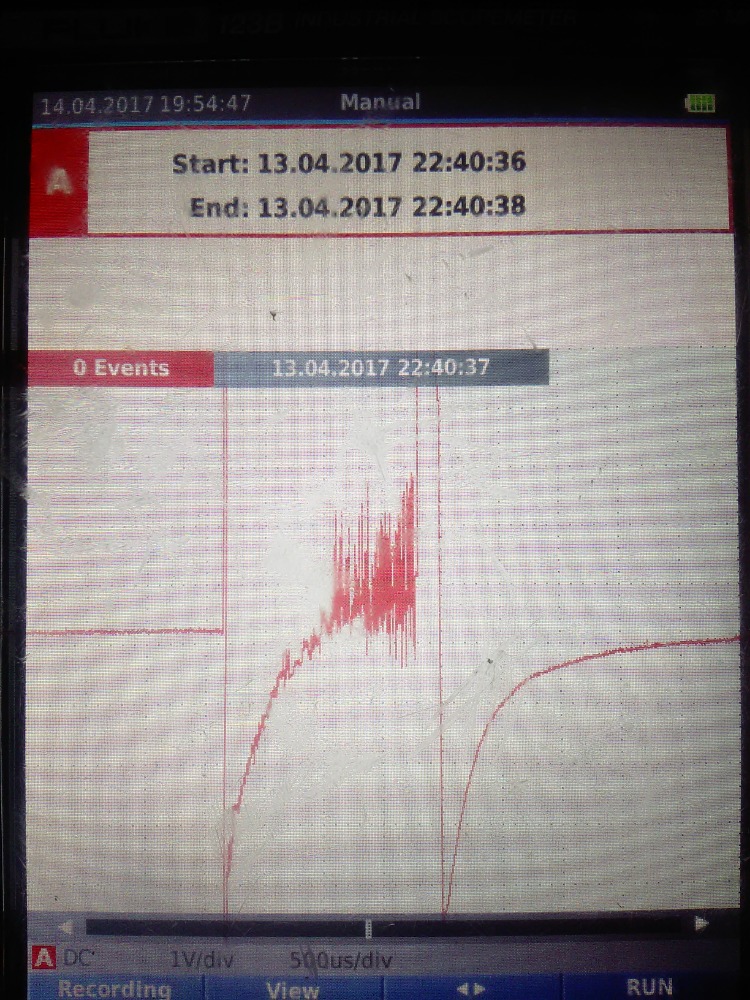

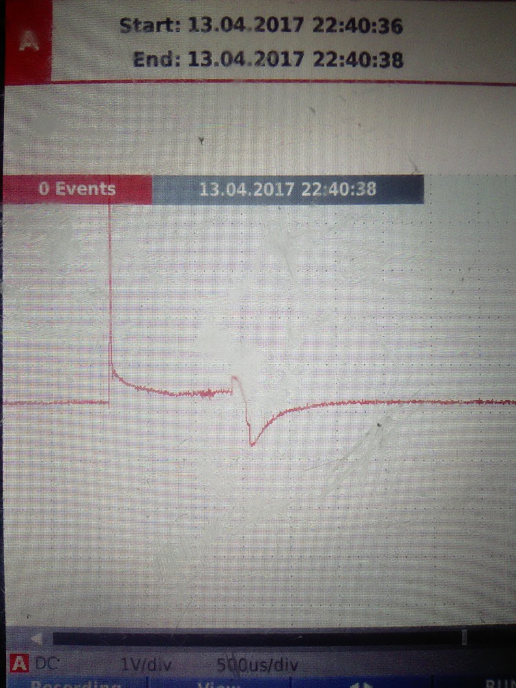

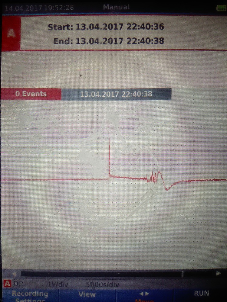

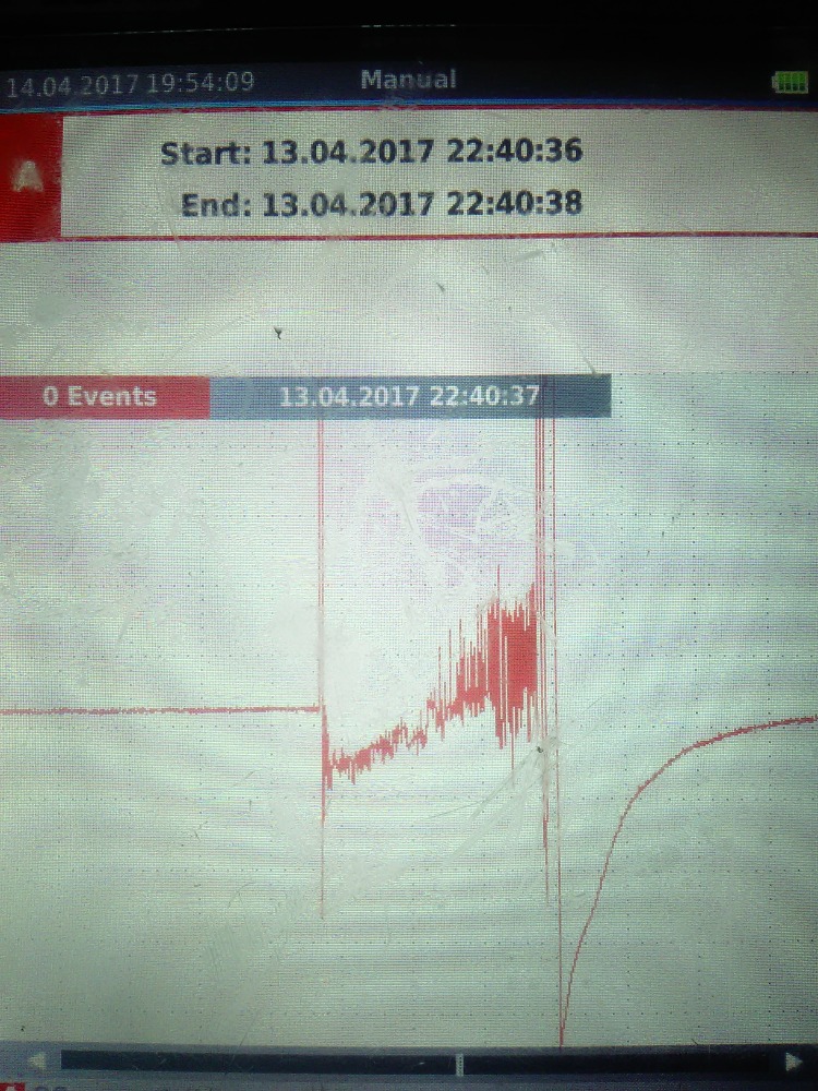

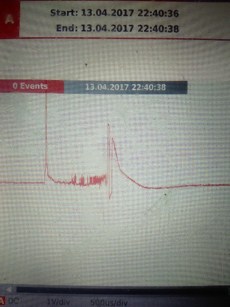

7 years 5 months ago - 7 years 5 months ago #29771 by guafa
Replied by guafa on topic 93 Ford econoline van 5.8L misfire
Today updates
I cheked TPS voltage. It went smoothly between 0.68v to 4.3v, which i think is good. It is out of range (dtc 121).
KOER showed me (dtc 121 again) and (dtc 327)
Fourth question. Dtc 327 is also related to EGR signal?
I also checked for secondary ignition and non conclusive waveforms were found (see screenshoots for the same cylinder #7)
Finally i checked for O2 sensor activity. Bias voltage (O2 sensor unplugged) was 0.43v. when engine running (O2 sensor plugged) voltage was steady at 0.56v (always, even when WOT). Heater was always ON (0.4v in heater ground wire and 12v on power wire).
Fifth question. Is this pcm designed to control at that voltage (0.56v)?
With this pcm/design i feel like trying to talk with a crying baby. You don't know if is hungry, sick or urinated. Thanks again for your help.
