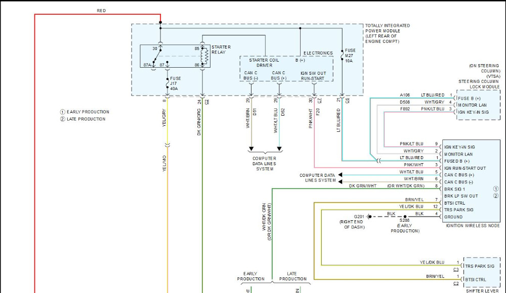

Hello,
Just purchased this vehicle, dove it home and started it a few times. Put vehicle in the garage and a couple hours later I go out an it doesn't start. The starter is clicking and thats it. I've checked all of the fuses and the relays all are good. New battery and a new starter, and still just get the clicking. Scanned for codes and found P0615. Did the Diagnostic Trouble code test procedures and found all was good but one. Test- Starter control circuit shorted to ground. the test ask if the resistance is below 100 ohm's. the meter showed 0.00 on all scales.
Any ideas on how to proceed with this one?
I get all my info from Alldata
7 years 5 months ago #29780 by Chad
Replied by Chad on topic 2009 Dodge Journey, Starter issues
While attempting to crank, and the starter is clicking, what voltage to you read on FUSE J17? If you see, near, battery voltage, what voltage to you read on the YEL/VIO wire, at the starter?

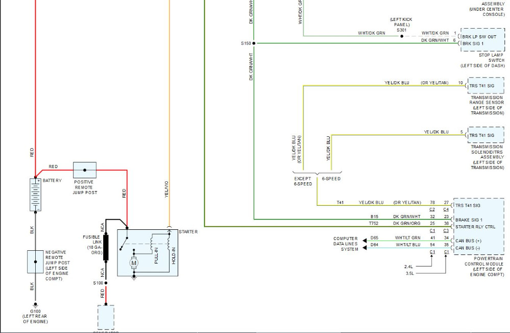

Have a buddy hold ignition in crank position make sure thick red cable has battery voltage to the stud on the starter and also make sure the ground on starter stays close to zero.
IF that checks good, connect multimeter to posts on solenoid and check for drop there: i.imgur.com/LDPGNai.jpg
High volts means bad solenoid contacts.

Hi Chad. I tested the fuse J17 and the voltage is, when cranking, 10.85 v. The voltage at the yellow/violet wire when cranking is .29 v.

7 years 5 months ago - 7 years 5 months ago #29796 by Chad
You have a bad spot in the yellow/violet. Probably green crusty corrosion. You may, or may, not be able to SEE it. A pin-hole in the wire coating can allow moisture, creating corrosion. You need to find the bad spot, or run a new wire. Somewhere, on the way to the starter, there is a dividing point between 10.85 v and .29v. This will be your corrosion point.
You can Pierce Probe the wire in a methodical manner, probing in the middle of the two reference points, and determining which direction you need to go. If you read 10.85 v, move closer to the starter and probe, again. If you read .29 v, move closer to the fuse and probe again.
You MUST take you voltage measurements while the circuit is loaded (starter clicking). If you test an UNLOADED circuit, the results will be inaccurate.

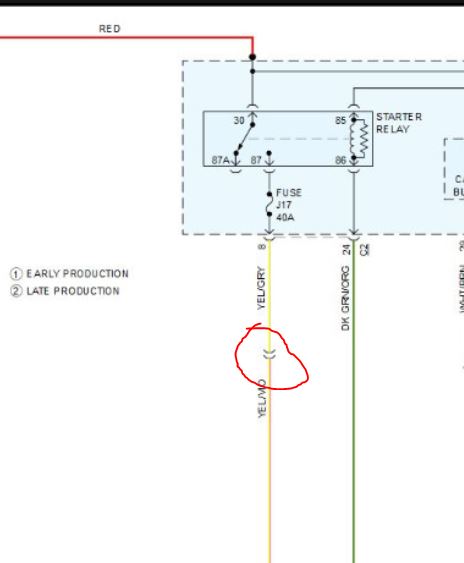

7 years 5 months ago - 7 years 5 months ago #29800 by Chad
This splice might be a good place to start, if you can find it.
