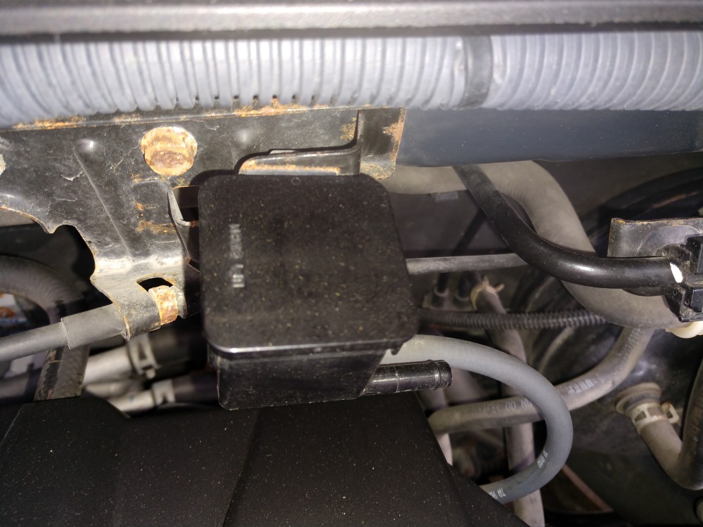

Thank you for the quick response. Looks like I'll be swapping out the sensor. I replaced the pipe and got the P0154 fault again. It's probably not related but can you tell me what this little black box is and if I need to determine what tube is missing and replace it?
7 years 5 months ago #29826
Actually, you're not missing anything! :silly: Pretty sure that's either the transmission breather, or the transfer case breather. One is that box, the other is by the throttle body, never can remember which is which.
Anyway, it's supposed to vent to atmosphere. As long as there's no fluid coming out, you're good.
