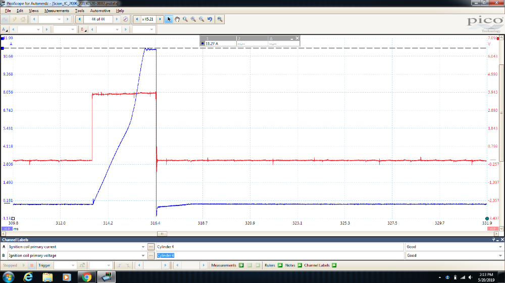

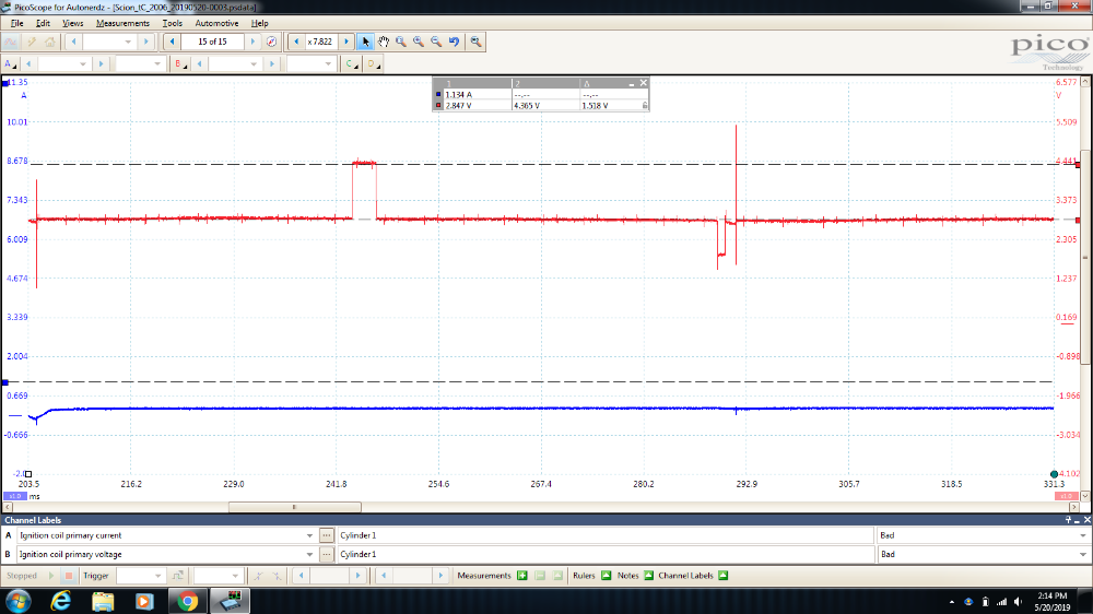

2006 Scion TC 2.4L 4cyl
Misfire on #1, no spark from coil, has injector pulse
Swapped coils, problem did not follow
Scoped IGT #1 cyl and found base voltage not at 0v instead it is at 2.8v and then goes to 4.3v when computer commands on.
Disconnected affected circuit (coil and pcm). Then put a light bulb on one end of the circuit and powered the other end of the circuit with my powerprobe. Bulb lights good on the IGT circuit. Checked all other circuits ok.
Attached some pico captures. Can someone lead me in the right direction. I am thinking the ECM is at fault at this time.

One more thing, when I unplug the connector from the affected cylinder. The wave form goes normal 0v-4v square wave. Plug in, back to 2.8-4.3v square wave.
7 years 5 months ago #29848 by jreardon
Replied by jreardon on topic 2006 Scion TC Misfire on #1
I wonder if current ramp for #1 coil might show difference compared to other coils. Maybe compare amp waveform moving #1 coil to good IGT driver.
  • chief eaglebear
  • chief eaglebear's Avatar
7 years 5 months ago #29849 by chief eaglebear
Replied by chief eaglebear on topic 2006 Scion TC Misfire on #1
not to experienced but that turn on oscillaition doesn't look right nor does the ramp of the current looks like lazy driver
  • eliteautosolution
  • eliteautosolution's Avatar Topic Author
7 years 5 months ago #29851 by eliteautosolution
Replied by eliteautosolution on topic 2006 Scion TC Misfire on #1
I did do that, it was pretty much the same as a known good.
  • eliteautosolution
7 years 5 months ago #29852 by eliteautosolution
I think its safe to say it needs a computer. The circuit is so simple, 1 wire for IGT straight to the coil. The coil was switched around and the problem didn't follow. Checked all 4 coil circuits, good. I'm going to order a computer, thanks guys.
7 years 5 months ago #29853 by jreardon
Try leaving only #1 connected and see if signal returns to normal.

7 years 5 months ago #29888 by eliteautosolution
FIXED
Rechecked all the wiring to the coil. The ground and IGT wire was swapped on the connector. Called customer and asked them were they fooling around with the coils, and they said they just changed the plugs. Then a long pause.............customer finally said the wiring came out when they connected the coil back up. These problems I encounter seem to always be a customer inflicted issue. But another one in the books and I know I should have caught this yesterday.
