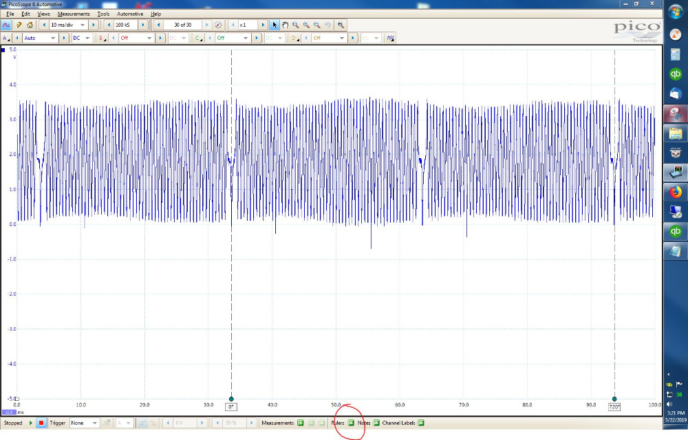

PICO SCOPE engine cycle grid overlay
Comments / Questions: i am new to scope been looking for crank angle overlay ,can not find it anywhere please advise to when i can
download overlays
download overlays

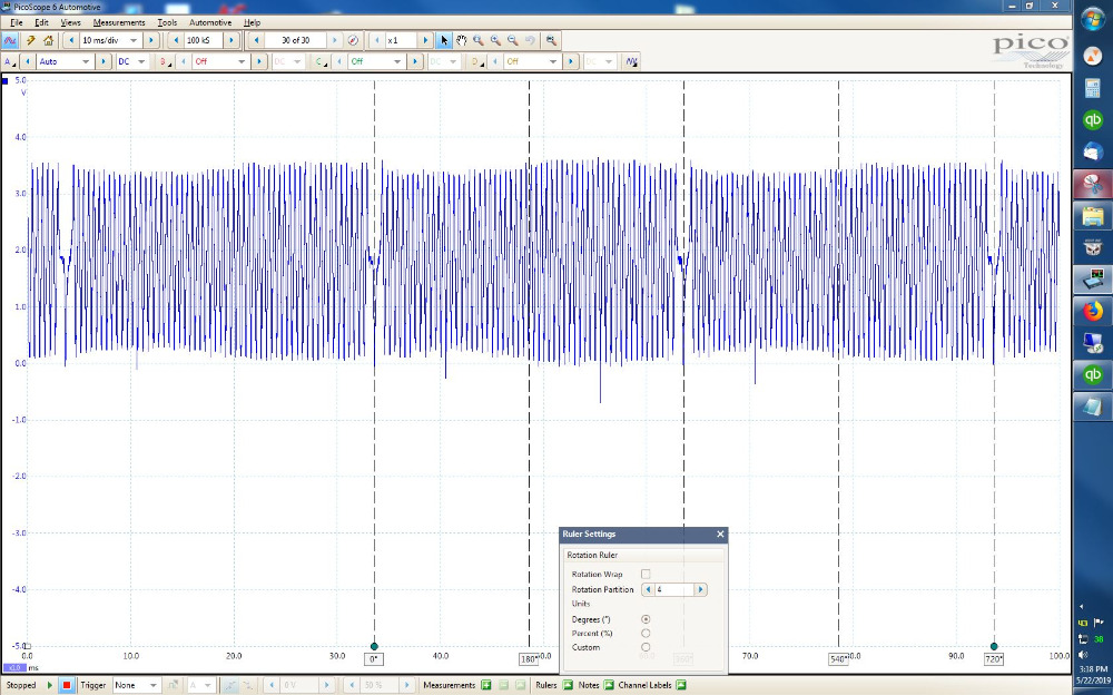

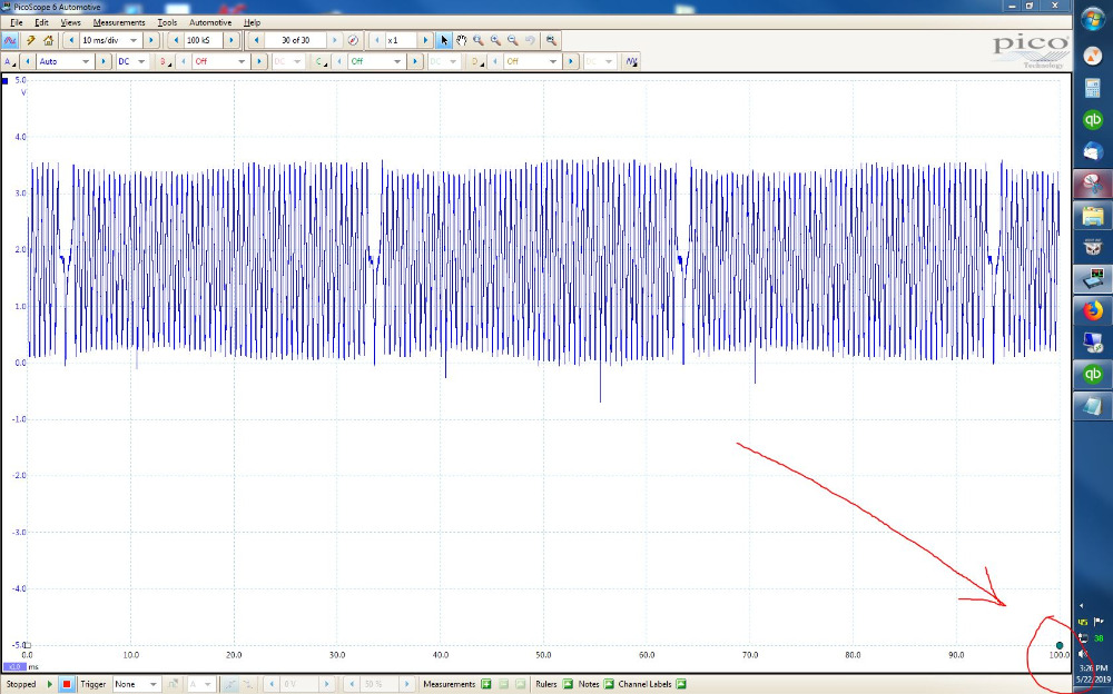

- Posts: 2223
7 years 5 months ago - 7 years 5 months ago #29949
Replied by Chad on topic pico scope overlays
The Pico Scope has a set of 720° cursors built into the software. Drag the blue dot, in the lower righ-hand corner, to place the 0° cursor. Then, drag the blue dot, again, to place the 720° cursor.
Then select how many partitions you want to divide the 720°.
