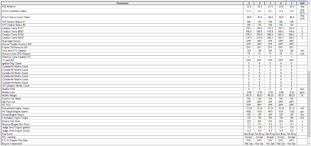

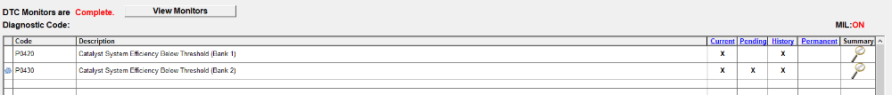

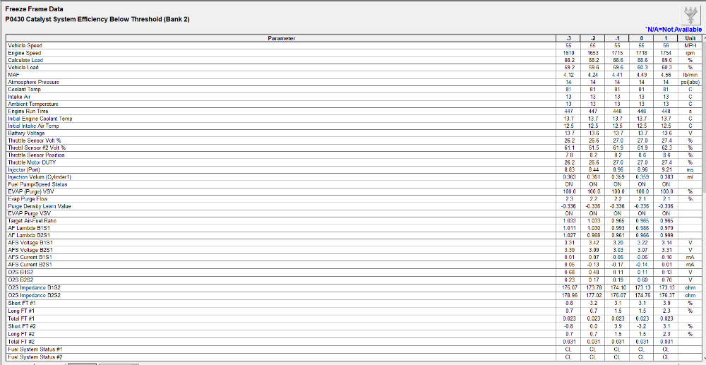

I have P0420 and P0430 in my Lexus RX400h (2008). I replaced MAF sensor already to brand new. The difference between cat temperature on both banks is more than 160C (320F). I have freeze frames when the code appears but can't see anything suspicious. The STFT is about +/- 4% and LTFT is about -1% on both banks. The engine temperature is 81C (is it not too low?) 177.8F. No other symptoms, the car drives smoothly no issues during acceleration, no rough idle. The front O2 sensors have amplitude +/- 3.5V and rear sensors I can't notice any behavior such 'copy' of the front sensor. The voltage drops in rear sensors to 0.1V sometimes and then the errors are thrown but can't glue in what conditions it happens. One thing noticed that when drive the car after night when it's cold then the errors are thrown just after 10 minutes drive. When I clear the codes and continue driving for example 200-300 miles then codes not appear during the same day. I tried different variations also tried using the same journey but no codes. But as I mentioned before early morning when the car is cold I drive on motorway and after 10 minutes drive even less the codes appears again.
Attached screenshots of the freeze frame.
Last edit: 7 years 5 months ago by SlyCom. Reason: Added pictures

SlyCom wrote: The difference between cat temperature on both banks is more than 160C (320F).
I think you're looking at a difference in temperatures between the upstream and downstream sensors? And not bank-to-bank.
Anyway, I dunno that I'd read too much into these PIDs. :silly: There's no exhaust temperature sensors, so these PIDs are calculated. If it helps, I checked a couple other Toyota/Lexus vehicles of similar years, and they all show the upstream sensors a few hundred degrees hotter than the downstreams.
It's very likely that you're completing the entry requirements for the Catalyst monitor when you drive the vehicle when it's been allowed to sit overnight. Once the engine is warmed up and you clear the codes, you may not complete the entry requirements for the rest of the day. ;)
You also end up resetting all the other monitors when you clear the codes, like the O2 Sensor and O2 Sensor Heater. It's my experience that Toyota/Lexus products are very specific about when and how they complete the O2 Sensor monitor - and the PCM is likely programmed not to complete the Catalyst monitor until the O2 Sensor monitor passes. Make sense?
Unfortunately, I gotta agree with cj1, it sound like your cats are done. :( Because you know your trims are good, there's only a few checks left. Make sure your engine isn't burning oil (unlikely), and make sure there's no exhaust leaks ahead of the downstream sensors. I see no TSBs related to cat codes on BBB Industries.
It may be worth a call to your local Lexus dealer? Hybrid vehicles like this sometimes have extended emissions warranties that'll cover cats. Worst thing that happens is they tell you no! :silly:
