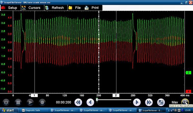

1st capture both sides of the crank sensor. I thought this was a bad sensor so replaced it.
To be honest it may of been a badly connected test pin. It was hard to get access to the CKP plug
2nd pic is new sensor fitted

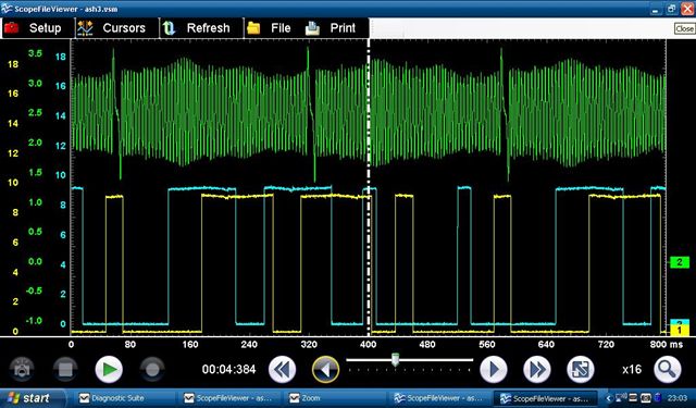

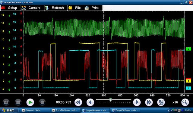

can anyone shed any light on why I would see this reading from the maf signal whilst cranking
File Attachment:
And not like this known good off a 4 cylinder Honda engine
File Attachment:
I’m confused at the 6 sets of 3 staggered peaks from the maf signal
Second image
Yellow trace - low amps clamp starter current
Red trace maf signal
Blue trace no 1 injector control
