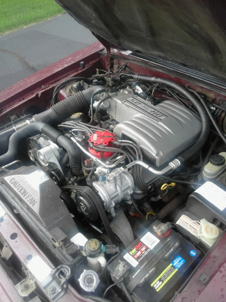

Hello,
I'm a new member. I'm reaching out to community for help. I have an intermittent misfire that occurs often across full range of rpm's. I could use help with direction to go next with the technical diagnosis. I've replaced numerous parts (see list below).
Vehicle: 1988 Ford Mustang GT/5.0L V8/5-speed manual/Air-conditioning, 170,000 original (well maintained) miles, owned since 1991.
Problem: Intermittent misfire that occurs often across wide range of rpm's. It is most noticeable driving in first gear just as you begin to let off the throttle. Then there is a sudden jerk. It acts as if the ignition momentarily cuts out. Also, in general I've noticed uneven acceleration. Sometime better than other times.
First, basics that were Verified/Checked:
Fuel pressure
Battery voltage
Good clean fuel
Clean air filter & air intake
Parts replaces:
Ignition-
Coil
Spark plugs & all new spark-plug wires
Cap & rotor
All new distributor w/pickup
Ignition control module (component tested and verified/passed...AND to be absolutely sure I replaced it with a new one)
Fuel-
Fuel injectors (8ea)
Fuel pressure regulator
Fuel filter
Sensors-
MAP (located on firewall)
TPS
IAC (idle air control)
EGR
O2 (new Bosch both left & right)
New computer (EEC-IV), swapped with a new one and misfire still remains
Various temp sensors (gauge, coolant, etc)
...and by the way, there is no MAF on this vehicle.
I've been working on this problem for a couple years. As you can see, I've tried many things already. I'd like to get some feedback before I try anything new. Please feel free to comment. Thanks!
Tom

The ignition coil connector on the Fox Body cars tend to have big sloppy female pins.
You still have the plastic cover over yours. Nice B)
Try tugging and wiggling that connector to see if you can induce the misfire.
You may know that the "salt & pepper" connectors behind the plenum can be stressed when engine torques, but I don't believe anything in those circuits is spark related.
