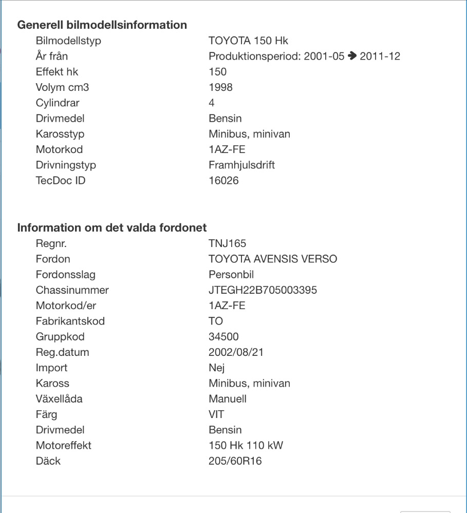

The tech doc ID for my car is 16026 if anyone can help me check the ohms of A/F sensor this car should use.

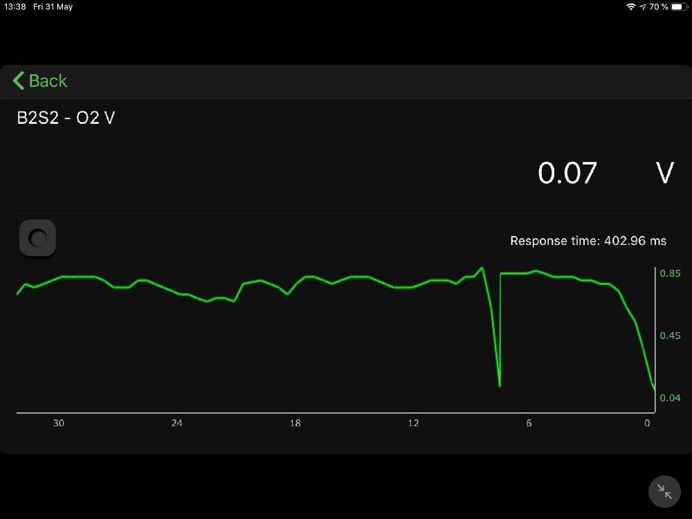

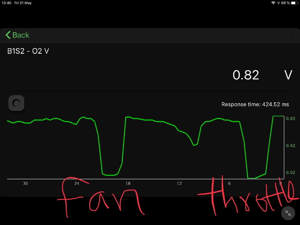

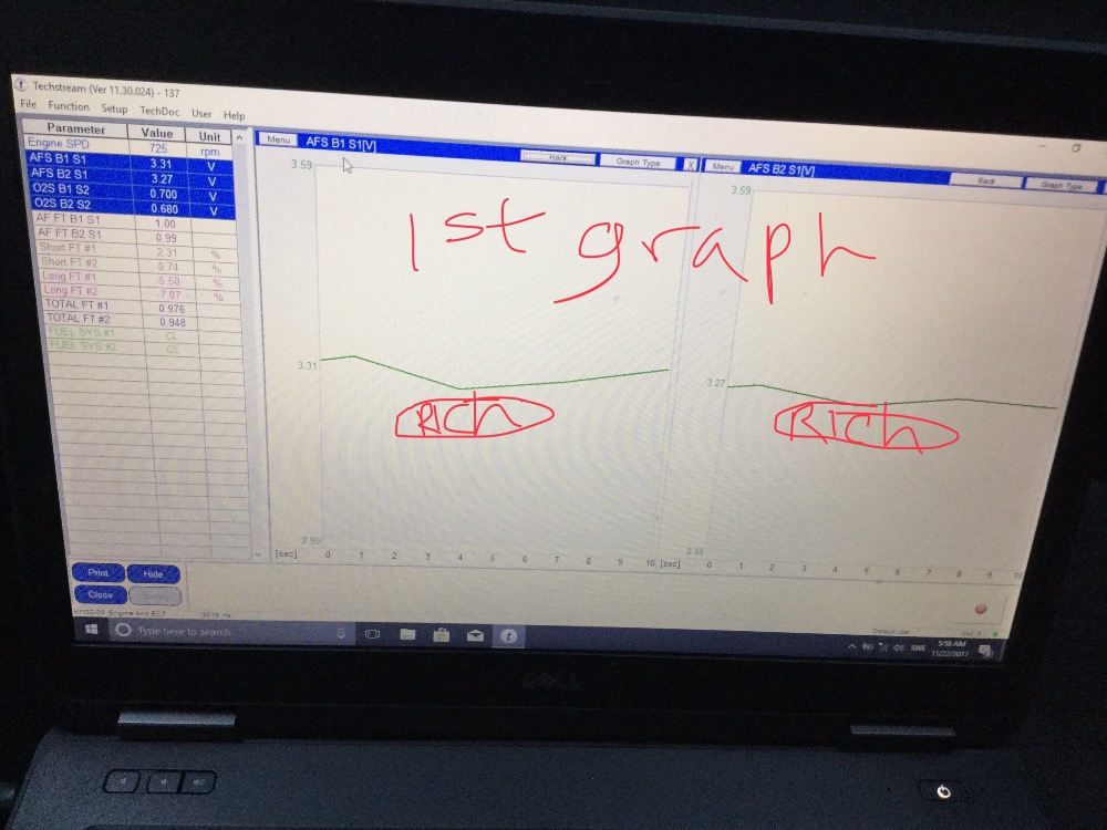

>>When I used OBD WiFi to check Bank1Sensor2 and Bank 2 sensor2, the waveform was steady at 0.7v to 0.9v but dropped when the fan kicked in and when I rev the engine. Are these the downstream sensors? The waveform and voltage drop only happens when the fan kicks in or when I rev the engine. I will try to use the OBD WiFi to get screenshots for waveform of Bank1Sensor1 and Bank2Sensor1

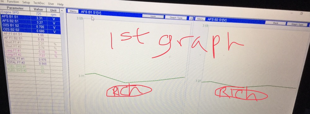

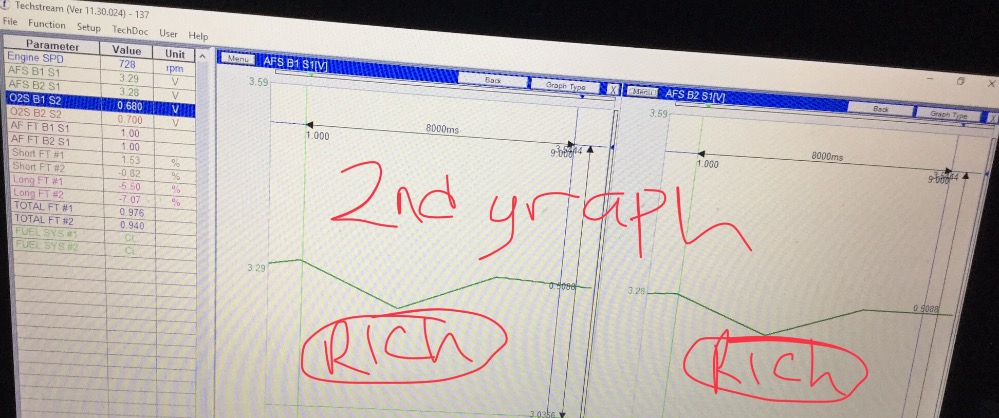

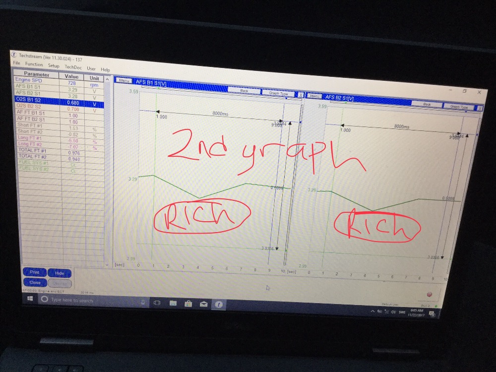

>>When I used techstream, the voltage dropped down from 3.29v for Bank1Sensor1 and Bank2Sensor1 upstream sensors...see attached pix. I don’t have an oscilloscope to graph a waveform as shown I the service bulletin, but using the techstream the voltage drop of the upstream sensors signify a rich condition.
Verso is not listed as needing a ECU software upgrade, only previa and RAV4. The dealership wants me to replace ECU and CAT which I do not believe.
How do I fix this rich condition without being a part changer.

babajis2010 wrote: but I am experiencing driveability, poor engine performance and loss of power (pls note the engine idles fine, no stalling, everything looks fine with the engine except that the car doesn’t move as it should on the highway
I think you need to worry about you Cat, more than your O2 sensors. You are describing the classic symptoms of a restricted exhaust.
and if I force it by driving over 120km, the CAT becomes hot and makes this frying sound when I park)
:woohoo: This is, definitely, not normal.
I would Is it safe to conclude that the recommendation by Toyota to change ECU and CAT does not apply in my case since I have engine loss of power.
Not, necessarily. I'm not ready to call an ECU, yet. But, it certainly doesn't sound good for the CAT.
P0420 and P0430 are efficiency codes. Basically, the CAT is not absorbing oxygen. The exhaust that enters the CAT is the same as the exhaust exiting the CAT. This is a condition that, generally, requires a new CAT. However, this will not cause a drivability issue.
But,
I think it might be safe to say the CAT has melted down, and you have exhaust restriction. THIS will cause a drivability problem and require a new CAT, too. If you can, remove the UPSTREAM O² sensor and install a pressure gauge. A back pressure of more than 2 psi, at 2000 RPM is a concern. More than 3 psi is a problem.
