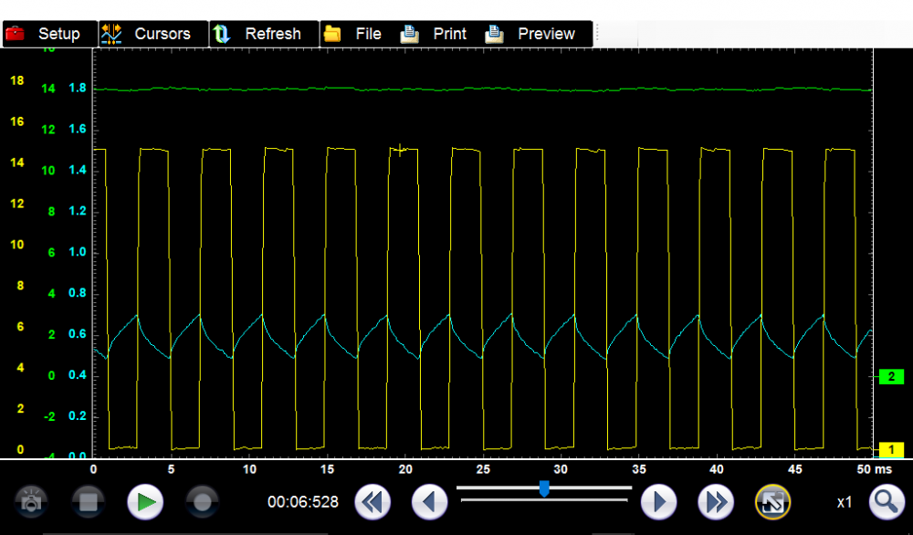

This image is off a Vauxhall but same principal

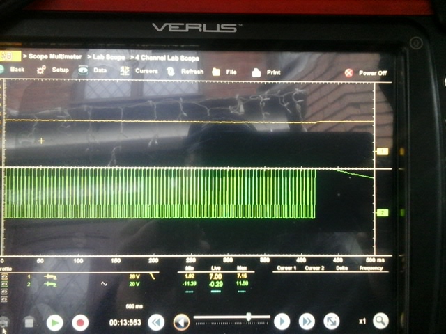

I've uploaded a scope pic but not all the screen is showing , i must get a better frame size . Not the best scope set up. I'm still learning it.

9 years 10 months ago - 9 years 10 months ago #4024 by steve
Replied by steve on topic Passive waveform modulation ? Trying again
paul.simpson wrote: My fault code mention imv malfunction so my concern was why it showed 7 volts, even if it was a known good competent should read 12v ?
That would be a concern but looking at the image you have 11 volts on the control wire so it doesn't make sense
I would double check but only use one channel at at time as if you cross the pins by double probing you can damage the ecu
Also in the image it's looks like your ac coupled on the second channel
Try just using one channel on the control wire, drop your time base to 50ms to give more detail, use a 20v scale and make sure it's not ac coupled
The top of the square wave will show you the source voltage and will also be on the maximum voltage reading below
