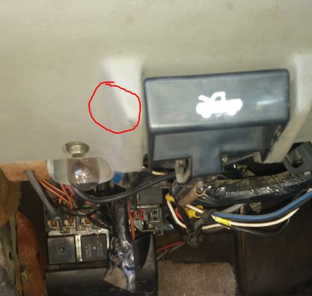

Hey guys,
Mitchell says it is "under left side of dash near convenience center". I have stuck my head way under dash and for the life of me I cannot see it. Adding to the difficulty, sometimes the flasher is a rectangular box, sometimes it is the metal cylindrical variety. I can find hide nor hair of either. I have tried to trace the brown wire from the steering column back to the flasher but it disappears into a harness and goes who knows where. I'd really like to get my hazard flashers working again. Any ideas guys?
Thanks, Pop

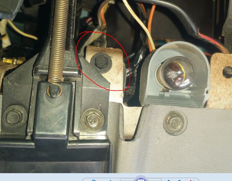

Between the hood release and the underdash light.
It is a round silver flasher. The bolt in this picture holds the "snap-in" bracket for the flasher.

THANK YOU!
I’ll have a look in the morning!

Thank you Chad! found it RIGHT where you said it would be.
You ROCK, Brother!
