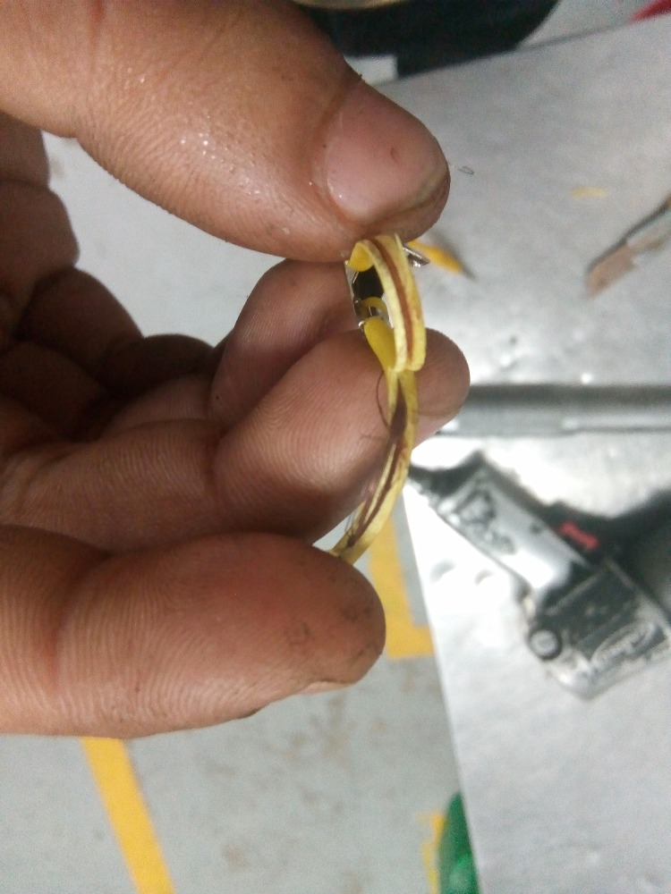

The reason I can't pull this bias on signal wire before is probably caused by my defective jumper wire. I use a different jumper the second time and it pulls the bias immediately. Then I decide to test my jumper for open and discover that it has a resistance of 1.4 Mega Ohms.

Just an update. Here is the jumper that I cut open. Most of the strands are brittle and the brown color that you see on the insulation is not the copper but rather the corrosion. Some parts are intact but mostly are very corroded.
