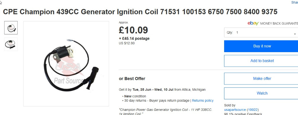

Hello!
I did not know where to put this topic so I will leave it here. I bought using this site my generator Champion Power Equipment 100296. I use it for different things on my farm. He stopped turning on after half a year. I have never worked with generators, can you suggest that you need to check with him for repair? Maybe there are some guides? On the Internet, nothing normal could find.

I never worked on a generator before but I found this wiring diagram in the manual and I see it has a starter. Does it crank? What was the last sound it made?

Hi sr,
I know nothing about generator, but.
Does it have carburetor?
Is there spark?
Is there spark?

What happens when you attempt to start it?

I believe the VFO allows it to supply 120 and 220/240 power.

Looks like a flywheel magneto to me similar to Briggs and Stratton lawnmower engine.
The flywheel of the engine has magnets in it that generate the electricity in the coil primary and also the ignition timing.
The on-off control basically is basically a switch that grounds the the primary windings control side l thus killing the spark.
If there is no spark it is more than possible the coil has kicked the bucket.
Simple enough job to change -- videos on Youtube same procedure as Briggs & Stratton use a thin strip of cardboard to set the gap between the horns of the coil and the flywheel.

Youtube Vid
