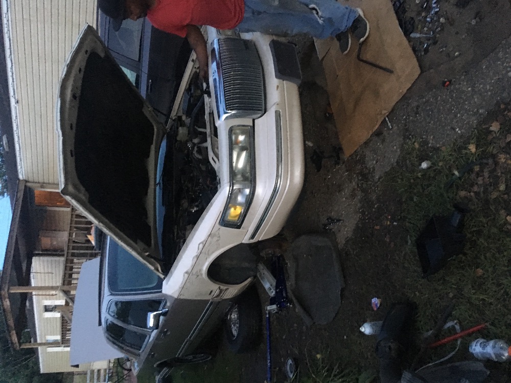

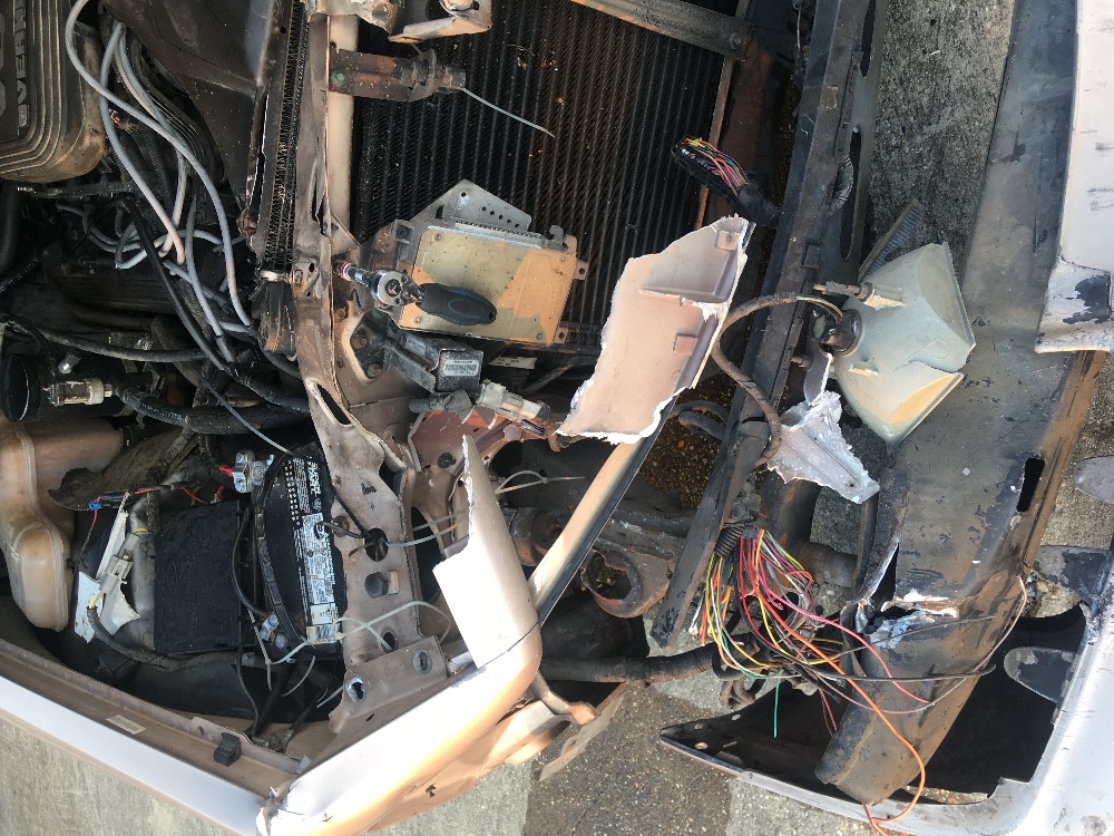

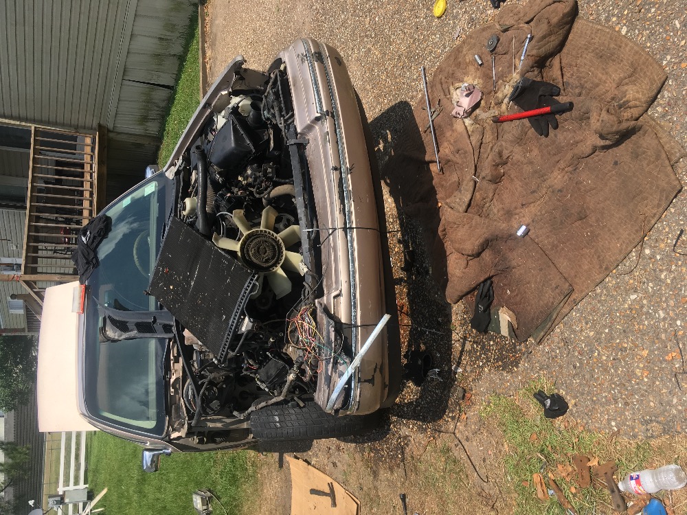

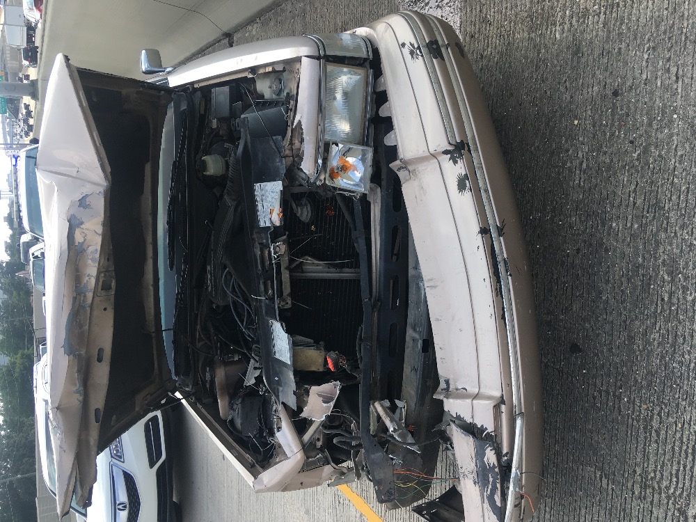

I got into an accident and rear-ended someone.at the impact my car stalled and wouldn’t start.so when I looked at my wrecked front end the wires in the harness,on the passenger side were split. it was maybe 30 wires that split apartment.before finding this I tried to crank it up to get on the side of the road but it would not start.i have put all of the broken wires back together,swapped the ignition module,pcm,and crankshaft sensor.i also have new ignition coils,spark plug wires,and a new fuel pump.I tried swapping relays no change,all fuses are good,and all connections have fire coming to them,but nothing is happening when I go to start.i don’t hear the fuel pump.i have swapped out the fuel inertia switch.i don’t know what else could be the issue,we tried connecting a computer scanner tool but no luck
