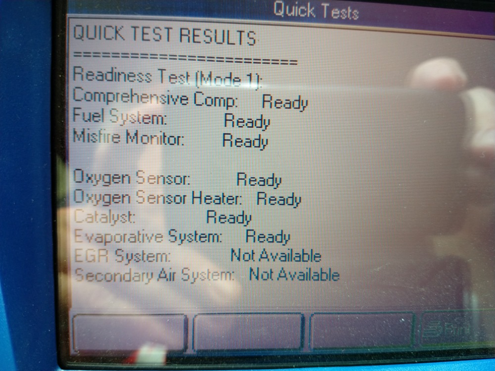

So when I fire up the Genisys, before it brings up the PIDs I'm tracking, it puts up a screen that shows a readiness test. It says Catalyst ---- Ready
Is that what you were referring to, Tyler?

Replied by Tyler on topic Subaru P0420
That's it! Your Catalyst monitor has passed at least once, which is good news.
Did the scan data show a steady downstream O2 sensor reading?
If you want to be 200% sure about your new cat, you can clear the codes and recheck the monitor status. Should say something like 'Not Ready' or 'Incomplete'. Drive it some more and get the Catalyst to complete again. If it'll complete consistently, you're probably good to go.

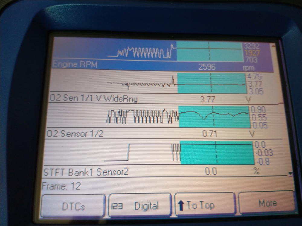

Replied by tmcquinn on topic Subaru P0420
The downstream O2 is a LOT flatter when a steady RPM is held. There are some variations but I ran the same PIDs on my 2012 Impreza with 55,000 miles and it's not perfectly flat there either.
I will try the reset and have it do another readiness test soon.

7 years 4 months ago #31385
Lookin' good.
Like you saw, it'll never be a total flat line.
Does that STFT Bank 1 Sensor 2 PID ever do much? I ask because I'm pretty sure the Snap-On has that same PID under a different name. :silly:
No, STFT B1S2 is the result of me picking the wrong PID. There's one short term and one long term fuel trim on this 4 cylinder.
