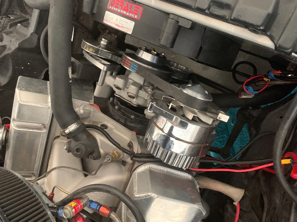

I have 454ci big block Chevy overheating. Tried new pump, timing, 3 row aluminum radiator, electric fan pulling 3300cfm of air. Can’t figure out the issue. Keeps climbing past the setting of the thermostat, which is 180. This is for my personal vehicle. 1986 Buick Regal, weekend car. Thanks for any help. By the way any recommendations on a racing shop near me, Brooksville and Spring Hill area of Florida. Thanks

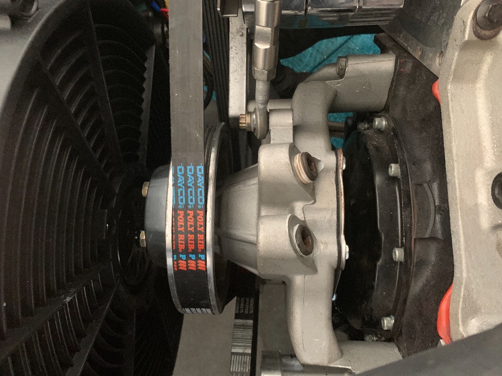

The bypass cooling, I don’t have any cooling hoses to the water pump except the upper and lower hoses Andy. Can you send me a picture of that bypass hookup. Can’t picture it in my mind.

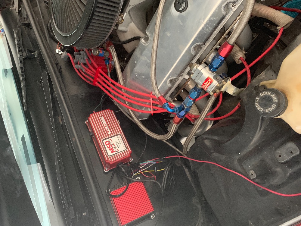

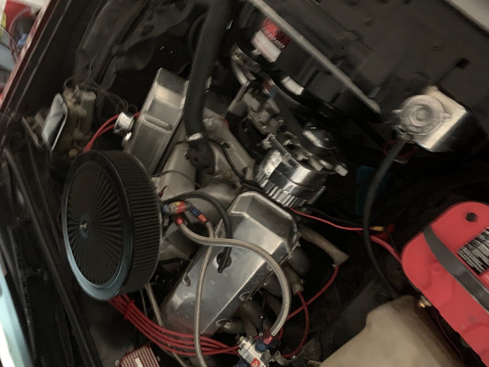

Andy I don’t have any hoses going to the heater. Look at the pictures. Is there anything wrong with this setup?
