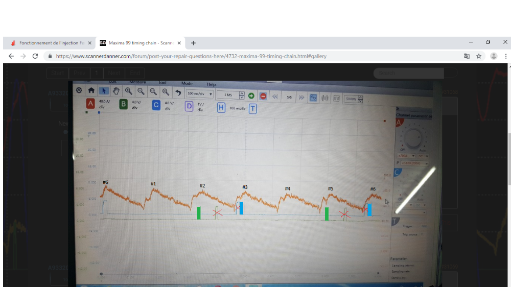

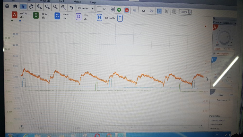

I work in maxima 1999 615000km
I replace timing chain on it
But it now misfire and not acclater
I do battery current with cly # 3 and cly #6
Code i have knock sensor
Plz chack for me if timing is ok

It is v6 3000 cc
7 years 4 months ago #31070
Replied by Tyler on topic Maxima 99 timing chain
Is the blue trace on cylinder #3 ignition coil? And the green trace on #6 coil? If so, you still have a problem.
Based on the firing order, it would appear your problem is with bank two. No compression, or close to it. Can't say if it's timing to a certainty. But, it's a strong possibility. Cylinder leakage is another.
What's the repair history on this one?

Soory my green trace is cly #5 and blue is cly# 6
Replace timing and oil seal
Tow time replace the timing chain due to not fix as per mark

Hi everyone.
I don´t know this engine but according to "mr google" all nissan V6 engines have the same firing order (123456), right?
According to this firing order graph should look like attached image.
I'm not completely sure why in blue trace there is an advance in time (maybe pcm trying to give more time for combustion?)
Cheers.
Cheers.

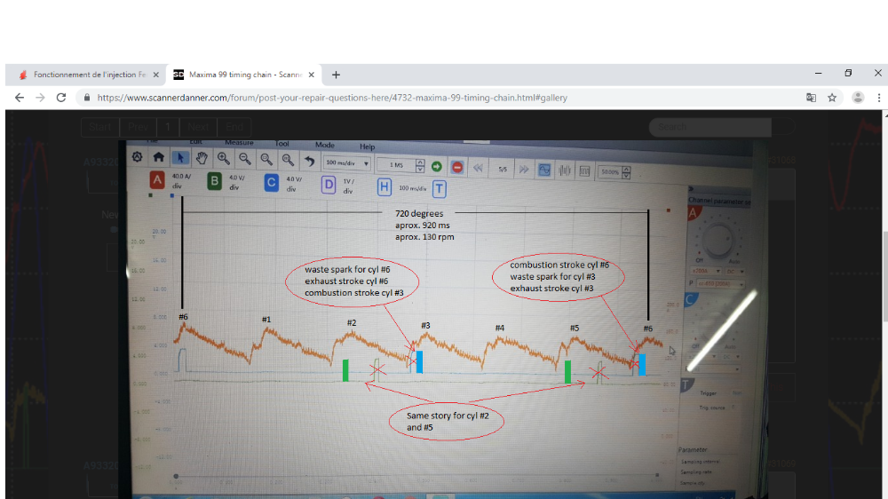

It should look like this I think.

Hi guys,
Is it a waste spark?
How many coils does it have?
I think if it has 3 coils, is like i showed. If it has 6 coils is like jreardon showed)
- guafa
- Posts: 477
- Thank you received: 80
7 years 4 months ago #31102
by guafa
Replied by guafa on topic Maxima 99 timing chain
in case this is a waste spark ignition system, this is what i see.
Awaiting confirmation. Regards
7 years 4 months ago #31106
It's a COP system.
I misspoke earlier. That relative compression waveform shows little or no compression on bank one. My mistake. :blush:
Did the engine run well prior to chain replacement? If so, it's likely this problem was installed.

7 years 4 months ago #31128
by A93320336@gmail.com
Replied by A93320336@gmail.com on topic Maxima 99 timing chain
It is cop sytem have 6 coil
No compration on bank one and 180 in bank 2
