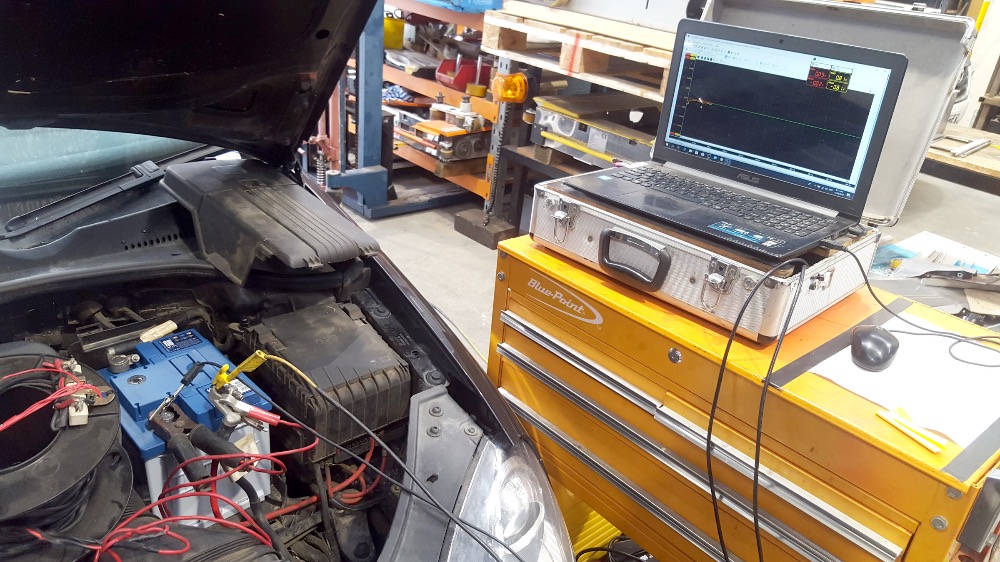

7 years 4 months ago - 7 years 4 months ago #31155 by Desmond6004
Replied by Desmond6004 on topic 2006 Cadillac dts battery drain
Betterway52 wrote: I have plenty of tools. I will use the ammeter and also put the low amp probe on the scope and measure it that way also.
If you have an oscilloscope my method is to put a coil of wire in series with battery ground and measure the voltage drop across it with the scope. Disconnect battery ground, place the wire from battery negative to ground and measure voltage drop from the battery post to chassis ground.
Then I use a small accurate clamp meter to see what the voltage drop equates to. Some people use a 1 ohm resistor then 1v on the scope is 1 amp - but if the current draw is quite high the voltage drop gets too low for some systems to work properly - which is why I prefer a roll of thin wire.
Then I leave the scope on 20000 second recorder and watch the voltage change over time.
Before doing any of that I will have done a full system scan to check for faults. After an hour of watching the scope I'll do another full system scan with the ignition still off - then I find out what modules are still awake and check their live data to see if there is anything out of place - a Porsche once had "glove box" marked as "open" when it was actually closed, which kept 5 modules awake.

7 years 4 months ago #31157 by Desmond6004
I decided to do a blog on the subject because I get to look at a lot of current drain problems www.springbokphotography.com/autoelectri...nosing-battery-drain
