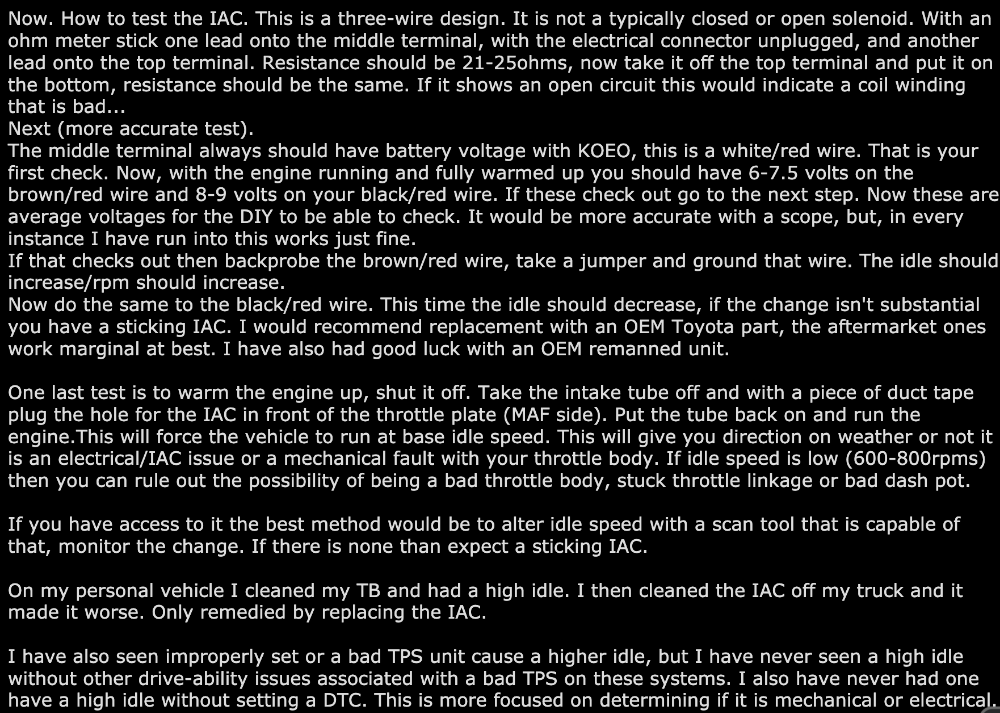

- Read up on IAC valve Diagnosis - found this:
www.yotatech.com/forums/f4/5vzfe-how-dia...ests-iac-etc-295444/
- Pretty much followed it step by step and got this:
- TPS 11.6%
- Resistance test was good ~22.5 ohms
- KOEO middle wire got battery voltage
- This is where things became different. Engine @ operating temp (184* steady) top wire received 0 V and lowest wire received 12.4 V
- Unplugged IAC and rpm dropped to 1050
- Grounded out upper IAC wire and no change
- Grounded out lower IAC wire and rpm dropped to 1050
- Duct taped over IAC opening on MAF side and engine barely ran at like 2-300 rpm until my cheap harbor freight duct tape tore and rpm went back up to what I assumed would be 1600+ but I got scared my engine ate the duct tape and I cut the ignition. Luckily it just tore a hole / flap and nothing went down into the IAC valve port.
