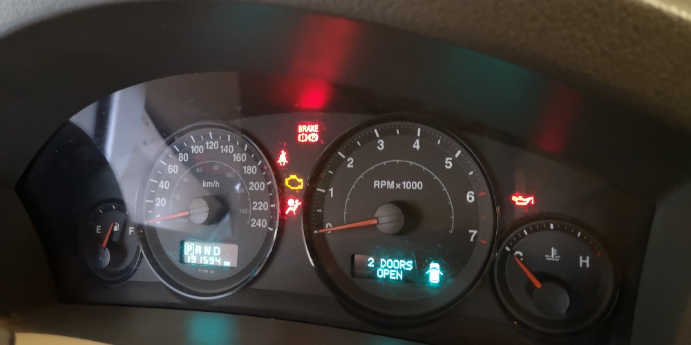

This jeep was brought to me today. owner mentioned that when driving; he would turn on his AC and after a while it would turn off by itself while at the same time the airbag and OCS light (passenger airbag "off" position); AC will resume working as soon as Airbag/OCS light disappears. He also mentioned that a mechanic replaced the ignition module recently but the problem still persisted.

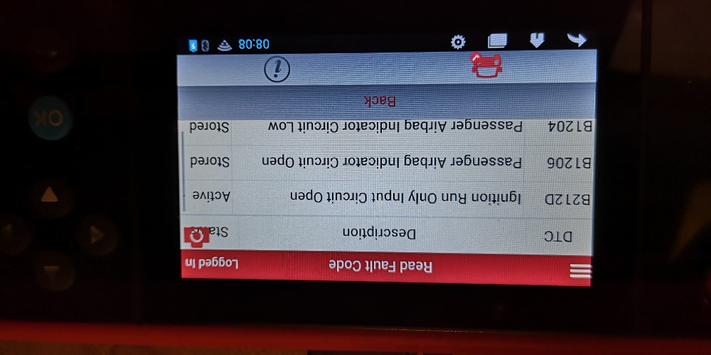

Initial scan showed:
1. B212D - ignition run only input circuit open
2. B1206 - Passenger airbag indicator circuit open
3. B1204 - Passenger airbag indicator circuit low

Just the air conditioning turns off and airbag light come on? Or the vehicle turns off?

yes, AC turns off and airbag lights turn on

"B212D - ignition run only input circuit open" The set condition for this is telling. So somewhere between the Run Relay and the Occupant Restraint Controller, there's a voltage drop to below 6 volts.
Further diagnosis required. I'm going to guess the run relay (in junction block) has bad contacts, fuse 10 has bad contacts, or wiring problem through the upper switch bank (what is that?) to the orc (occupant restraint controller).
Get this fault to stay (easier said than done right? ) and use your multi meter to find this voltage drop between the wires to zone in to the section of wire or component.

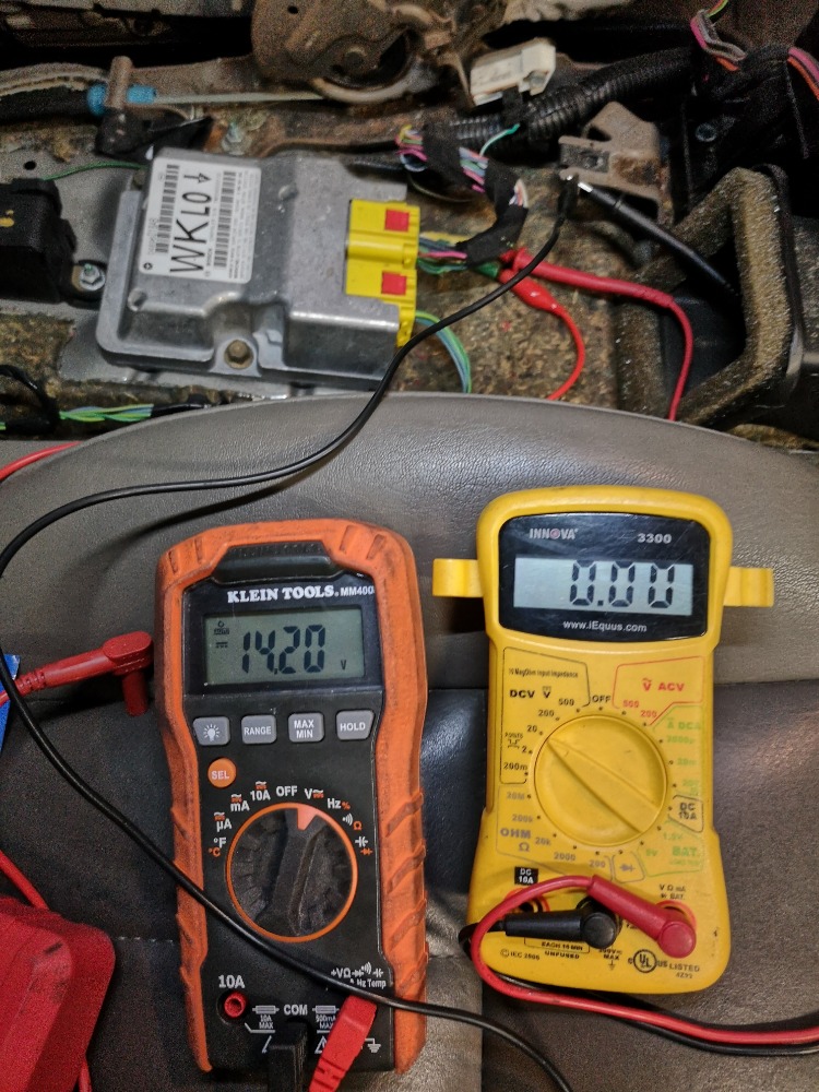

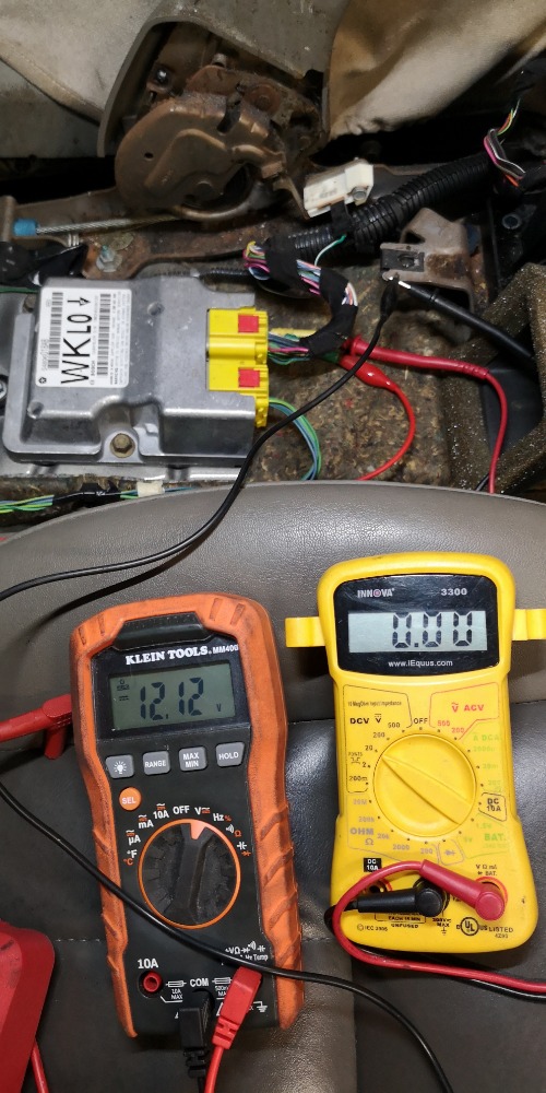

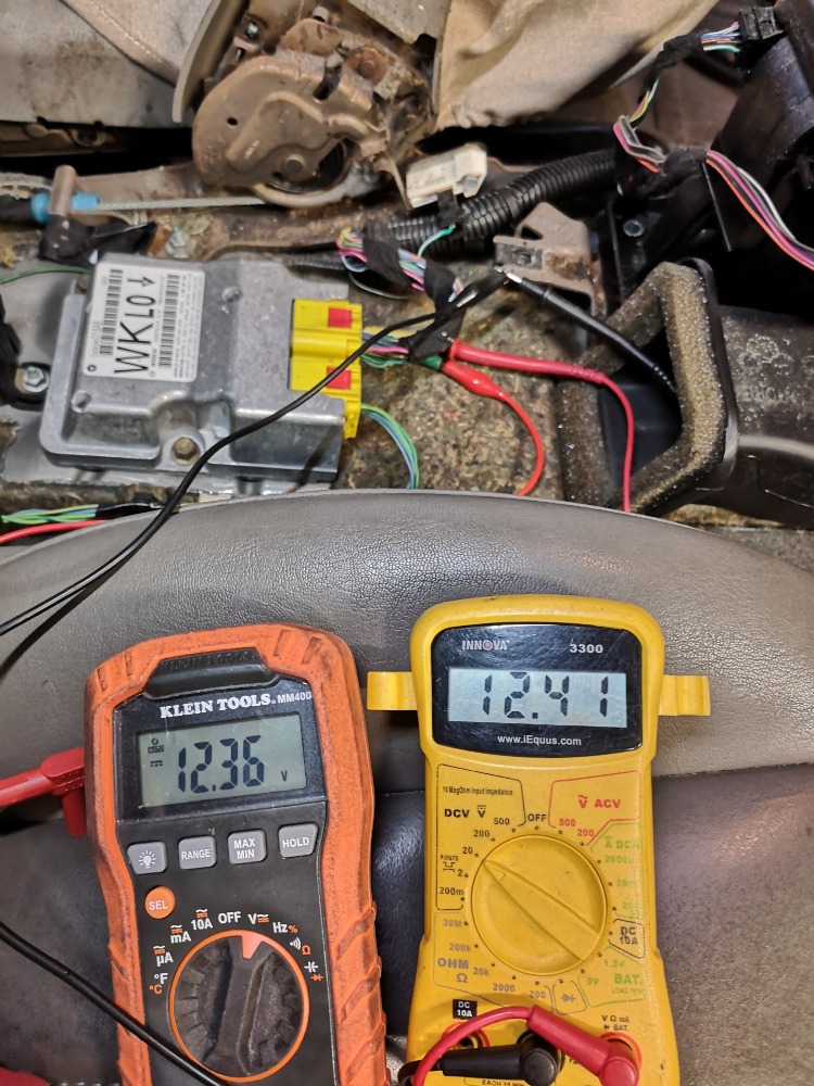

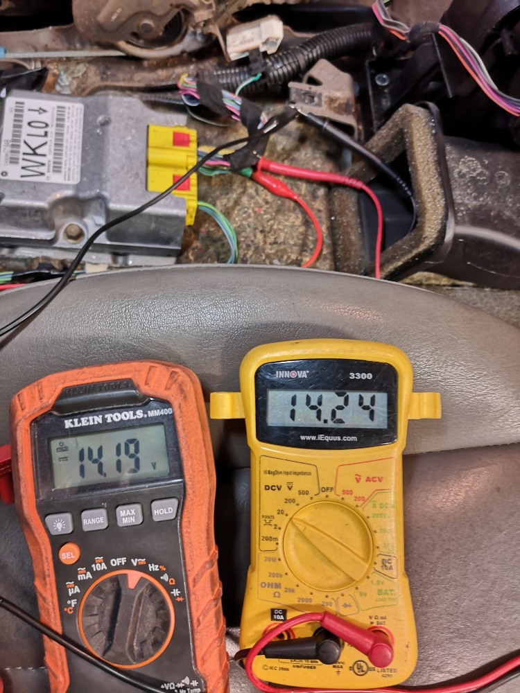

7 years 3 months ago #31824 by robert.lesaca
Replied by robert.lesaca on topic 2006 Jeep Grand Cherokee Laredo 3.7L
hello...sorry for the late posting. owner finally brought is jeep to my place. after taking out center console exposing the ORC, I probed pin # 16 (fused ignition switch) and pin #24 (fused run-relay out put.
in the attach image, at KOEO, my red meter (for pin 16) and yellow meter (for pin 24) read battery voltage. at KOER, both meter read 14+ V and no airbag lights. i momentarily turned ignition off and put to run position, my red meter read 12V while my yellow meter read 0V and airbag lights on. KOEr, my red meter showed 14+ V while my yellow meter showed 0V and the airbag light lit.
so it seems pin 24/fused run-relay output is the problem is.

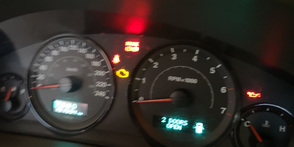

  • robert.lesaca
  • robert.lesaca's Avatar Topic Author
7 years 3 months ago - 7 years 3 months ago #31825 by robert.lesaca
i forgot to attach the DTC...notice B212D is active after the fused run-relay output voltage dropped to 0V
ooops sorry picture inverted
Last edit: 7 years 3 months ago by robert.lesaca.
7 years 3 months ago #31828 by jreardon
Replied by jreardon on topic 2006 Jeep Grand Cherokee Laredo 3.7L
robert.lesaca wrote: notice B212D is active after the fused run-relay output voltage dropped to 0V
Yup. I didn't realize until now but if you read the DTC description it says exactly what wire (is wire correct term, or more like circuit, i dunno) it is. For B212D it's F100, and for the others, B1206 and B1204, it's R106. Lol that's so nice, it right there in the image haha. It was so small I didn't even see it!

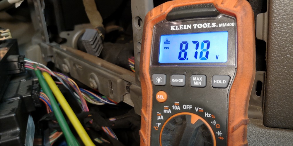

  • robert.lesaca
7 years 3 months ago #31836 by robert.lesaca
here is an image of R106 voltage when no airbag lights on. but as soon the light come on, voltage drops to almost 0V
7 years 3 months ago - 7 years 3 months ago #31840 by jreardon
Concerning F100, I would do voltage drop test KOEO and KOER. To rule out issue with ORC, jump fused jumper wire to power on that wire at pin 24 and see if the DTC goes away.
Last edit: 7 years 3 months ago by jreardon.
7 years 3 months ago - 7 years 3 months ago #31841 by jreardon
That voltage reading at pin24 alone rules out a blatant short to ground in the wire. Now to see if ORC is faulty or no, jump fused power to pin 24 at ORC and see if dtc clears up.
