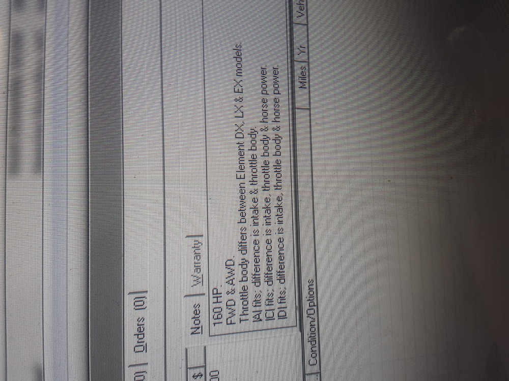

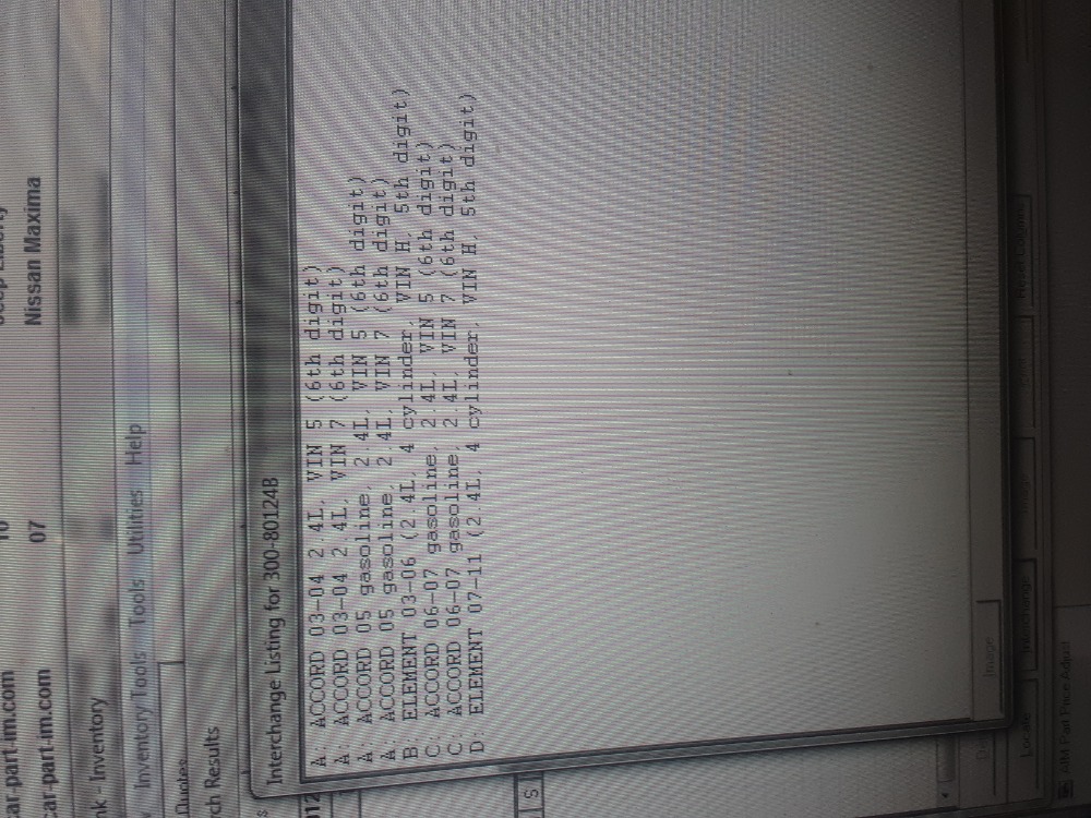

For what it's worth, I sat my happy butt in the greasy office chair just out of curiosity
The 05 element comes with. 300-80124B
A, C, & D fit as shown in notes. Difference is intake, throttle body and HP
Not justifying the botched job or anything like that. But if someone towed in that car for me to change the engine, that's all the information I would have to go by. No mention of injectors. Of course I wouldn't have charged them without making it right in the end.

6 years 11 months ago #34846
Replied by Noah on topic FIXED, 05 Honda Element 2.4 with P0172 Fuel Metering Too Rich
They must have gone outside of the interchange list and not transferred the parts to the new engine.
