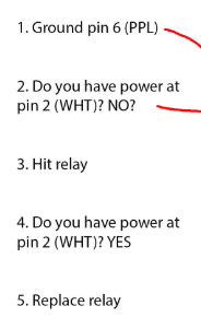

Working on a 2013 Crv and I am getting a C1850 . Looking for the test procedure for that code . Ant info welcomed
7 years 3 months ago - 7 years 3 months ago #31448 by jreardon
Replied by jreardon on topic test procedure for C1850
I see C1850-12 (stuck on) and C1850-14 (stuck off) (PDFs attached) and this quick google search simply says replace the relay:
Code:
https://honda.oemdtc.com/370/awd-indicator-is-on-with-dtc-c1850-14-2012-2014-honda-cr-v

Last edit: 7 years 3 months ago by jreardon. Reason: added my test procedure
7 years 3 months ago #31451 by Tyler
Replied by Tyler on topic test procedure for C1850
:lol: Flawless.
