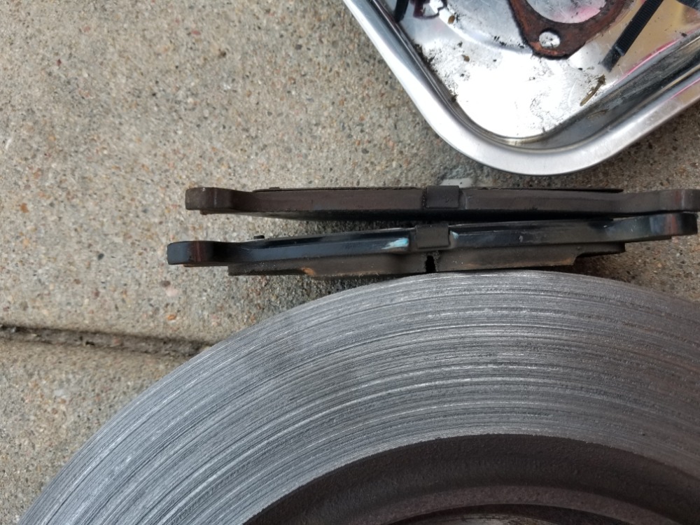

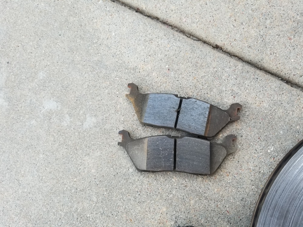

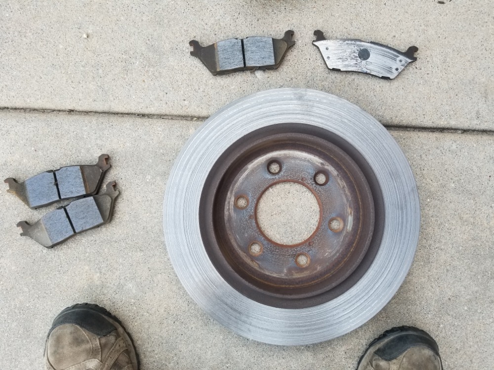

Ok so this is a one owner truck. With only 50k miles. The rear passenger side brake pad. The one on the inside were all the way down and tore up the rotor. The outside pad was same thickness as new pad.
And drivers side pads were evenly worn but again just small amount compared to new pads.
Has any heard of this I have been told it is because of traction control. But not sure I believe it.

The caliper pins are seized in the bracket. The caliper should move somewhat freely in the bracket. Check out South Main Auto Youtube channel. He has a lot of great brake job videos

Pins came right out. Looked great and moved with out issue. I checked the electric break motor and it seems to work fine. So not sure what caused it yet.

While it usually the caliper pins it is more than possible the pad it self is jamming in its' guide slots.

Yep. Did the pads come out easily? You shouldn’t have to force them out.

Did the piston compress easily after retracting the parking brake motor?
