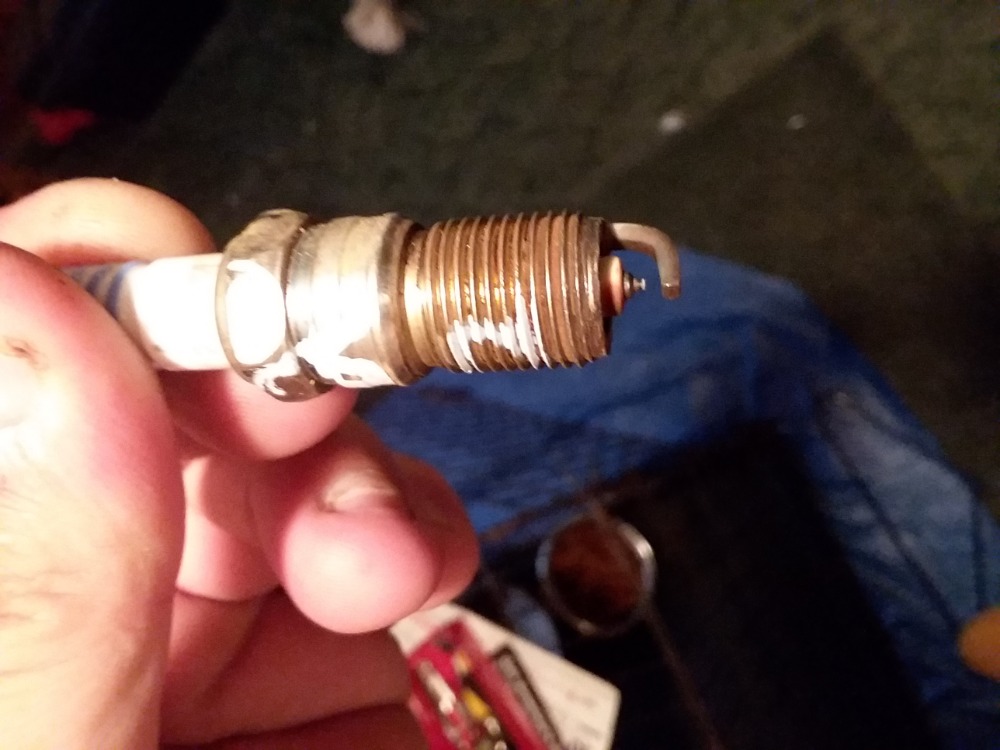

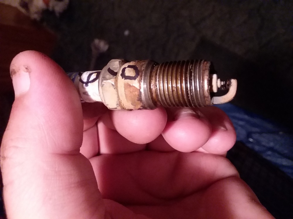

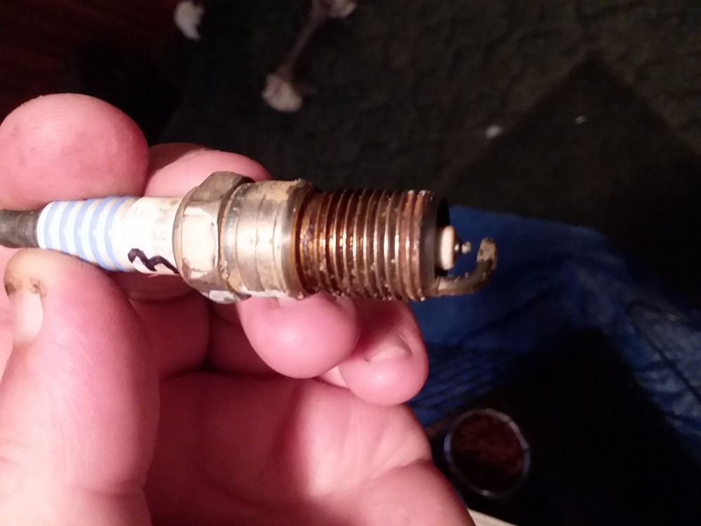

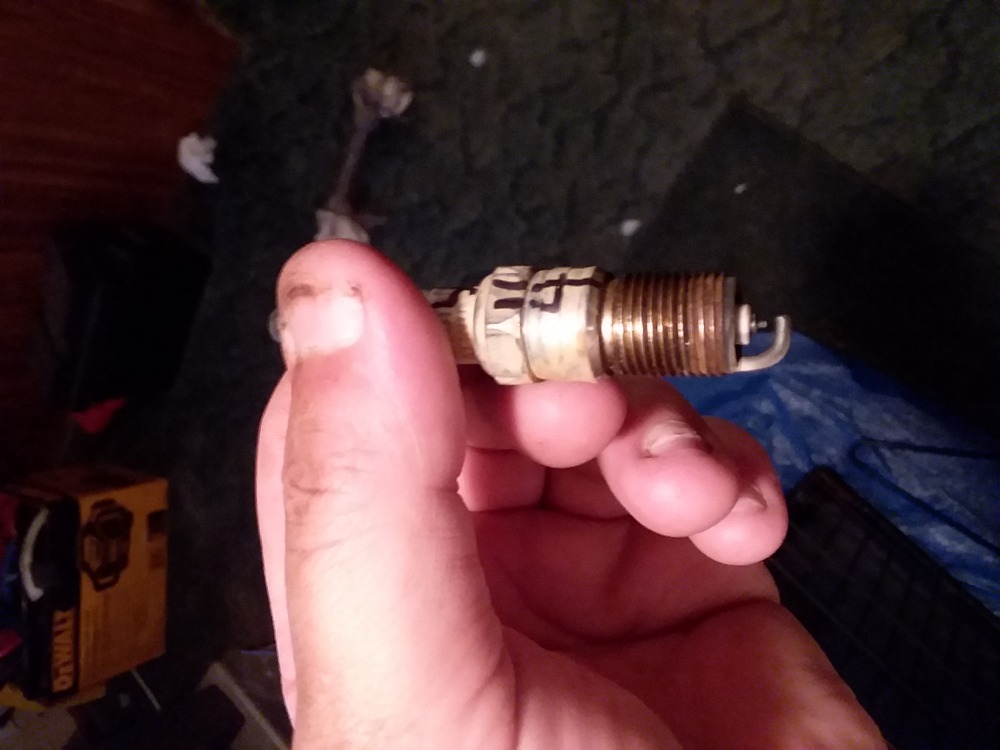

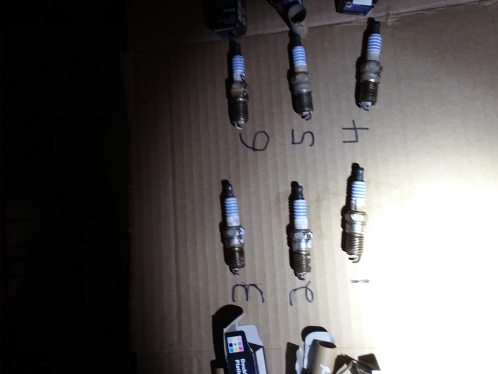

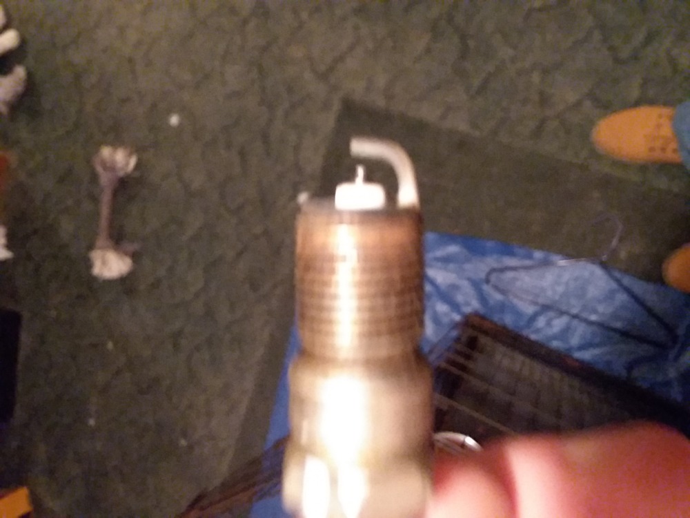

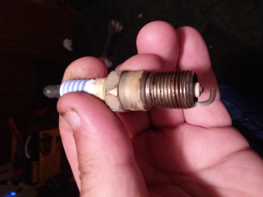

Sorry notifications are late to me. I just replaced drive side with Bosch double platinum plugs. Autozone and Ford said motorcraft double platinum but double platinum not an option in motorcraft. I just came inside from installing 3 left driver side cylinder 4,5,and 6 with Bosch.
This morning I installed flex exhaust pipe to connect my muffler (new) back to the rear tailpipe so its quieter.
I plan to do plugs 1, 2 and 3 later or tomorrow and replace wires again tomorrow. If it's not running great after this I will shoot cat converter with an infrared thermometer laser and if that goes good I will be leaning towards maybe it's the transmission
I think you said if not motorcraft I should leave plugs alone but I didn't get the notification. I'm labeling the old plugs so pics of old plugs can be likely tomorrow.

7 years 2 months ago #32939 by Floridaexplorer
All 6 plugs new again. Yesterday I almost averaged 17 mpg.
Still jerk or bucking, transmission or torque converter crossed my mind. On Google some one else suspected tc and it was cool pack. I asked Autozone yesterday and was told I have a single coil pack feeding all 6 cylinders, no rotor.
Thinking about buying mass airflow sensor cleaner next. I replaced wires last year but have not this week yet.

7 years 2 months ago #32978 by Floridaexplorer
Replaced coil pack and air filter was still bucking. Then I replaced wires and cleaned mass air flow sensor and driving home tonight It didn't buck so hoping finally fixed it.
