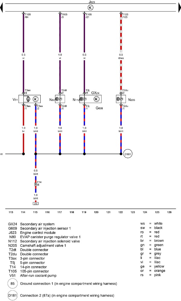

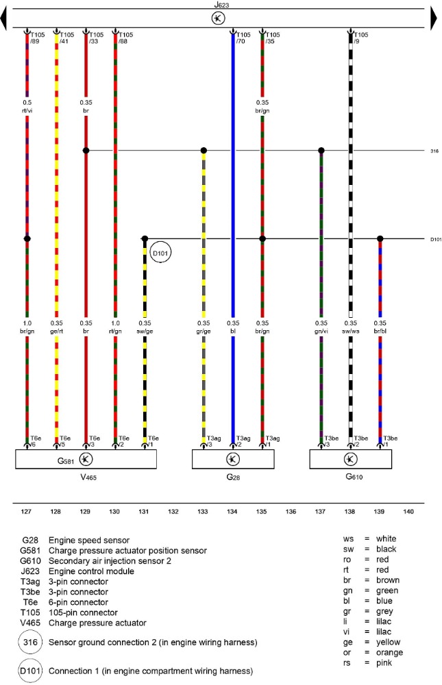

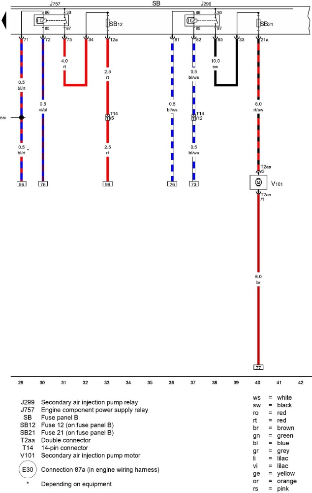

Looking for diagram for secondary air injection system, mainly 1 that shows ecm control wire. Anyone have access to 1?

I really hate VW wiring diagrams. :angry: :silly: These are all the relevant diagrams I could find:
