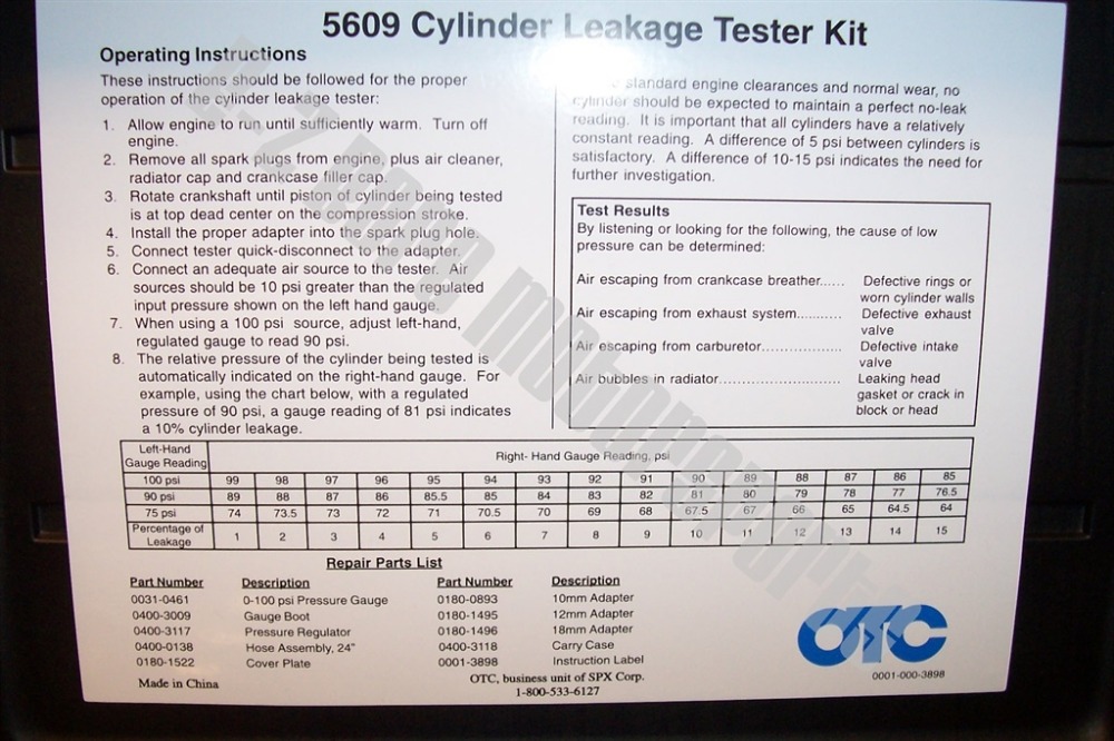

7 years 3 months ago #32345 by Carstuff
Replied by Carstuff on topic Re:Misfire from valve seal ?
I preset the leak down gauge and connected the hose and Im showing 40psi on both gauges seems like less than 1 percent leakage , however you could hear it from the crankcase.
7 years 3 months ago #32349 by simclardy
Replied by simclardy on topic Re:Misfire from valve seal ?
You preset the gauge to what psi? 100psi right? Don't read the difference between gauges but the difference from static to loaded on the down steam gauge.
If it went from 100 down to 40 that's a big leak. When you go to the other cylinders what do you get? 10-15% leak would be normal and it should be similar accross all postons

7 years 3 months ago #32350 by Carstuff
From the first video I preset it to 30psi before connecting hose to cylinder. Once i connected the hose both gauges dropped to about 15psi.
The other was about the same . You could still hear it from the oil cap. But only that one cylinder is misfiring.
7 years 3 months ago #32351 by simclardy
are you setting all the cylinders to top dead center when you perform the test? You have a 50% leak if it goes from 30 to 15. my set is a bit different. it has percentage on one side and psi on the first gauge. I have to set it to the max and then connect.

7 years 3 months ago #32352 by Carstuff
it's set at top dead center. From the box im told its 15 percent leakage. I only tested it at low pressure because someone sugguested it might be hiding the leakage at higher psi.

Regardless if i increase psi or preset the psi before connecting to cylinder you could hear air coming from oil cap. Even tho a standard compression test have close numbers across all cylinders

7 years 3 months ago #32371 by simclardy
Go by your chart, I'm not familiar with that set. What is the leak rate on the good cylinders?

no bubbles. its just coming from the oil cap and if you disconnect the air separator pcv you also hear it blowing into manifold. im not sure why the leak down is the same number on both gauge. im thinking about pulling the head big job on mid engine
